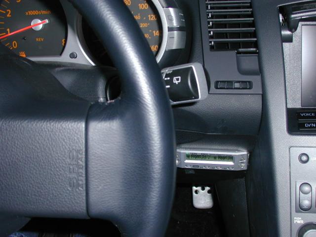

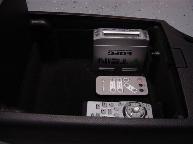

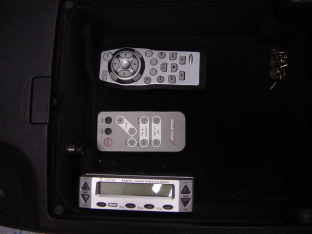

Thanks for all the info. I like the Tein Flex coil overs with EDFC. Does anyone have the EDFC, and if so:
1. How do you like it, and
2. Where did you put the control unit? (can it fit under the cover in the center console?)

Originally posted by 3rdpower
First, the TEIN Flex system made a nice improvement in the driving dynamics. I was able to easily hunker down on some turns where I tended to lose a lot of grip. The TEIN install was done by a local racing shop here in Seattle. The installation cost was roughly $250 (a steal considering the EDFC was a pain in the **** to install!). The feature / functionality of the EDFC is undeniable... it is a serious must if you are going to buy the flex system spend the extra for the EDFC! There's nothing like a nice smooth ride when you want and a serious corner cutter when you really want to get down.
https://my350z.com/forum/attachment....&postid=258623
https://my350z.com/forum/attachment....&postid=258624
https://my350z.com/forum/attachment....&postid=259283
https://my350z.com/forum/attachment....&postid=568605
