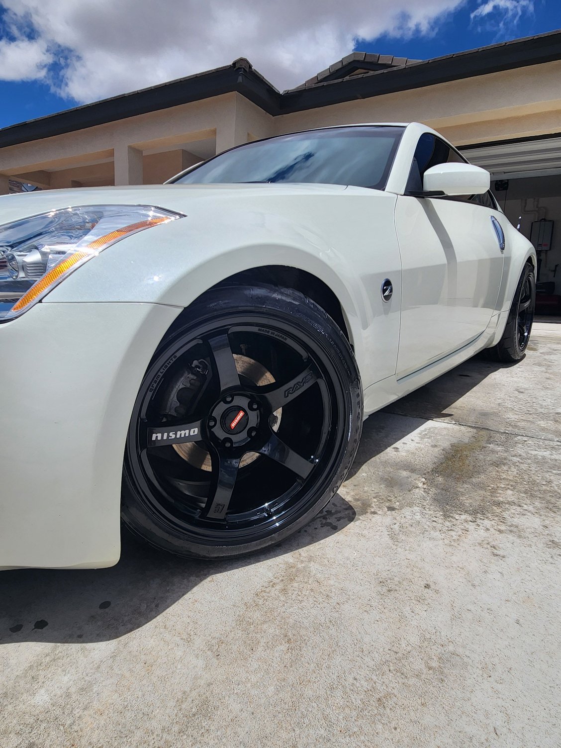

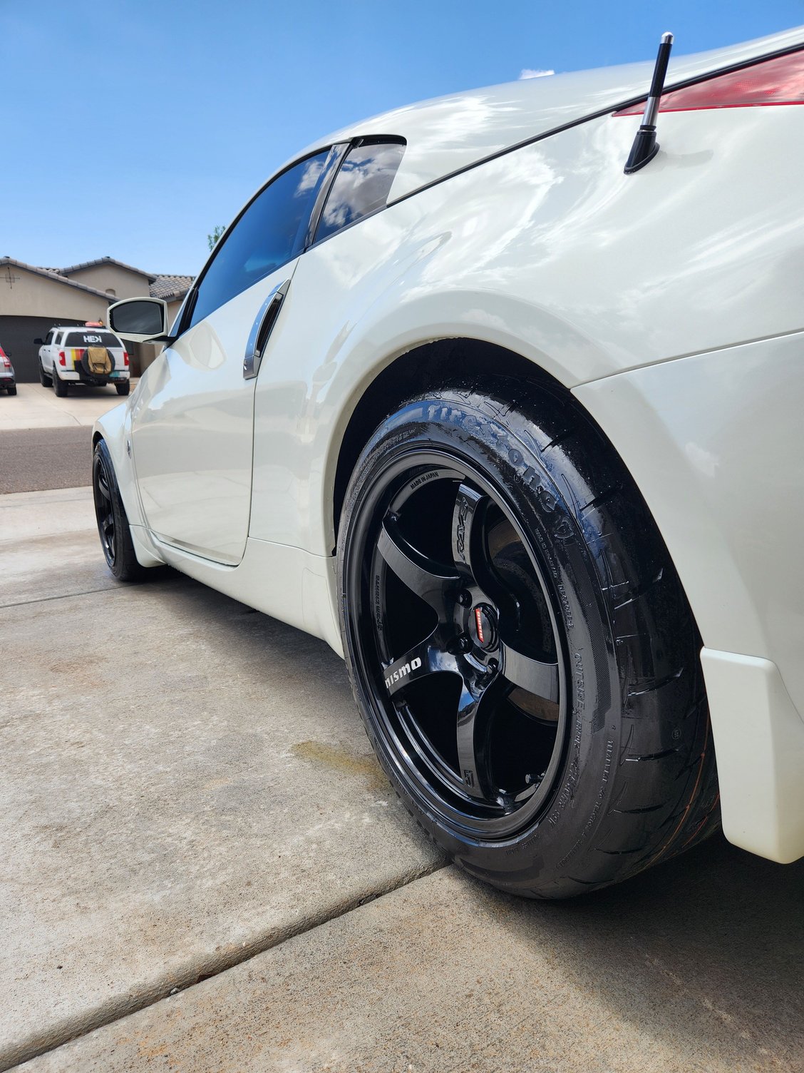

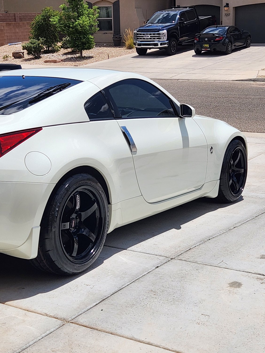

And this is what she looks like with new wheels/tires. There's a little more poke on fronts than I expected. Probably be good with 9.5 on fronts but I'm good with the look overall. Definitely have room to drop it but trying to avoid starting down that road. Thanks again for the feedback.
