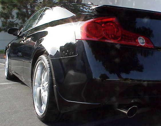

I Drive with the VDC in the "Off" Position When I'm Driving the Vehicule Harder Than Recomended.
And in The "On" Position When Driving Conditions and Visibility is Restricted.
Shifts still The same way (Smooth) Since Day One Back In Sept '03.
I Have Axis Mods:
Front: 20x9 (275/30R20)
Rear : 20x10 (285/30R20)
On my '04 G35.
