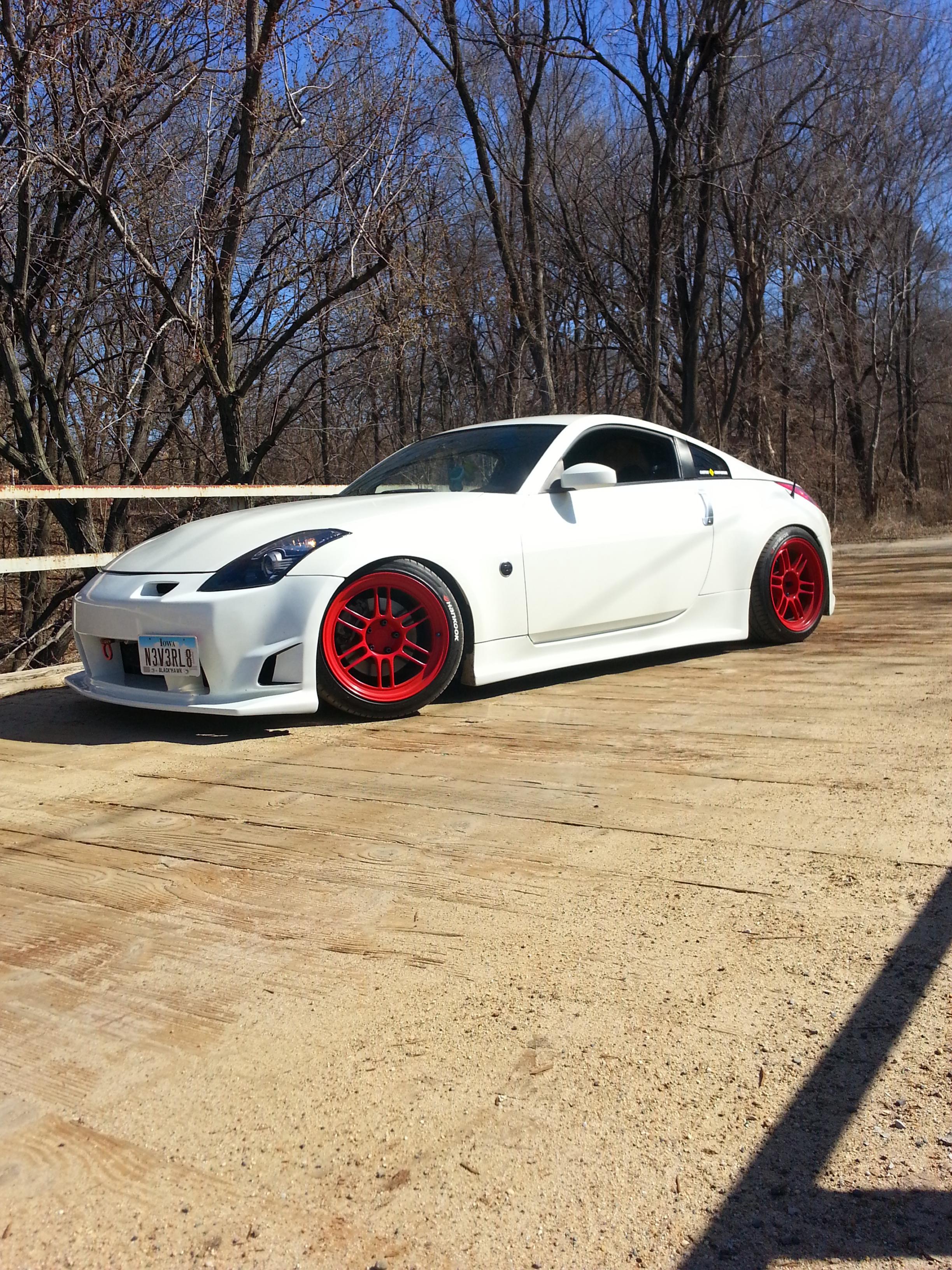

I ran 19x9.5 and 10.5 +0 on stock height with 255/35 F & 275/35 R and they cleared. THAT is aggressive(for stock height)
I also had Volk GTS 19x9.5 and 10.5 +17/18 respectively with 255/35 F & 275/35 R and I was lowered on Tanabe GF210s (1" and 1.75 with spring mount mod)
This is my car on 18x10.5 +15 square with 15 mm spacer in the rear (+0 corrected offset in the rear) now and there is plenty of room even on coilovers.
Your setup will be MODERATELY aggressive, but not pushing the limit especially at stock height.
