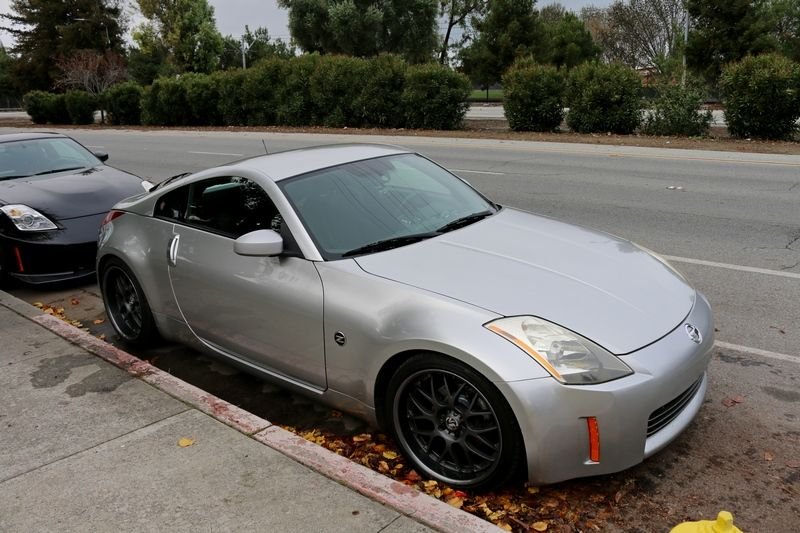

This is exactly that set up except for the double stagger 18 up front (Nismo combination but section widths exactly the same).
Most important to note that these are 18x9.5 +34 up front (with only a 5mm slip-on spacer making them +29mm effective). This has proven to be the best responding/handling setup between running them without a spacer at +34 and with a 15mm spacer making them +19.... horrid turn-in response. And running them at +19 rubbed on bumps. Bleah.
Rears are basic 19x10.5 +19 with the 265s.
Volk set-up 19x9.5 +19F / 19x10.5 +29R No spacers.
These are run with the proper 245/275 tire combination.
Will eventually be putting on my Z34N wheels (9.5/10.5) but those wear 255/285

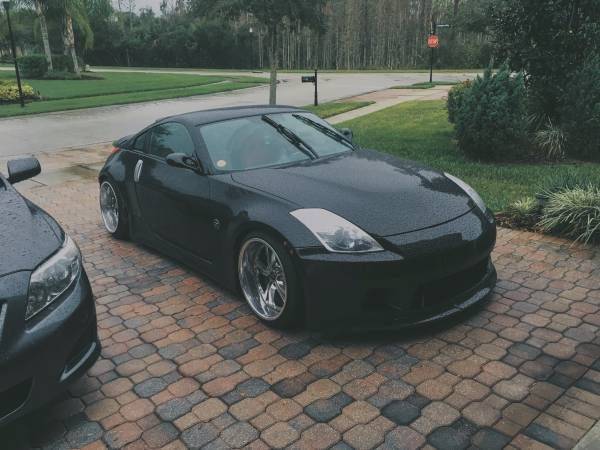

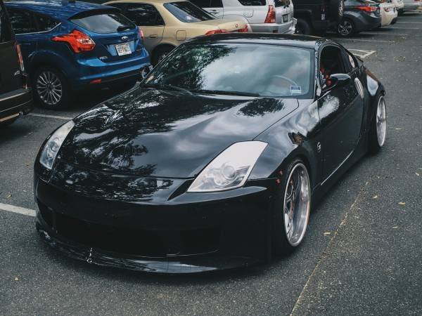

I have a very similar set up. 19x10.5 and 19x11.5 245/35 and 265/35
