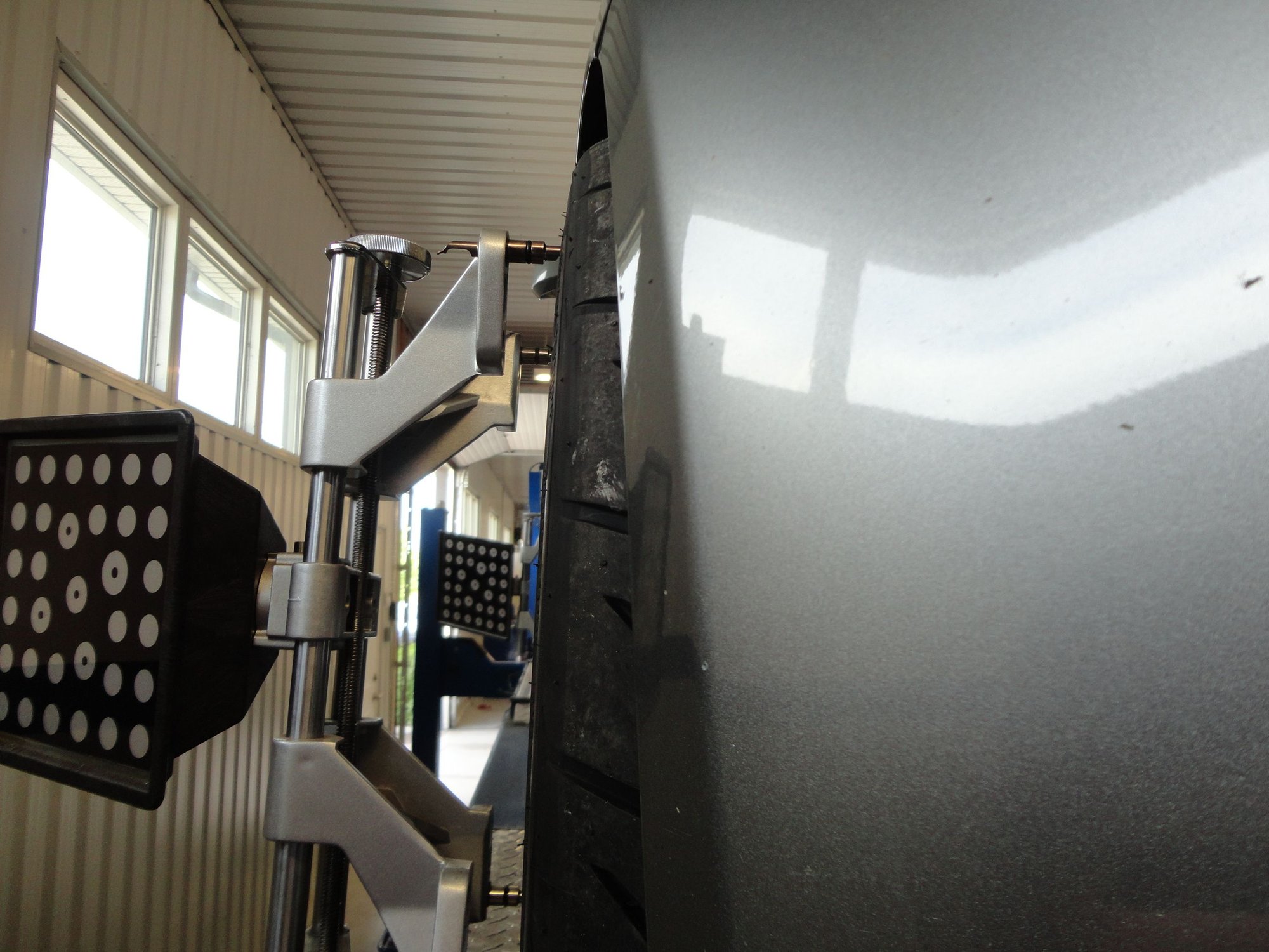

Finally... really busy right now and had some wheel stud and brake issues to tend to first. But anyway for those interested in tire/wheel fitment...
Enkei GTC01 10" x 18" 22mm offset - front and back
Bridgestone RE71r 275/35 18 square
S-Tune suspension
No fender roll
No wheel spacers
No rubbing
-2 camber front - w/Z1 FUCAs
-1.7 camber rear (OEM -no after market camber arms or toe bolts)
*For comparison I will post pictures w/19" wheels on when I get them back on
Fronts
Rears
Fender gap
And a little eye candy from the shop...
My tires made that picture...
The cars are still in winter storage...but it's June
