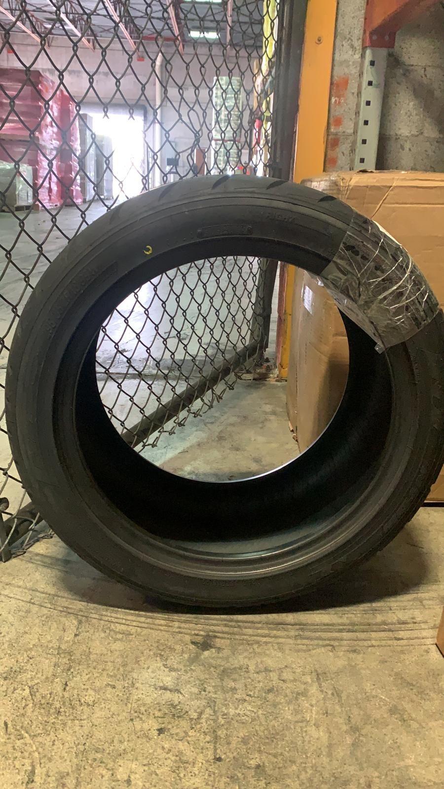

Anyone running 285/40/18 on an 11" wheel on the rear of their Z? Looking really hard all over for some pics but not finding. Worried if it'll be too thick. I currently have 295/35/18 Nitto NT05s but they rub too much even with rolled fenders due to the offset of my Cosmis XT-206r (11" +8mm)
Reason for going 285/40 instead of 275/40 is to account for the stretch an 11" wheel may give on the tire, don't want an aggressive stretch. The 295/35 sidewall is currently PERFECT for me, and I don't want to go much taller than that. I also have to run an unreasoanble amount of camber with the 295/35 (currently about -2.1) which is killing my tires way too fast. So I'm hoping the 285s tuck nicer under the wheel well so I can straighten out the camber a bit to a more reasonable amount.
This is a sidewall photo but want to see one mounted to get a proper opinion.
