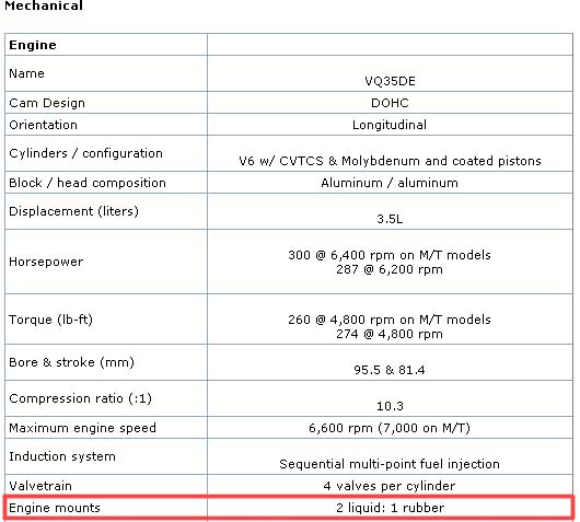

Old Jan 27, 2006 | 10:44 PM
mutock's Avatar
mutock
Joined: Nov 2005
Posts: 114
From: SF Bay Area
This is right from Nissan for '03 thru '06.....
Old Jan 28, 2006 | 04:41 AM
zzz350's Avatar
zzz350
Posts: 1,255
From: Kalifornia
well that settles that. I guess the lesson is, don't believe every opinion you read on the internet. Good Job, Mootock
