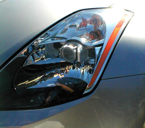

Definately sounds like he is trying to pass off pseudo-HID halogen bulbs as the real thing. The HID lights on the enthusiast model are the real thing. They look awesome. The projector lens in the below photo is actually several inches in front of the HID lamp...which is too damn bright for me to look at directly...they look unlike any other headlights I have ever seen...very cool.

As far as how they look in use to the driver, they are awesome. Not very blue, except when you first turn them on...then they transition to a pretty pure white after a minute. They spread the most even field of light I have seen in a headlight though...across a very wide angle. Not much in the way of hot spots or drop outs anywhere in their range.
