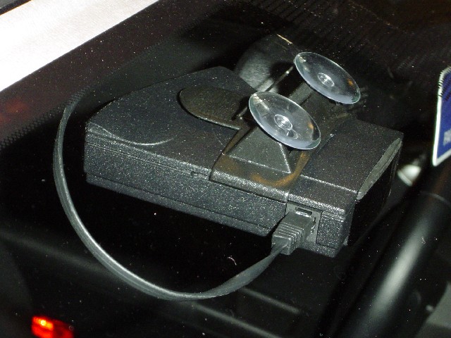

Outside view of power lead exiting V1 and being tucked behind the headliner:

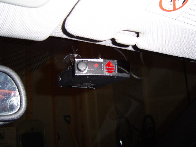

Driver's side internal view of V1 mounting:

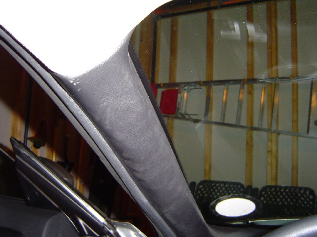

Driver's side A-pillar. Notice no visible wires, as the power line runs down the inside:

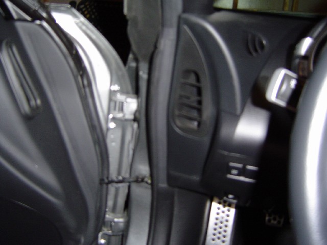

Last one (sorry for the blurry focus, but it was getting late.) This is the lower part of the driver's side dash assembly. The power lead runs behind this and down to the fusebox.
I hope these pictures helped.

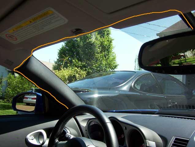

I'm confused what wraparound you are talking about with the wiring. I crossed mine over to the door side of the a pillar at the headliner. I initially started to do it at the dash, but that may be where you were having the problem.
Old Jun 6, 2003 | 06:04 PM
GaryM05's Avatar
GaryM05
Posts: 1,258
From: Golden, CO
The wraparound I'm referring to is where you have the orange line at the top of the A-pillar, right between the black plastic and the grayish headliner. I have curtain airbags, so there was no way I was going to run it through the headliner up there, and I didn't like the way that it looked passing around the outside. Now, it passes from the headliner/windshield/A-pillar joint down through the inside of the A-pillar to enter the fusebox through the dash panel. There are no visible wires at all (except for where it plugs into the V1.)
