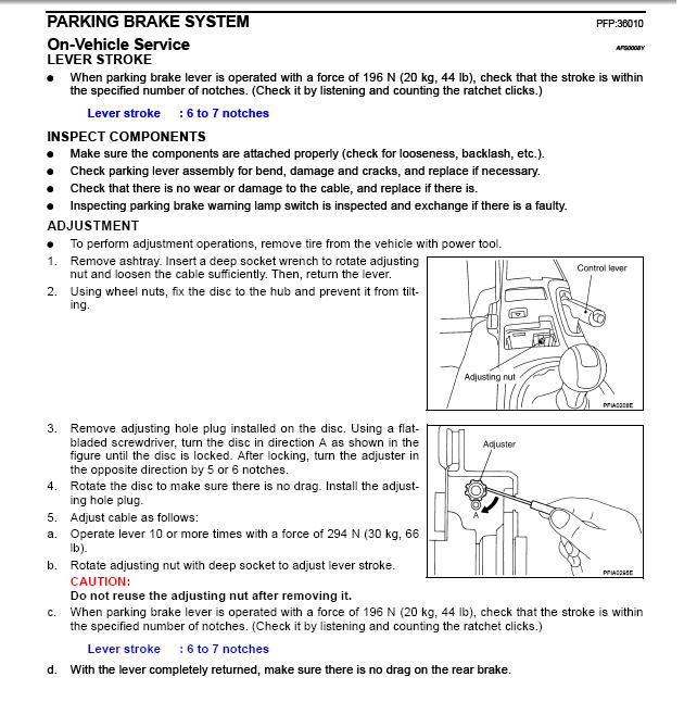

oh man wow.......glad there was no damage, but yeah, you need to leave the car in gear...always!!
but the parking brake can be adjusted/tightened.......you have to pick up the coin holder and look down in there and tighten the nut on the threaded screws....
check the pdf factory service manuals....it has step by step how to do this..
-J

here ya go..

Yea i'll be the first to admit thats mybad, i had to take my gf home real quick out of the house and i usually leave our cars in gear but i must have forgot in my hurry
