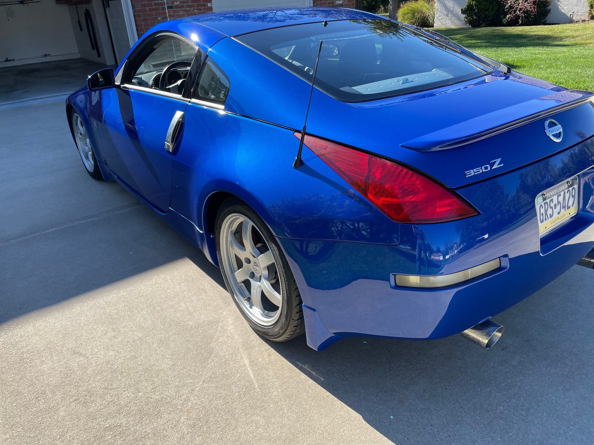

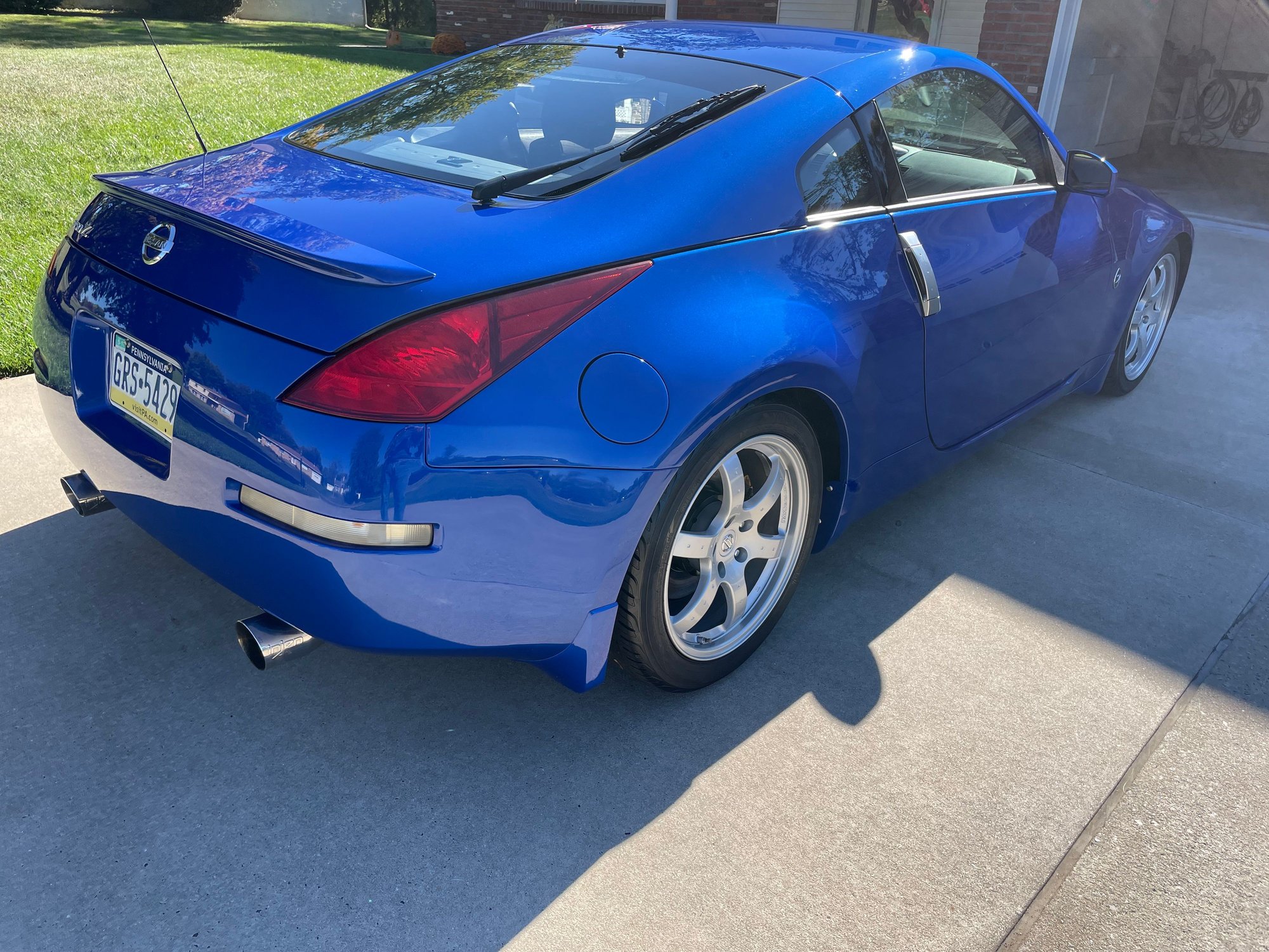

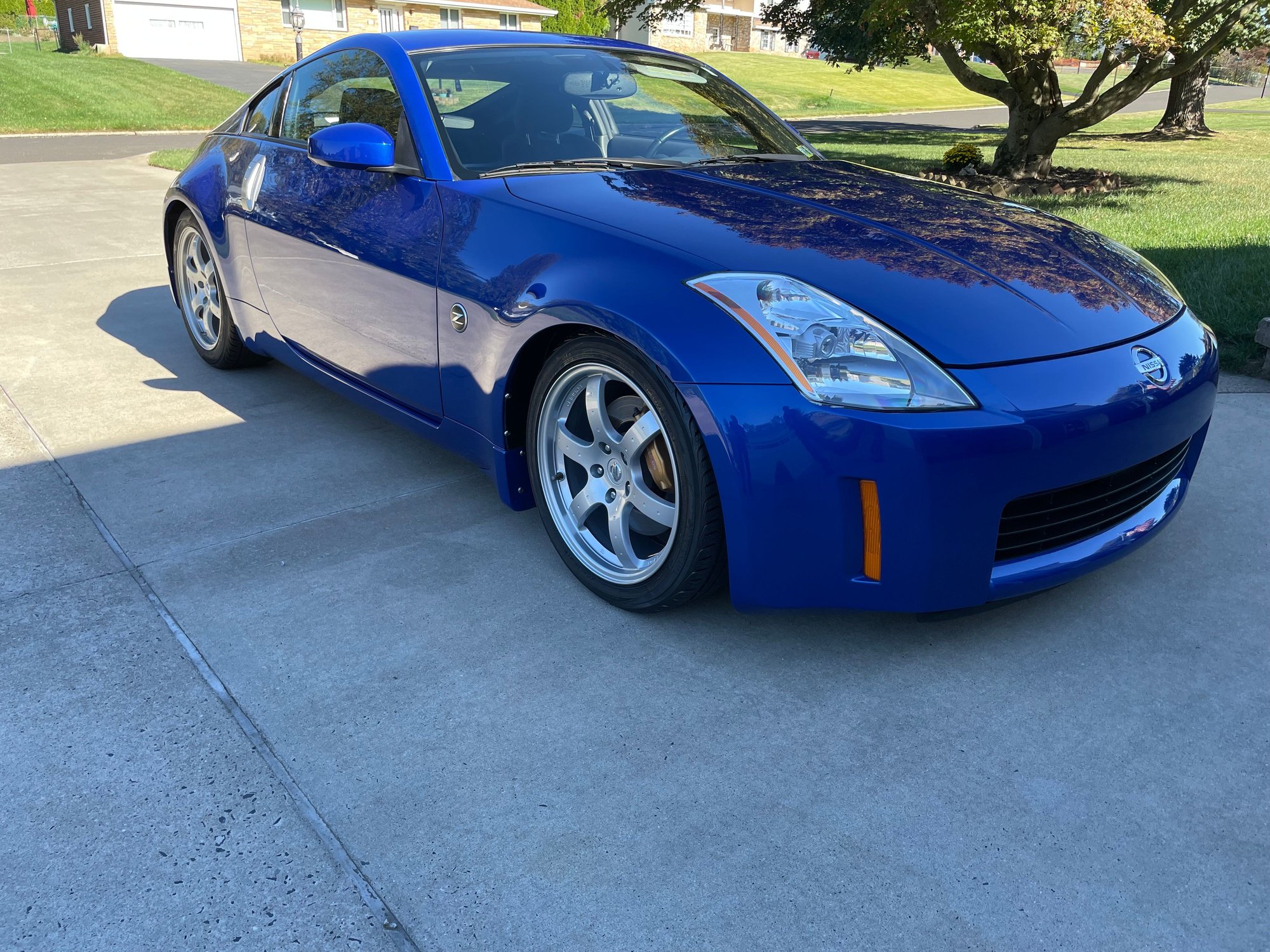

Default Just back from repaint.
Just back from paint two weeks ago.
I was having a problem with an intermittent P0300 random misfire. Replaced the battery ground, no change. Replaced the sub-harness to #1 & #3 coils on the passenger side. Problem is gone. Put about 15 miles over a 40 minute drive and car ran smoothly with no issues.

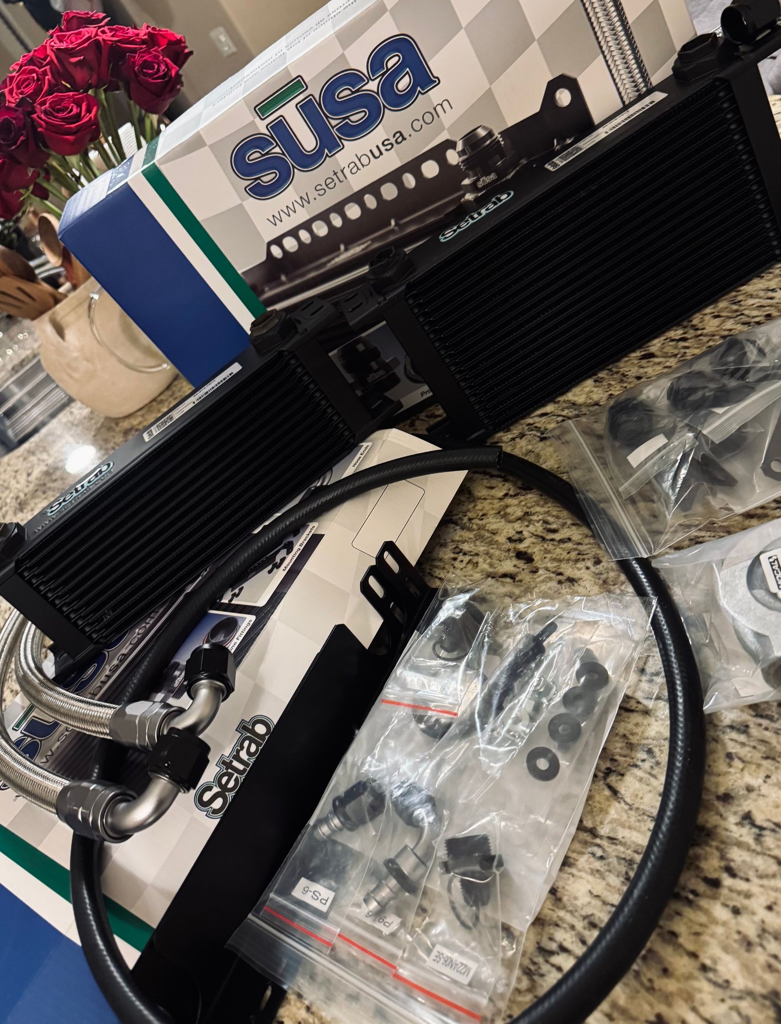

oil coolers came in.
