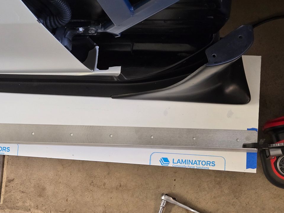

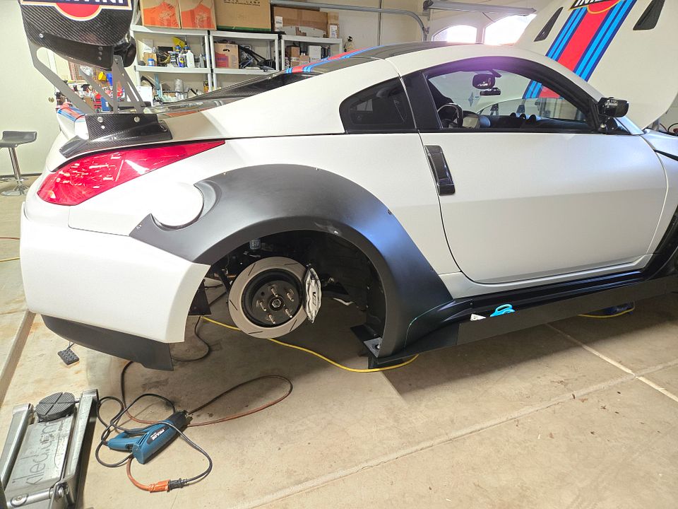

-tackled some more wrap on a fe more panels.
Still need to redo pillars and hatch, it has aged heavily over the years while waiting and building, rest of this wrap roll is way brighter from no uv exposure yet.
-Finished my side splitters
-Aluminum end plates (cad/water jet cut, powder coated) for side and front splitter.
​​​​​​Side splitters 1/4" alumalite, satin black wrap, bolted to skirts and flares w fender washers and t nuts, used all factory skirt hardware under the body so these things don't budge, absolutely rigid and solid.
Proud of the quality outcome. 👌
