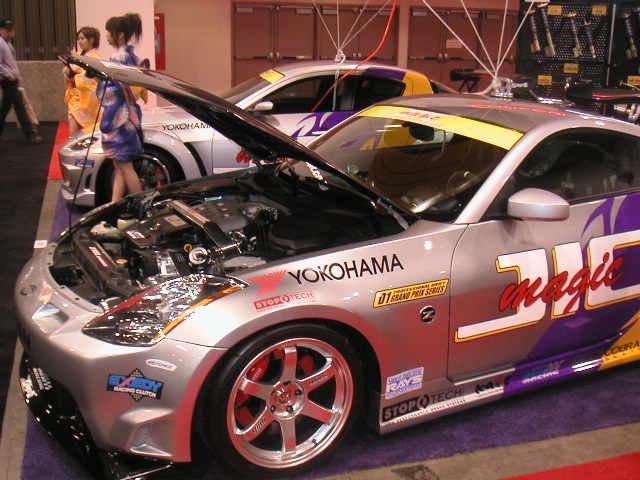

correction....i haven't seen the tein 350z yet, i mixed it up with the JIC car from sema....btw, anyone know it the JIC car is a track car or just for show? i ask cause i see a supercharger in this pic:
