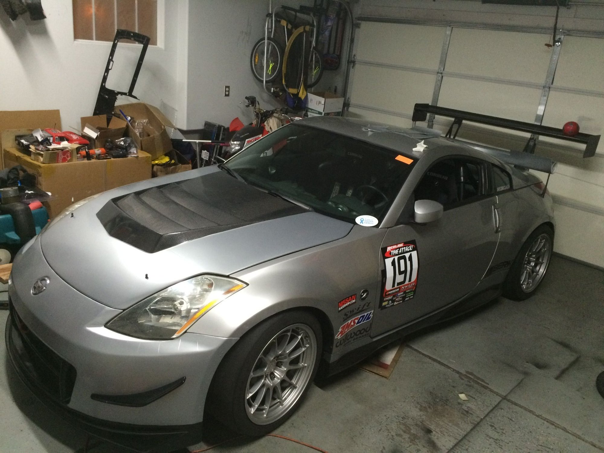

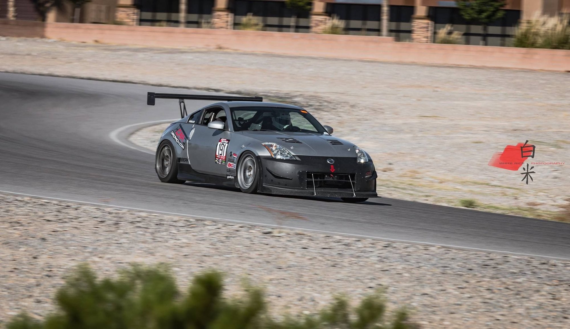

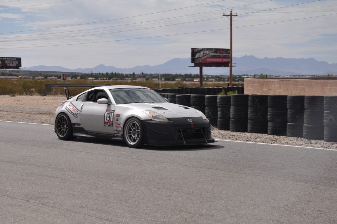

terrasmak, can you post a picture of that set up? with the 10.5s and that amount of camber? I take it you trailer your car to-and-from the track? I'm doing maybe 100 miles to and from the track (depending on which track) along with 4-5 20-minute sessions. other than that car does not get DD'd. Think i'll wear em out with just that many miles in a year? For this next event, I have a friend who I will see can let me use his 9.5 square and i'll swap after a session to see how much better it feels. If its mildly better i'll stick with 10.5s but if i notice its a huge difference I may go 9.5 square and just get extended lugs and put spacers on

I daily drove the car with that much camber for a year, 2 of my common track were 230 miles away and I drove to them. The car has only been on a trailer twice, cause it broke.
