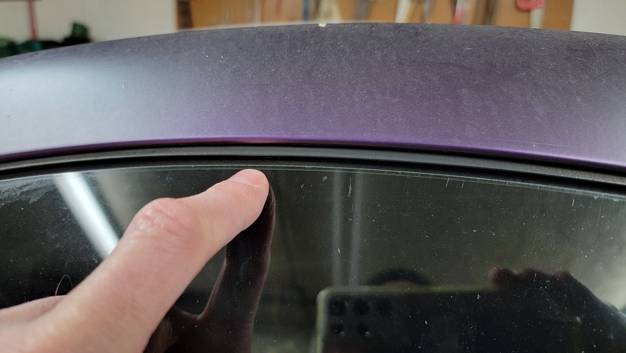

OK, I did the reset procedure and same issue - a small gap at the top, even though the window is dropping/raising slightly as the door is open and closed. This is before putting the card back on. Below are pics of driver side with gap and passenger side with no gap. When I put the glass in, I pulled it up as far as I could before tightening the three bolts. I am thinking about doing the opposite now, and letting the glass sit naturally before tightening the bolts.
I'll look into that camber angle idea.

The track channel guide piece that fell out of the front glass track shouldn't impact the window limits. I think the issue you're experiencing might be because of how you positioned the glass before tightening the bolts. Start with the glass resting on the regulator's seats/brackets, and then make small adjustments from there. When I adjusted my window glass, I primarily focused on moving the glass forward and aft in the door (Left or Right when looking at the bolts). This is important for ensuring good contact with the door frame seal at the B and A pillars to prevent leaks and wind noise. Once that adjustment is done, you may need to hold the hidden "reset" button on the motor to calibrate the travel limitations. My best guess right now is that there's not enough preload or tension on the regulator cable, causing the window to sag after the motor hit's the calibrated closed (rolled up) position. What's the state of your window motors? Are they aftermarket? Original? Rebuilt?
How you do the reset procedure is important. This needs to be done with the door closed, and only the 1st stage of the window switch (manual mode) can be used during the calibration. If you accidentally push to the second stage of the switch (auto mode) during calibration, then you will have to restart the procedure.
Check out this video, FFWD to 6:45 for the reset procedure.
The only other things I can think of to check are making sure your regulator is fully bolted/secured to the inner door panel. Sometimes the bolts/nuts can get loose. If the window motor or regulator are worn out or damaged, you might have sagging issues. Have you pulled out the glass and regulator assembly for inspection before?

You're right Icer. The three bolts securing the glass to the tracks were not tight enough, allowing movement of the glass. So instead of the glass being pulled all the way up, it was really mostly just sitting on the regulator brackets. With my wife's help, we moved the glass higher and secured the bolts, and did the reset procedure. I have a decent seal now, although I think the rear of the glass is a little too high compared to the front. Maybe that's what you meant by camber. I may adjust that later. Thanks for your help!
