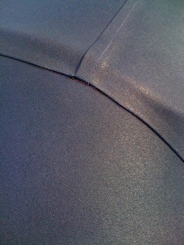

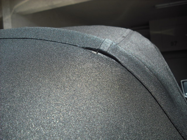

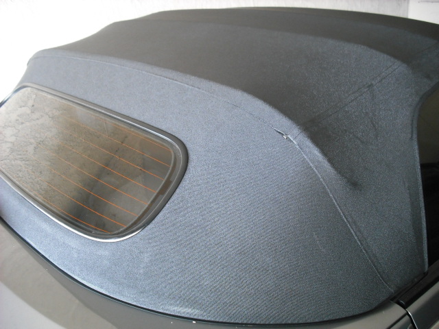

my cars a '05 roadster gt, im absolutely in love with it!. im noticing a tear towards the back of the dome on the stiching (SEE PICTURES). first roadster iv owned and im trying to figure out a way to stop it from getting worse. seems like the more i drop the top the bigger it gets, its still pretty well seald no water gets in. i was thinking of stiching it tight with fishing line???? any ideas???

August of 2006 - I first identified this exact same problem on the roadster forum - link below, scroll down for the pics which are nearly identical to yours. Back then, many of us were getting our tops replaced under warranty, but many were encountering major dealer denials.
Unfortunately, the factory replacement was the same design as the problem top. So far though, it's been almost 4 years now, and my replacement has held up fine. My car sits in a garage when not driven, though, so the the story may be different for guys who park theirs outside.
To the point of your question - Repair or stitch reinforcement would require top removal for machine stitching (obviously), or stopping it in mid-fold/retract to glue (recommend) and reinforce stitch by hand. Not aware of anyone having done it on this forum, but I think it's definitely worth the try before springing for a whole new top. Left unattended, that seam definitely will eventually separate.

thats the heat seal tearing, i have the same problem. It gets a little bigger over time, and there is nothing you can do about it. The top will still work fine, and will be waterproof though. Not that big of a deal. Unless it goes all the way across the top. If it stays small id say dont worry about it.
