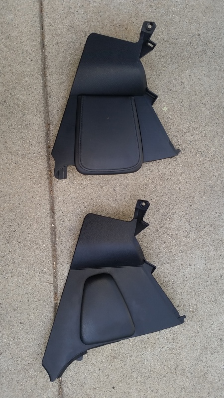

Pic showing difference between 03-05 and 06+ knee pad panels
Newer one is up top

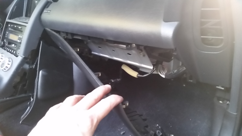

Pic showing how you pull lower dash panel to access the screw holding in the panel

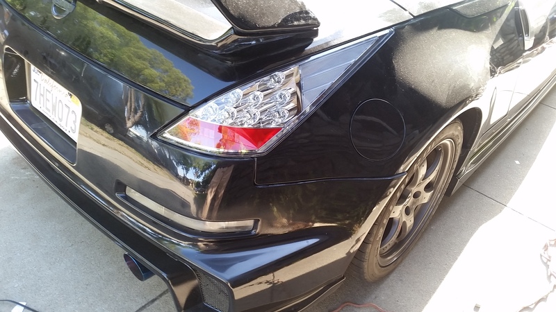

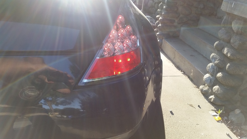

Installation of JDM tail lights:
I opened the trunk and popped how to the bolt covers, 3 on each side, and removed the bolts with a 10 millimeter socket. I pulled the light away from the car and discovered that the nubs that locate the light we're broken off inside the receptacles in the car. I had to do a bit of minor surgery to extract them out of the receptacles so that the nubs on the new tail lights would fit in there. after fiddling around extracting the nubs I discovered that the connector had ridges on it that was opposite of the connector on the tail lights. I only choice appeared to be grinding off the ridges which I did with a soldering iron and a sharp knife. the soldering iron melted the plastic and made it a little bit brittle so that I was able to scrape it off with a knife. Then the connectors hooked up perfectly. I tested the lights to make sure they worked before I bolted them to the car and they did work great. installation was the reverse of removal.
here is the result:
Lights on in daylight:

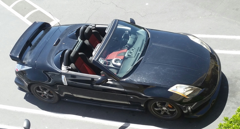

A different view of the car:
Radio brackets came in. Still waiting for the 08 CD6 radio on its way. Im not sure how that will help the shift console fit but Ill find out.
I still need to open the tonneau cover and hook up the two connectors and the arms of the top. Im just enjoying the top down too much to risk it.

Hey that shot is money deus!!
Looks sick from that angle. I like that you're sticking with OEM parts to stay with the whole conversion as opposed to aftermarket parts.
I'm jealous. I wish I could keep my top down all the time this time of year. I just really don't feel like vacuuming out a 2 inch layer of yellow pine tree pollen every couple days.

Thanks guys. I was on a second level office building and happened to glance at the car and thought it looked good. You can look in the car and see the red Nismo seats looking sharp.
I feel fortunate to have found all original OEM parts for the car. The wing had to be a replica since the original ABS plastic wing could not be modified easily to fit the trunk. Im going to look at some OEM Nismo rims locally. Some have damage and the seller wants too much for them. I figure market rate is about $1800 in nice condition with decent tires. I think he wants about $1200 and two of the wheels are pretty damaged. Ill look at them and talk to some wheel repair places and see what they think.
