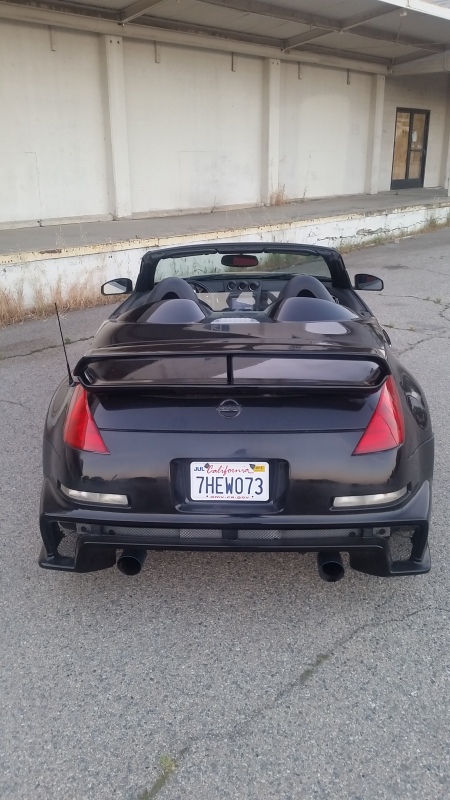

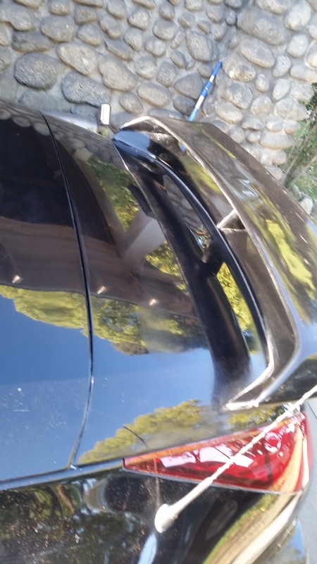

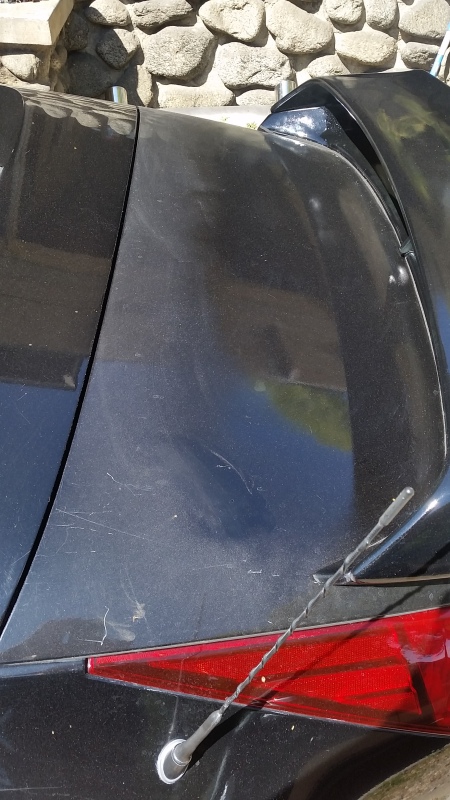

Pic of trunk with holes from V1 spoiler filled and paint blended before wet sanding:
After wet sanding:
Its not a great job but its ok - better than it was with holes in the trunk!. At some point ill do a complete respray of entire car.
Another pic:
Its interesting how the car looks different depends on viewing angle and lighting. Its like that episode of Seinfeld where the girl he was dating looked good or bad depending on the lighting. The car never looks bad...just better in certain lighting.

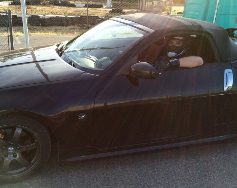

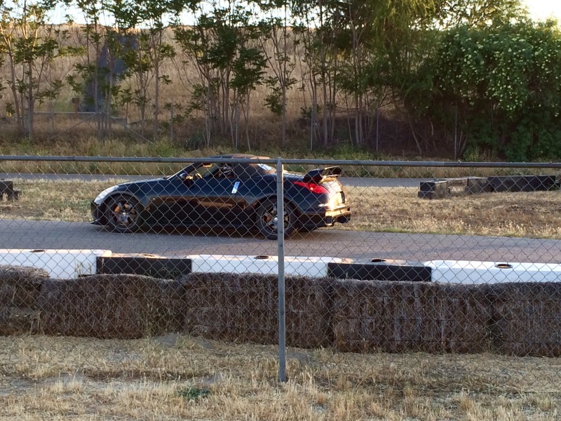

I decided to track the car at Adams Racetrack in Riverside. To prep the car, I topped off the oil (2 qts!!, I need to change it), removed the ill-fitting shift bezel (console) so I could manually shift the car, put in half a tank of gas and put in 43 lbs of air in front tires and 38 in rear tires.
At Adams Racetrack, the course is about a 50 second course, plus or minus 4 seconds. The very fast guys run 44-45 seconds and very slow run in mid to high 50s. Most cars are 47-54 seconds.
I have raced SCCA Solo2, road raced at Alfa Romeo Ownders Club events, and raced at a high speed time trial called Lone Pine Time Trials, all since the mid 1980s (). I have not raced in a few years but I was hoping for a sub-50 second time. All my times were between 52.5 and 53.5 seconds.
Here's my impression of the car on the track:
Brakes - Brembos performed beautifally...no fade, responsive, easy to modulate using left foot braking.
Handling - very predicable and easy to control at the limits. Adhesion lacked due to poor tires. Slight oversteer at speed although understeer in tight low speed turns. The car didnt seem to lean much. Better anti-sway bars may help dial in handling. I kept the VDC on.
Acceleration - Very good when the tires hooked up. Too much slipping. The yellow slip light was on most of the time.
Nismo seats did decent job holding me in place. A harness or seat belt lock would be very good to have. Headrest pushed my head forward with helmet on.
Solution for improvements - Paddle shift is pretty much requried to drive an automatic on the track. I lost much time fiddling with the gears. A transgo shift kit would speed up the vague shifting. Good competition tires are a must.
It was good to get back in the saddle on the track. Ive always loved racing. By the way, last week, a fairly modded 350z ran a 49+ and after my runs, a 2015 370Z Nismo ran 51-52+.
Here is a grainy iCrap video and some pics:

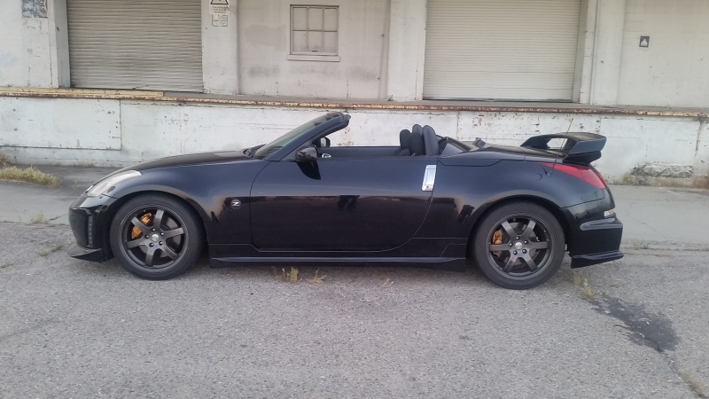

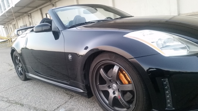

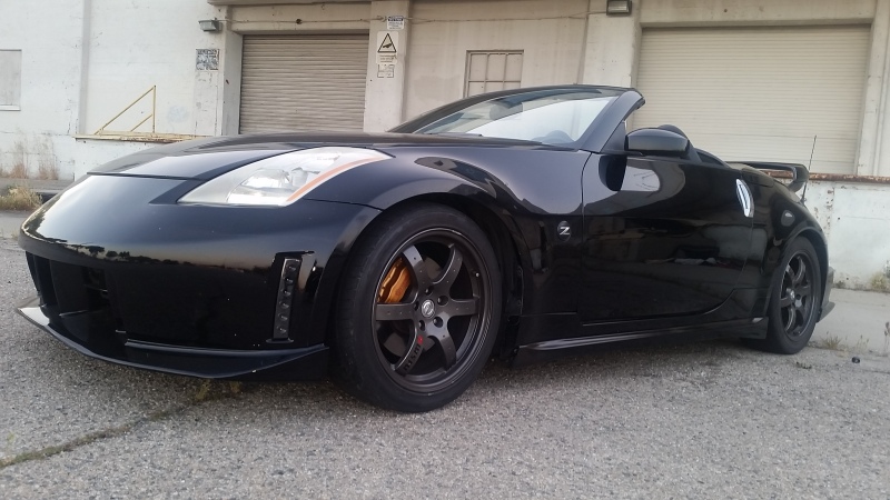

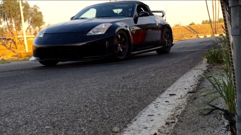

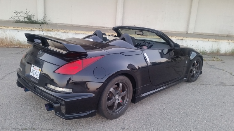

Well...........anyone want some good news?

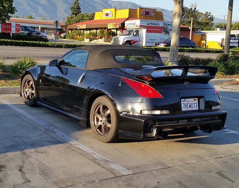

After months of fretting, I took a serious crack at lowering the convertible top. And.......here is the result................
Looks beautiful. I think that was a good call with the wing given the other styling options you went with.
Out of curiosity, how did you get the top down?

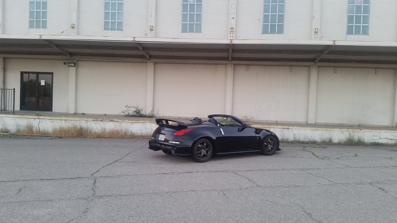

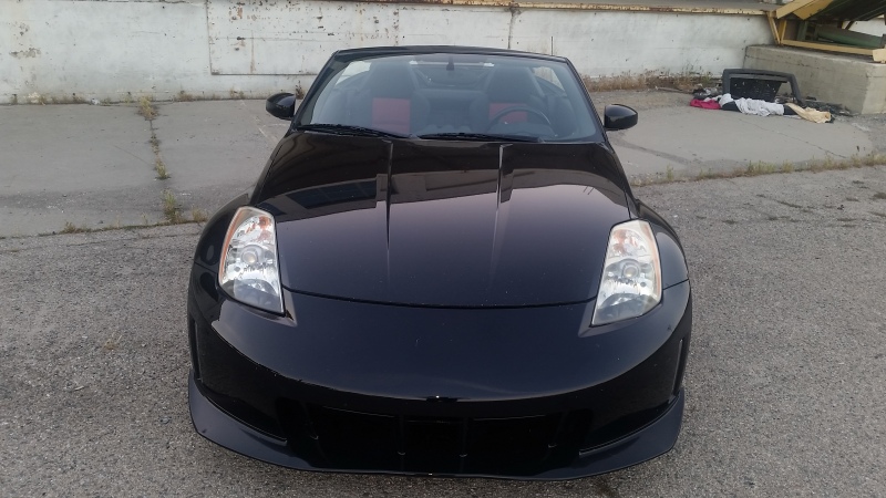

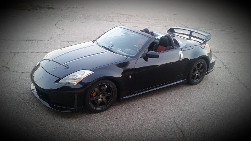

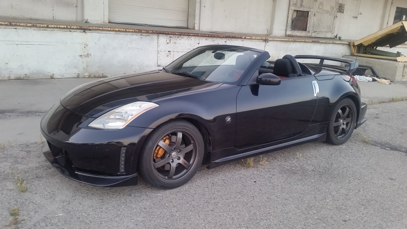

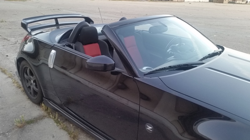

Thanks. I thought you (or somebody) would never ask.
Reminder: I manually raised the top by disconnecting the two grey connectors and the two arms. Since then, I connected the white control box under the seat.
Procedure: I started by trying to raise the rear of the top manually, with a helper. Neither of us could budge the top. Then I got in the car and turned ignition to on with foot on brake and pushed the top down button. He said he could hear motors working but the top wasnt doing much (possibly due to disconnected bits). I told him to raise the rear of the top which went up easily. Then he raised the touneau cover which also went up easily. I told him to "help" the top into the storage area which also went fairly easily. Then the cover closed and locked. A bit of cleaning and the job was done.
I still need to reconnect the bits but thats how I did it.
Afterwards I had to do a quick photoshoot for you guys and then cruise it around.
