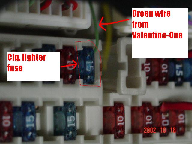

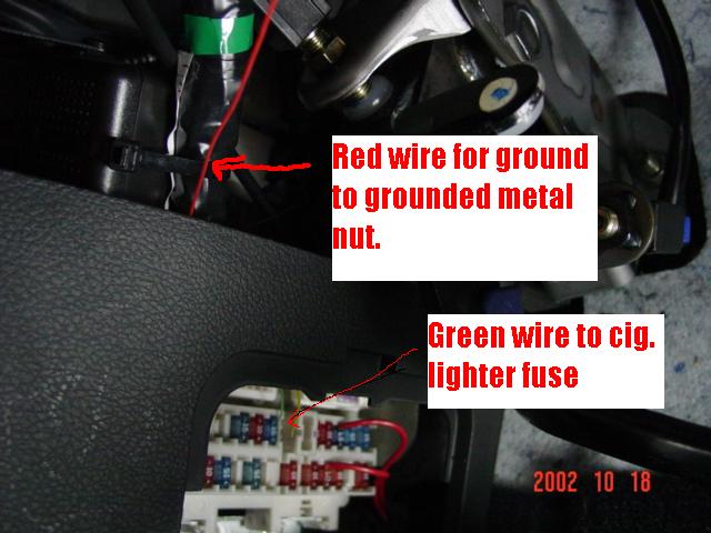

You are correct xsmallpaulx. Green is the hot wire and the red is the ground. The yellow and brown wires you don't need unless you are wiring in the small V-1 Remote display:
Old Feb 11, 2005 | 10:09 PM
Dr Bonz's Avatar
Dr Bonz
Charter Member #19
Posts: 6,490
From: Zainoland
Old Feb 11, 2005 | 10:10 PM
Dr Bonz's Avatar
Dr Bonz
Charter Member #19
Posts: 6,490
From: Zainoland
Believe it or not, this was my VERY FIRST mod on the car. Notice the date on the pic. I had just picked up the car on 9/24/02.
