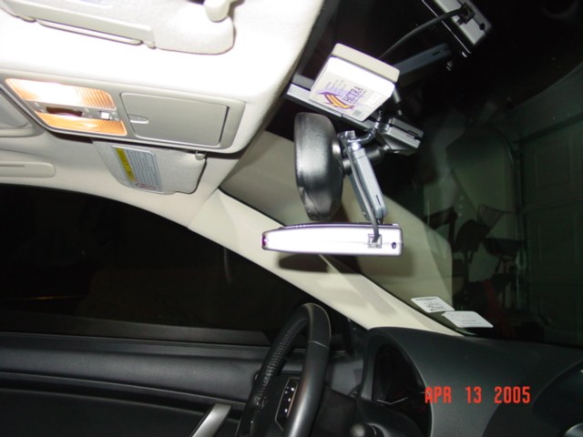

I just did mine, and that diagram is wrong. I had to reverse the ground and 12V for my 8500 X50 blue to power on. Other than that it was easy, took about 1/2 hour.
I tapped into the homelink mirror, black is ground and black/red is 12V battery.

Old Aug 27, 2005 | 02:15 PM
shooter82's Avatar
shooter82
Posts: 65
From: houston
i did the same thing.......i found it much easier to tap into the mirror wires......

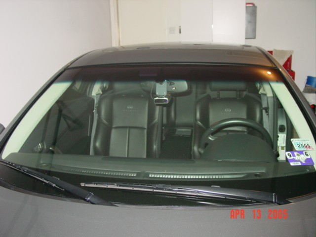

heres how the local shop set it up for me cost like $65 with the wire

Does having it under the mirror like that obstuct the view for anyone?
Old Sep 4, 2005 | 04:21 PM
2003z's Avatar
2003z
Posts: 4,959
From: Atlanta
it didn't obstruct my view, but it wasn't easy refocusing between the road ahead and the radar detector. Overall though, its still the best place to mount it.
