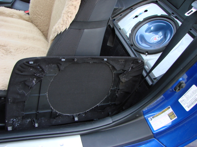

Default sub in the hole pics
Originally Posted by lololepro
Any pics of your install racenu?
heres my attempt at attaching the photos, I'll have to do it a few times as I think the files are too big. This is by all means not a pro install, I have the amp tie wrapped in the hole just so it doesn't slide around. As someone else mentioned be very carefull drilling and screwing and I wouldn't recommend screwing or drilling a blind hole.

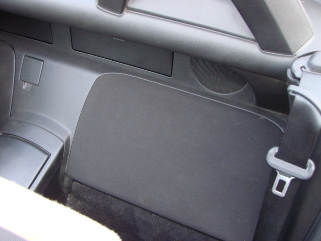

Default 3rd photo
heres pic number 3
