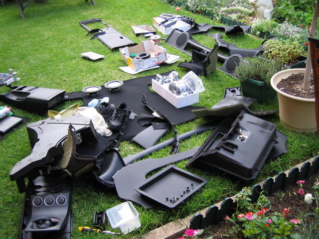

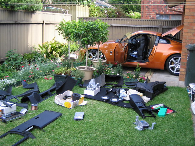

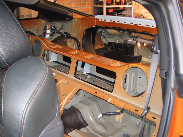

it should look something like this.
My car, my back garden.
Attached Thumbnails How to Remove-photos-27-01-2006-135.jpg   How to Remove-photos-27-01-2006-136.jpg   How to Remove-photos-27-01-2006-139.jpg
Good on ya!
Hope it all goes back together and you're not left with some extra screws
Are you dynomatting the whole car.. or ??
wow!!! got any more photos of the cubby-spaces / back of the car? I'm looking for just about everything you can give me from any angle behind the seats, both in front and behind the strut bar. I'm going to be doing the same thing this winter, but want to plan it out a bit before I have the car in a similar state of disarray
edit: also, did you use the shop manual to get to this level of disassembly or some other source?
