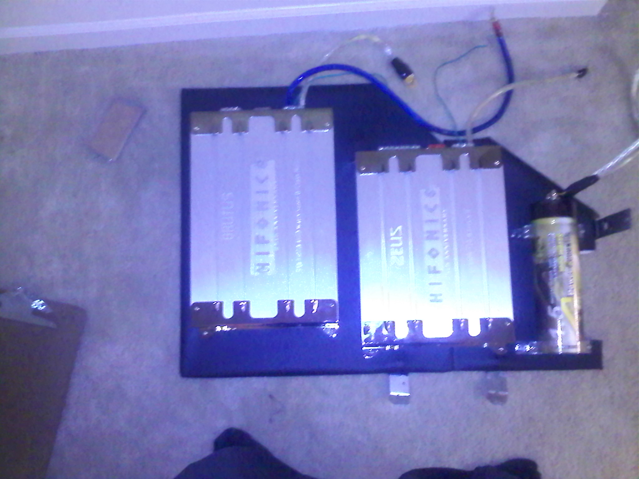

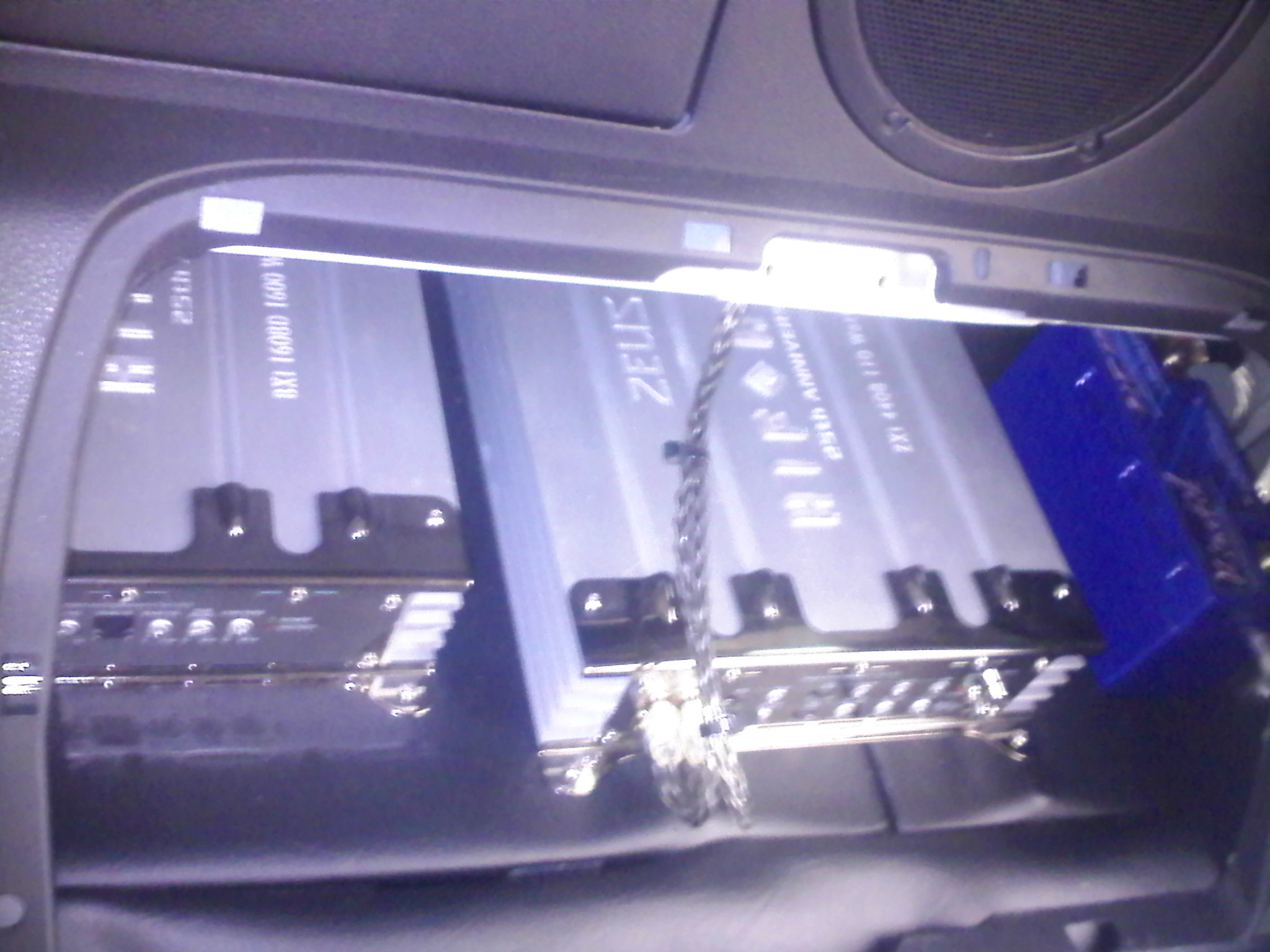

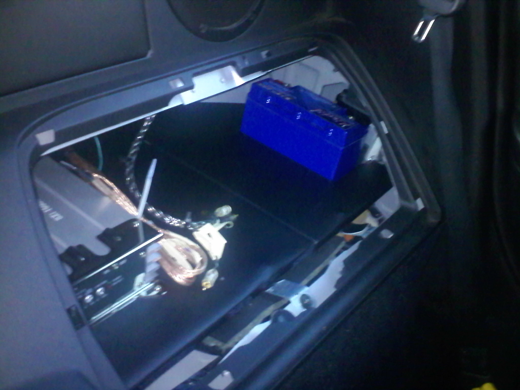

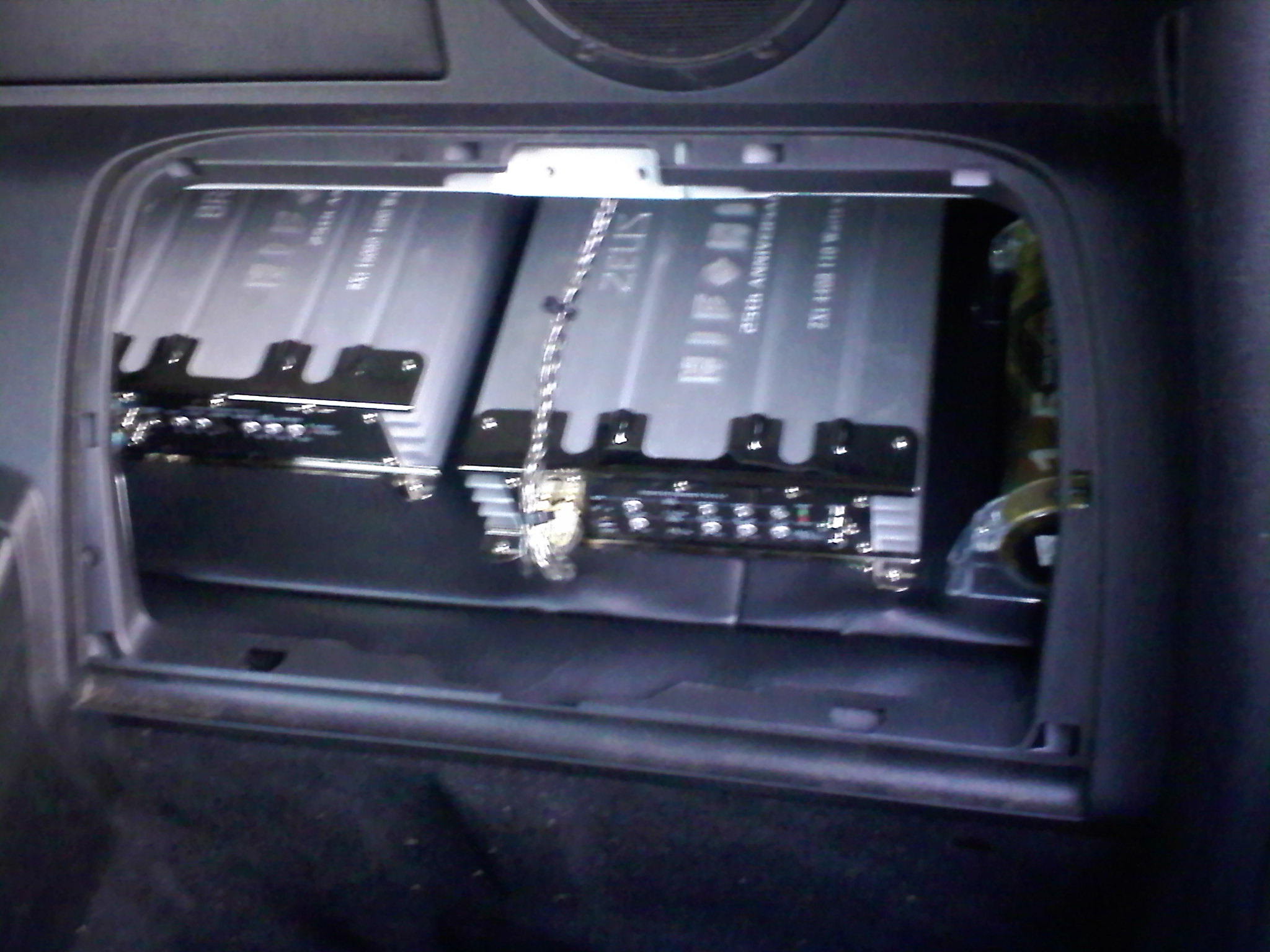

The way I designed my rack, I had about 18 inches of depth going back. I didnt use the straps at the back (this cleared alot of space). I chose this position because I wanted to be able to tune the amps. Here are some pics.

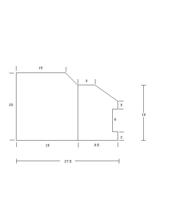

I just took a look at my original blueprint and realized it was 20 inches back at the deepest point. The 18 inches was the width of one of the two pieces I made. At some points its about 27.5 inches wide. The pics will explain more.
Its enough room in there to fit almost any amp. I currently have two amps and a 2nd battery that fit very nicely (the cap in the other pics couldn't support my system).
I will be doing a complete write up on my system build and how to make this type of amp rack when I have time and stop being lazy.
