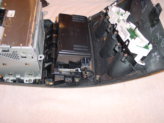

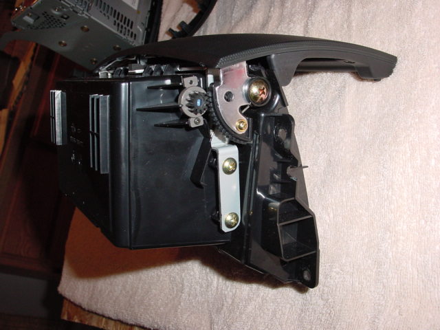

Those of you that put your screens in the NAV compartment I have a question. Did you start with a nav screen there already and swapped it our for the new screen? Or is your car without the nav option and you put the screen in the non-nav compartment?
I am asking because I have a 2004 non-nav roadster. After reading numerous posts I decided to install a Xenarc Touch screen. I bought it, took my dash apart in prepartion of installing the screen. The non-nav compartment is all one unit with the door. There is no place to mount the screen. I am assuming this is because Nissan changed the non-nav compartment to the non-motorized door for the 2004 models.
So is there anybody out there who has installed the new screen in a non-nav car that I can talk with? I am in need of some help. My first thoughts are to by the non-nav compartment for a 2003 Z. Anybody know the part numbers for that?

Originally posted by CopperZ
i just put in my screen today. It was a Non-nav. Its a 2003 T. I dont know about the 2004 model, but when you take out the whole assembly (radio, nav compartment, 3 gages) you should be able to remove that empty box. there are 4 screws that hold it in. Where do you live i can help you puit it in. I got the Lilliput touchscreen and i love it. its amazing..... I will post some pic's latter.
I am in Sacramento, CA. I have the non-nav compartment out. But after reading many threads I have come to the conclusion that Nissan changed the design of the non-nav compartment from the 2003 to 2004 models. It is all one piece after taking the four screws out. Here are two pictures demonstrating what I am talking about. I don't see how to take apart the compartment so that I can mount the screen. The fold up door is integrated into the box. I hope I am being stupid and missing the obvious.

Pic 2

Originally posted by zpylot
Pic 4
I've been following the threads also. Getting ready to add a screen to my '03. The nav door set up you have pictured is different from mine.
Take a look at this thread
https://my350z.com/forum/showthread....threadid=55441
It shows the setup you have. (and some recomendations)
This page shows the door setup simular to the one I have.
http://liljerk.morpheus.net/350Z/dash_removal/
From what I've seen, it looks like the the second of these is the one that works the best.
What type of screen are you putting in? I'm thinking of the Lilliput, but not too sure which model the guys have been using.

I bought the 7" Xenarc touch screen. So now I need to goto Nissan and get either the 2003 non-nav compartment, or the 2004 nav compartment. Sorry it's so cold there.
Thanks on those two links. The second is indeed what I have. It has that ugly felt on it too.

I can agree that you will need to get the 2003 one. Sorry, man i know how you feel. take everything apart just to find that it cant work.
