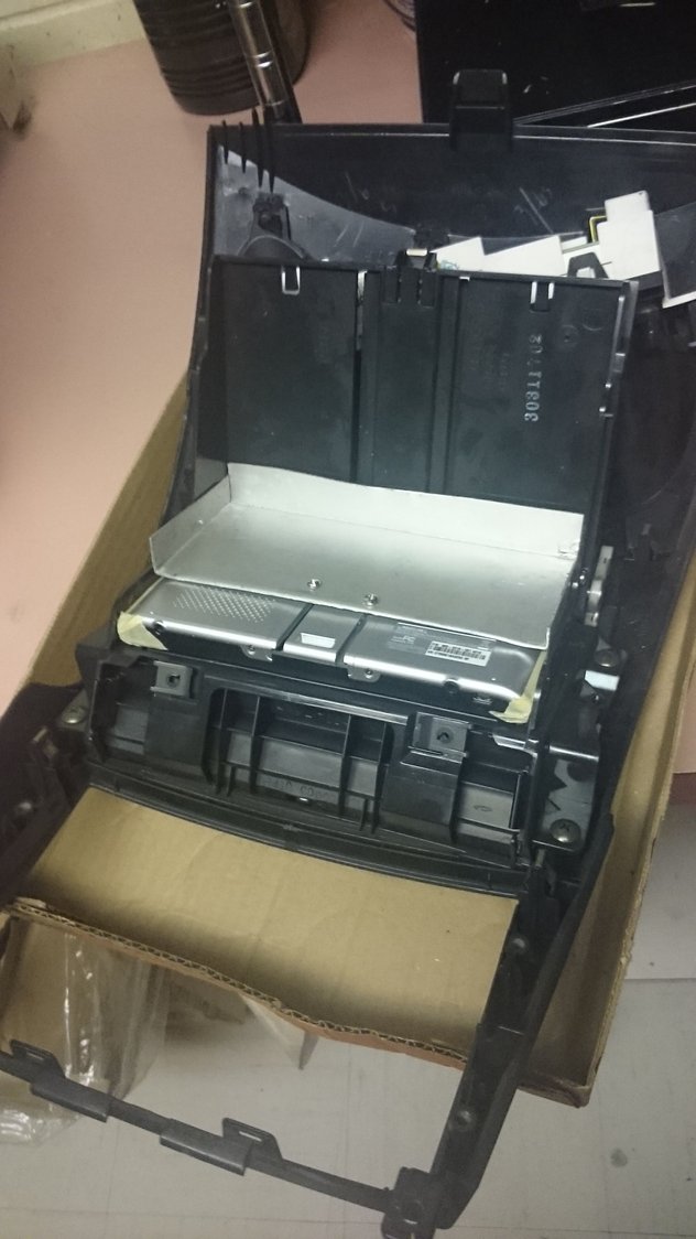

Well, totally didn't see the part where 03' cubby requires modification of unit lol.
Hopefully it doesn't set me back too bad, going to attempt this this weekend.

Doesn't the 1700 have to be shaved down around the sides or did I read wrong again lol.
