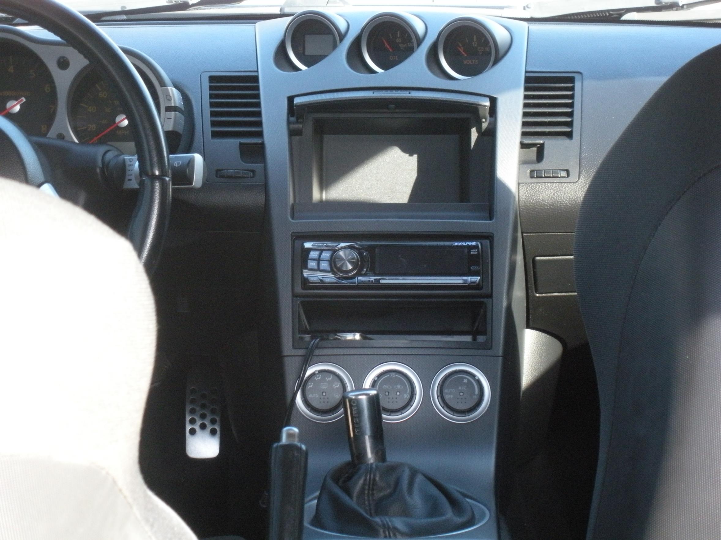

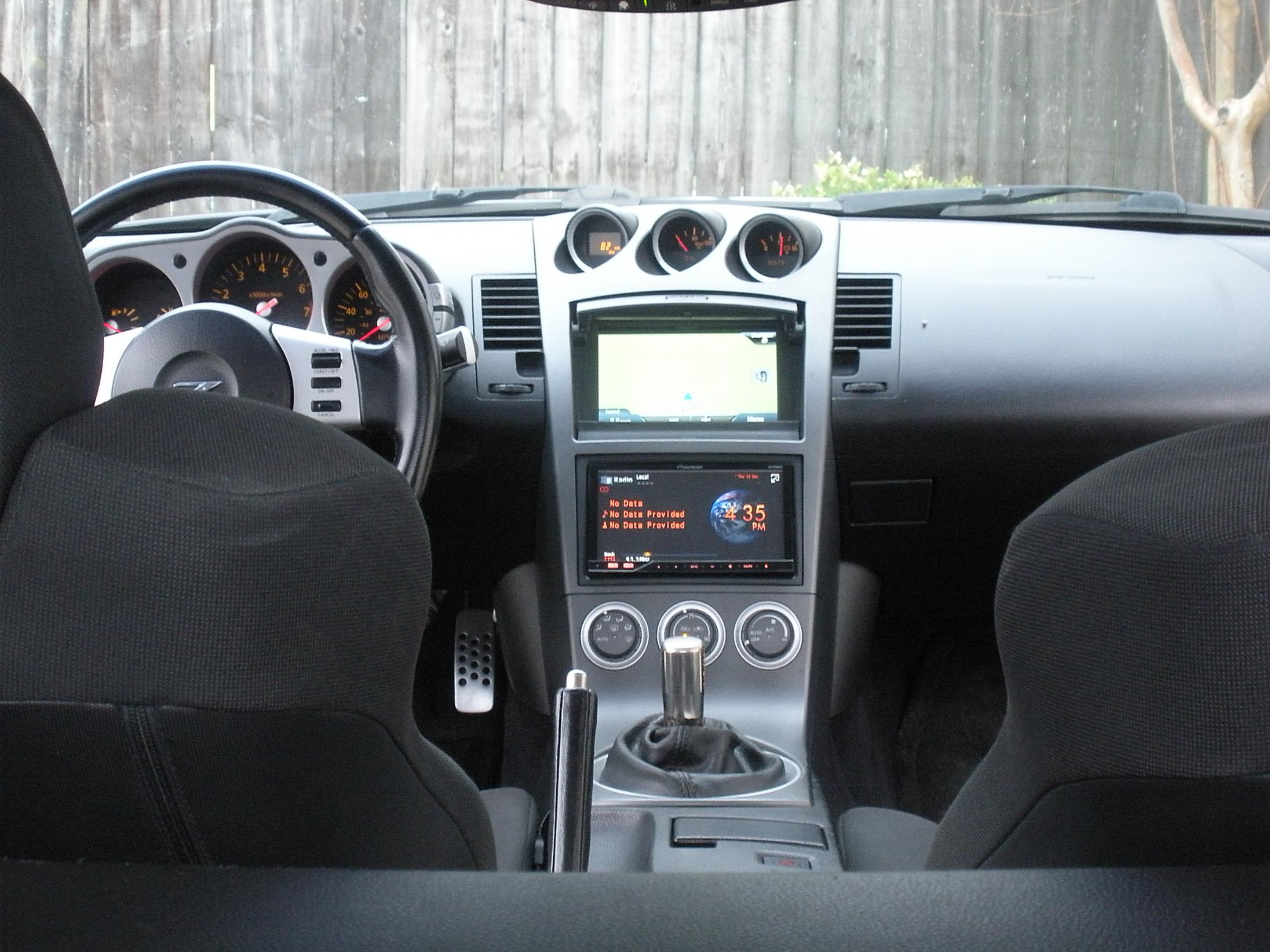

Went ahead and did this last week and its a great mod. First pic is how i got the car, second is it with the Pioneer AVH4300 and last is it all lit up.
Attached Thumbnails Bought a Magellan 1700 GPS 7 inch screen fits in Cubby-dscn1109.jpg   Bought a Magellan 1700 GPS 7 inch screen fits in Cubby-dscn1113.jpg   Bought a Magellan 1700 GPS 7 inch screen fits in Cubby-dscn1114.jpg
