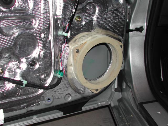

No interference with window at all.
Attached is pic of custom spacers I built for 6.5" JL's

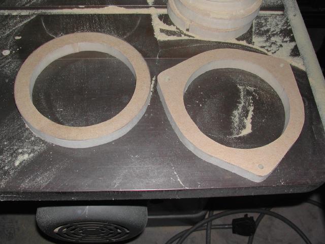

hey grutter, thats a nice looking spacer. can i possibly get the specs for it. such as: thickness, type of wood, adhesive and any other details that might help.
Old Nov 27, 2003 | 10:20 PM
grutter's Avatar
grutter
Posts: 179
From: Matthews, NC
It's made from two pieces of MDF. I used the factory spacer as a pattern for first piece, and cut the top piece to fit the 6.5" speakers. Glued the two halves together.
First attempt was too thick... made from two pieces of 3/4" MDF. Finished spacer (as installed on car) is 1 1/8" thick.

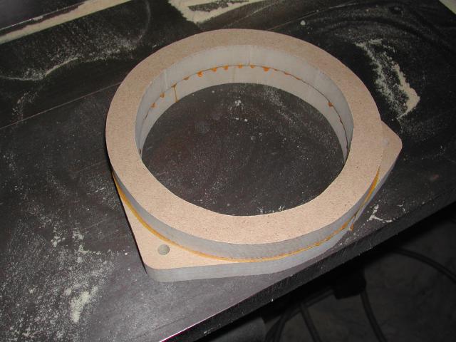

Assembled... but too thick. Cut it down for finished spacer.

thanks for the instructions. i think im gonna head out to home depot to get the materials and get started on it. oh, one last thing, did you just glue them together with wood glue?
Old Nov 28, 2003 | 12:05 PM
grutter's Avatar
grutter
Posts: 179
From: Matthews, NC
Yup
