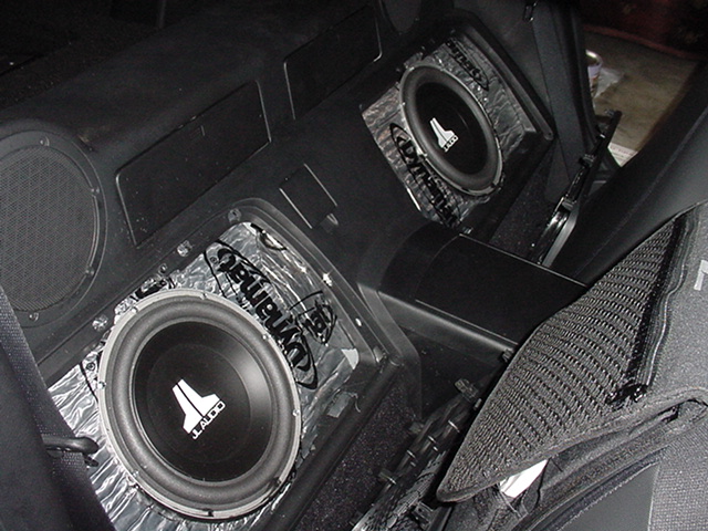

Well hmmm....loaded question. I personally had all 3 of these in my car trying to figure out what sounded "better". I have 2 10's (one behind each seat). AS far as loudest and deepest, W7 pounds the cr@p out of the car. The w6v2 sounded almost as loud and as clear. The w3v2 went in and they hit almost as hard and sounded just as clear to me. When we put them all on the table for a comparison, I chose the w3v2 because the cost vs. sound comparison ruled the others out (price was not an factor for the system, but I wanted the best bang for the buck). I do not think you will be disappointed with the w3v2s and with 800 watts, you ARE pushing the warranty line for the w3v2 but then again, i push 2 with a JL 500/1 and I gain it way down so I don't get a headache. It is all about the enclosure as well. Good luck and again, I'd go w3v2 unless you are competing (hopefully not with 1 sub ) or looking for the "vanity factor". Again, I had a pair of each of these and in that small of a car space, the w3v2s will pound plenty hard and deep and are just as clear at 1/3 the cost.
