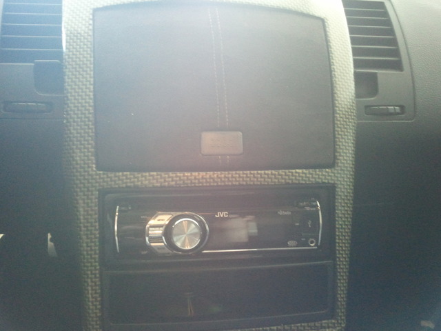

The deck for $.50 of vinyl (i traded some custom stickers for it)

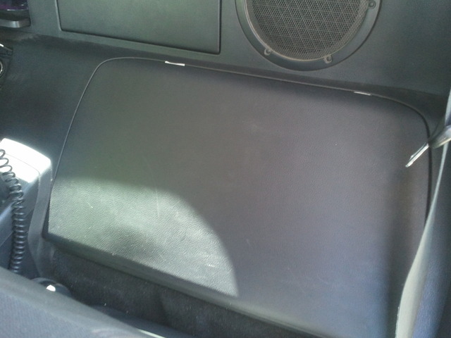

Sub test fit (notice only 3 screws)
with the panel on

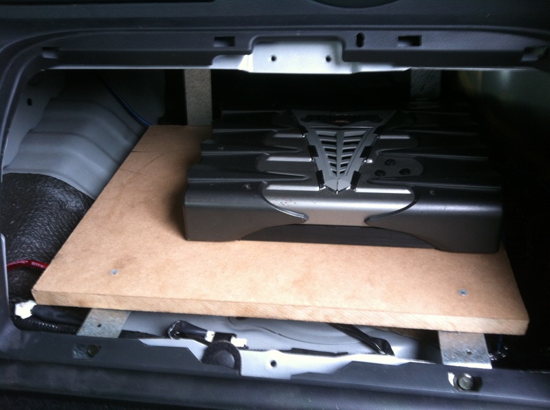

here is what i did with very little effort but huge benefit, first a sub should never ever be mounted in your location unless you build a box and place it in there. use it as a spot for an amp rack

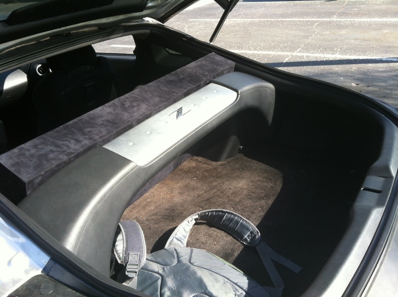

second just build a box for the sub it is very easy and cheap to do, you only have one 10 that requires 1 cubic foot of trunk space, and since it is only one it can be easily removed when trunk space is needed.

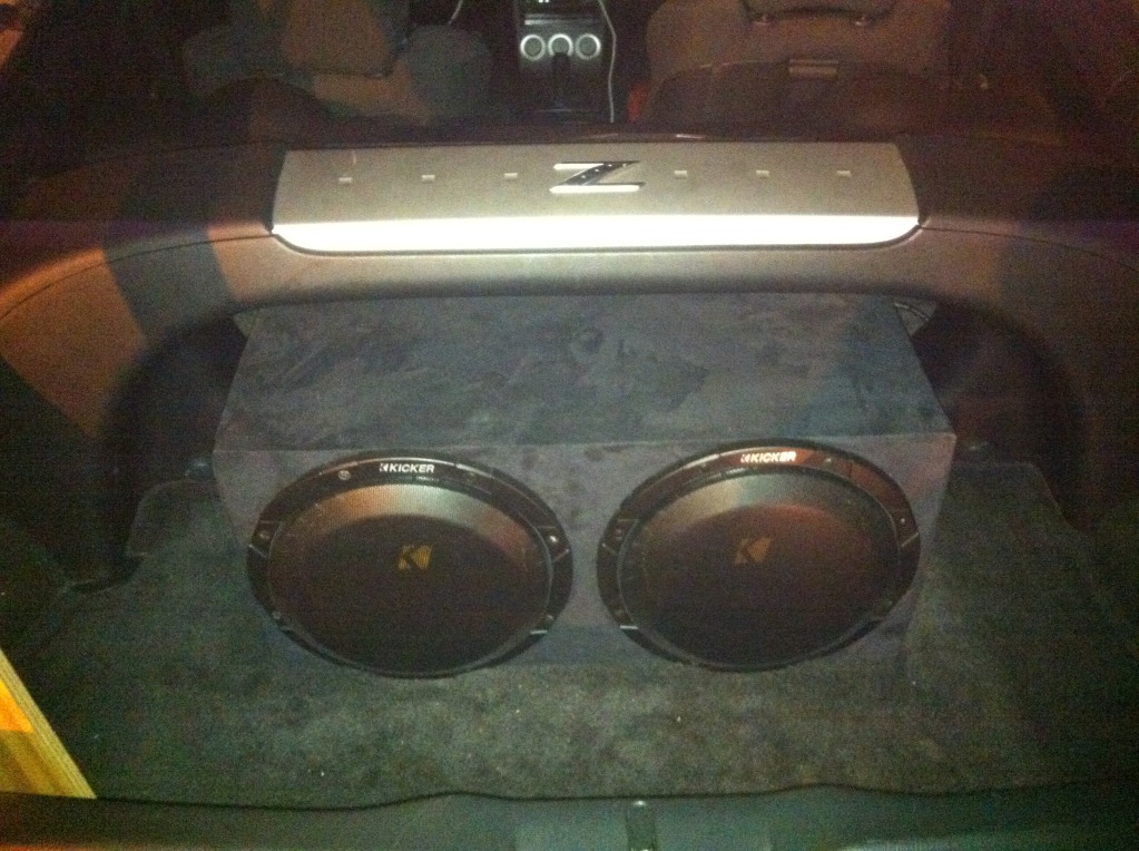

these are the two boxes i built for two 10s. The first sounded very good but took up to much space, the second takes up hardly any space yet still contains the same air space, doesnt get as deep of a low but still slams.
