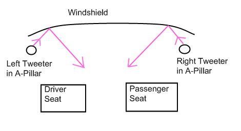

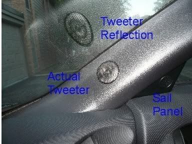

I prefer placing the tweeter into the A-Pillar instead of the stock sail-panel. This provides a better front sound stage, and you have less size limitations when selecting a tweeter.
