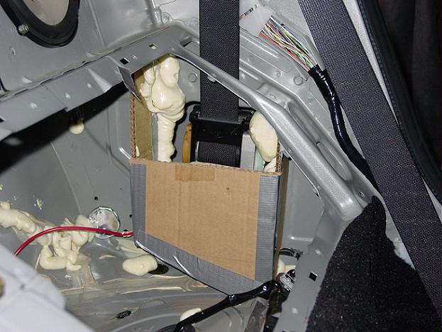

made a box around the seat belt assembly

the box was filled with great stuff around the edges and bottom to give it some substance. Eventually I dynamatted the entire compartment.

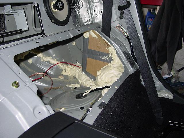

more great stuff...

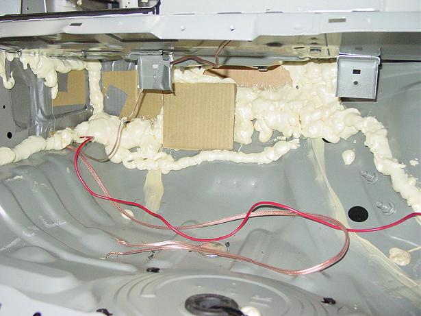

the gapping whole in the back was also blocked off with more cardboard and great ****...

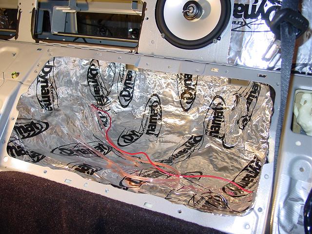

and finally the mat...

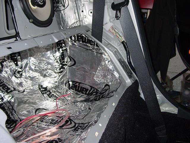

here's the dynamat around the seat belt assembly box..

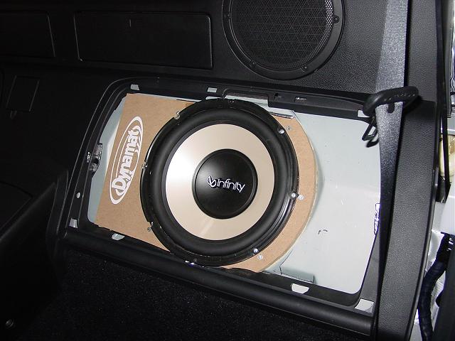

panels back on...

and back to stock!

This looks great!! When I did this I had the hardest time getting my apline on the bracket. It looks like you made an additional wood bracket to attach the speaker to, then attached the two brackets. Is that correct? Could you give a detailed account of the creation and mounting of this second brackett. Also if you could take some closeup pics of it it would be great. I thought about adding an additional bracket but I thought the speaker cover wouldn't fit therefore negating the stock look.
