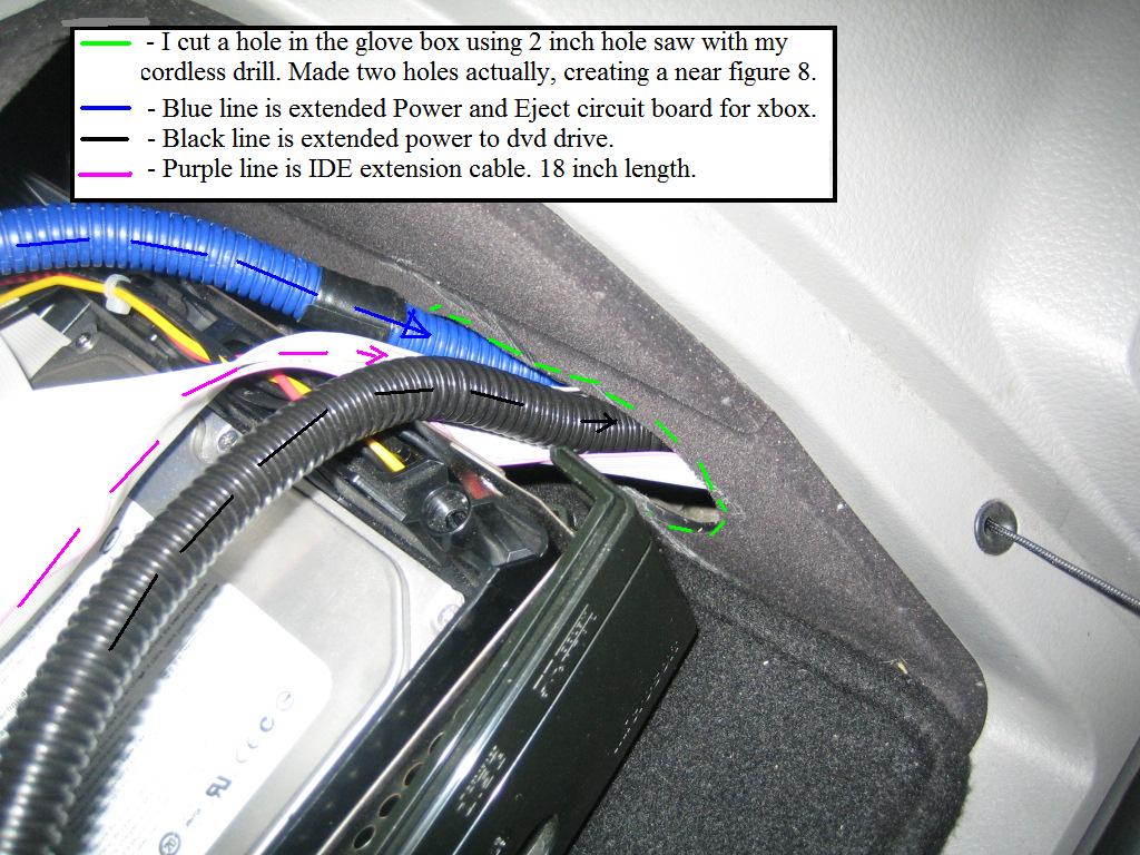

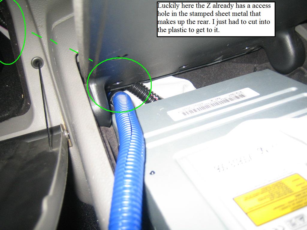

I cut an access hole in the side of the glove box using a 2 inch hole saw with my cordless drill. I actually cut twice making a figure 8 size hole. worked perfect. I took the glove box out of the car to cut it though.

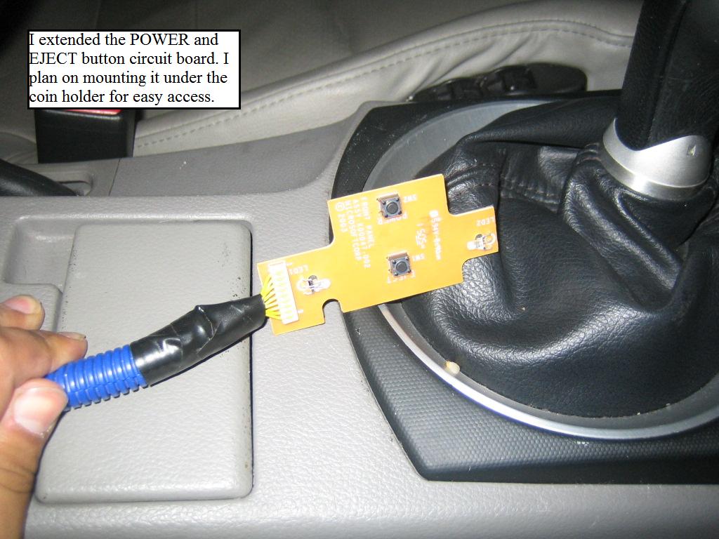

I labeled all the extended wires i needed to make for the xbox. I had to extend the wires that power the dvd player drive of course and the wires that go to the small circuit board that house the power and eject button the xbox so i could have easy access to them.

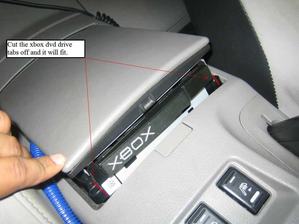

I installed the xbox dvd drive in the cup holder cubby. The cubby is near perfect size for the drive. The stock xbox drive has these plastic tabs that you can cut off. I still need to do this.
ALSO, the cup holder cubby rear has a section that removes but leaves tabs that still restrict the dvd drive from fitting perfectly, so you need to cut those too. I dont have a pic of those, but if you look in there and try test installing your drive you will see what it hits on back there and know what to cut.

I plan on mounting this tiny circuit board under the coin holder. The coin holder pulls out easily and the board sits in there nearly perfectly. Ill post a pic when i have that part complete. You do have to cut a bit of the bottom of the coin holder so ill be sure to post that too.
