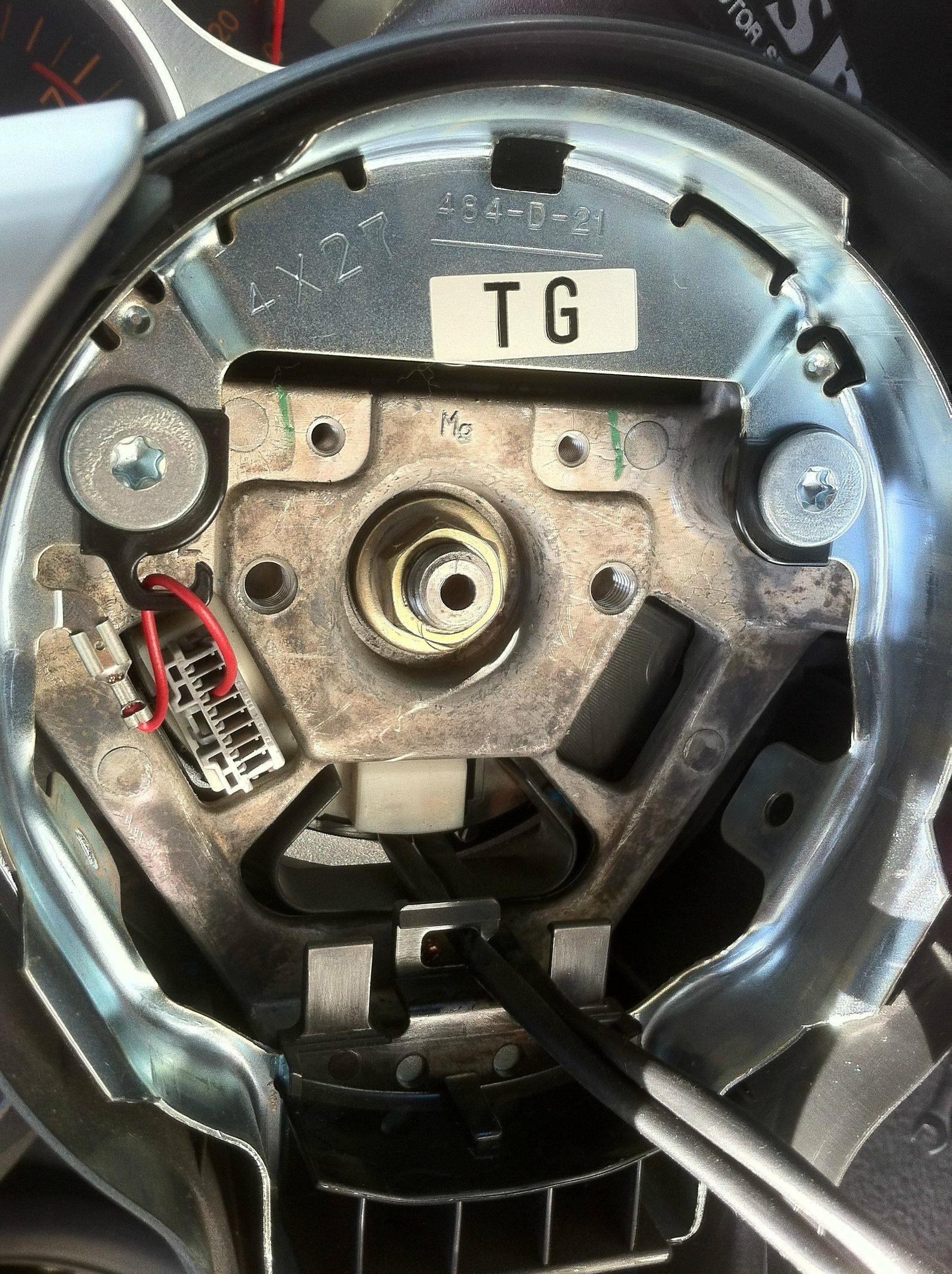

I hope you guys can help me out on this. I took out my airbag today to try and check if I have what I need to put the steering controls on my Z, but I'm not seeing anything. I'm hoping that I'm just missing something. Do the wires from the controls go into the same "terminal thingy" as the red wire does? If not, am I just out of luck? Does mine look the same as y'alls did?

your all good man. just unplug the plug with the red wire and the CC controls will go in place of it.
Yep,
That terminal will have the rest of the pin positions filled for the CC signals.
