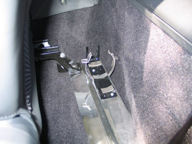

I've got pictures of the extingusiher and bracket fitted into my car. I'll try and post them here, but if anyone is intererested in them via e-mail, then just PM me with the e-mail address and I'll send them.

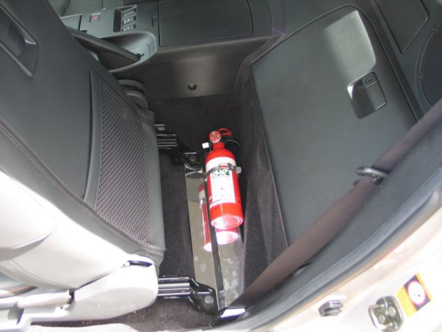

pic#2

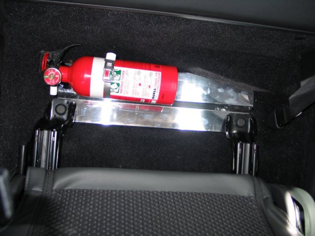

pic#3

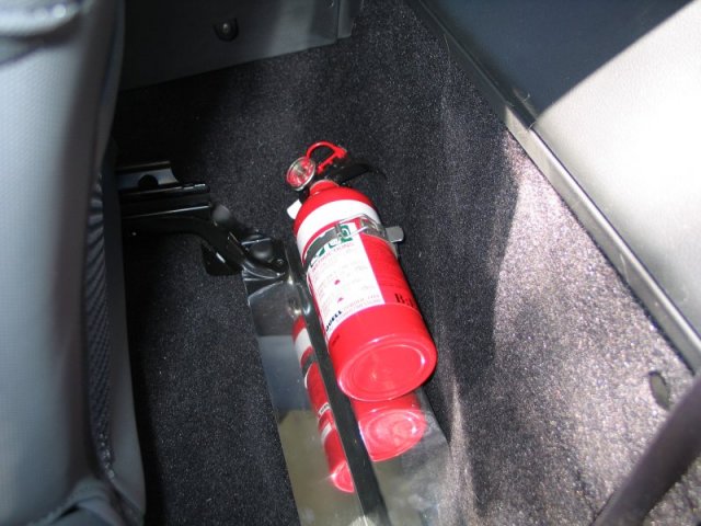

How thick is the aluminum?
1.6mm.
What is the height of the "step"?
Less than 1" (ie. 2 - 2.5cm). The following pic shows the 'step' pretty well and you can see the size/height relation to the both that holds the seat to the floor.

should that read 1.6mm??
Yes, you're right - 1.6mm ... my misstype. I'll fix the post that mentions it.
does it have to be shiny? or can it be made with stainless steel?
I'm sure that they can make it from whatever you want. They can even paint it for you if you wanted. I wanted it from alluminium and that, as far as I know, is always shiny. My S2000 bracket was shiny as well.
Is there something to it that I'm not seeing? A flat piece of alu with two 90deg bends and holes for the seat bolts? $150? Seems a bit much to me
That's right, not much to it ... the only irregular part is the angled cut to make it fit the back wall (which get's closer to it towards the door). If you bought it from someone who manufactures these things then it should be maybe $40. That is how much it cost me for the S2000 and it would cost for the WRX. Difference is that this one a one off, 1st time ever so they had to measure it, cut it, fit it, do it again etc, just to get it right. I'd much rather pay $40, but I'm not aware of anyone who has done this before so I copped the $150 fee (ie. 2 hours of labor + GST).
They told me that they'd make another one for around $100 (ie. now that they know what is involved). I'd guess that if someone asked them to make (let's say) 10 in one go, then they would be happy to make them all for ~$500. Though, I did not talk to them about anything like that as I really just wanted one for myself and that's all .... I'm just guessing.
