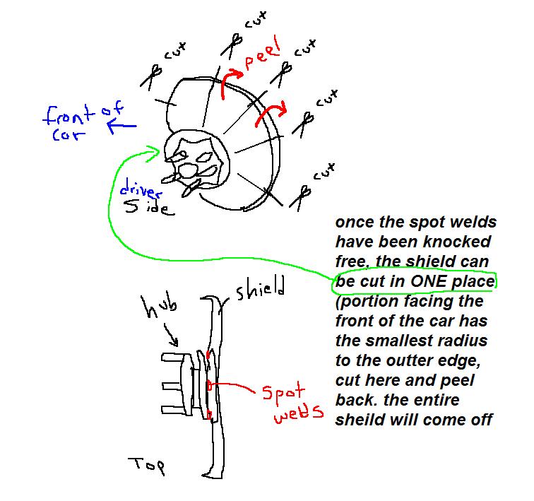

if you're thinking about removing the rear dust shield--
the sheild portion is actually spot welded to a 2nd piece that's then attached to the hub.
if you cut and peel the sheild back (somewhat like a opening a cupcake wrapper) you can get a chisel in there and then pound @ the welds with a rubber mallet and you can get a clean seperation of the dust sheild from the hub, rather that having jagged edges after using a metal shears or rotary cutter... just wear ear plugs cuz the hammer resonates in the fender well.
