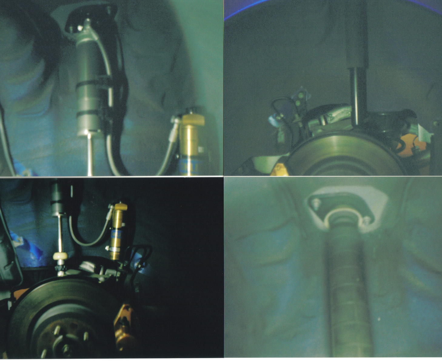

I have Ohlins DA shocks. Before anyone says they're not made for the Z, you're right. (not yet) I am a fabricator by trade and I made what I needed to adapt a set of Ohlins to my Z. The shocks satisfy all of the rule requirements as far as length, system of mounting, etc. The reasons I can't use the stock bump stops are....(this is had to describe w/o pics)
rear...The factory bump stop "snaps" into the upper mount around where the shock shaft bolts. I chose to invert the Ohlins so the upper mount is now a stud on the end of the shock body. My bump stop is now on the bottom, still concentric to the shock shaft. The shock meets all of the requirements in 13.5.
front...The bump stop also "snaps" in concentric to the shock shaft. The front is SLA with a coil-over so I had to mount the shock in the factory position, but to adapt the 16mm shaft to the 12mm mount I had to make a threaded adapter. I ended up with a shock that has the same overall length and stroke, but a longer shaft and shorter body. As a result the factory stop contacts the shock body over an inch later and will allow, in extreme bump,
the upper ball joint to hit the inner fender. So, I installed a different bump stop, still concentric with the shock shaft, that is the right length to keep anything from hitting and still satisfy 13.5.
Therefore, the compressed length of the
shock at the initial point of contact with the bump stop may not
be increased from the standard part
I hope this all makes sense. It does to me, but I built them.
