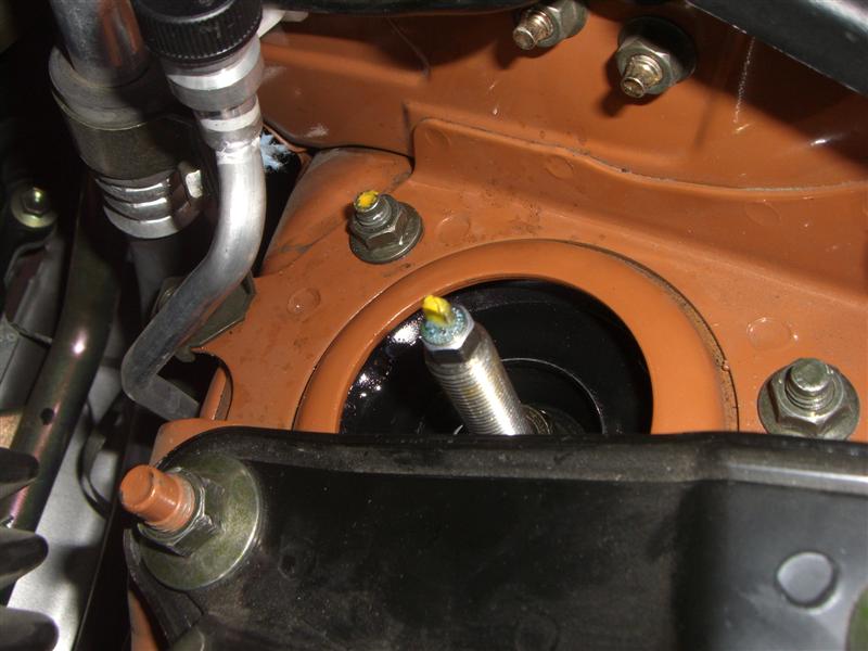

When I purchased the shocks from TCK I ran them at the track once and the front driver's side shock developed a pretty bad leak. I paid TCK for a new one so I wouldn't have to wait 4+ weeks while they inspected the bad one. When they confirmed the shock was defective they gave me a refund, all good there.

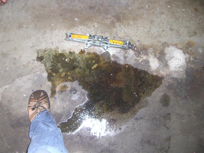

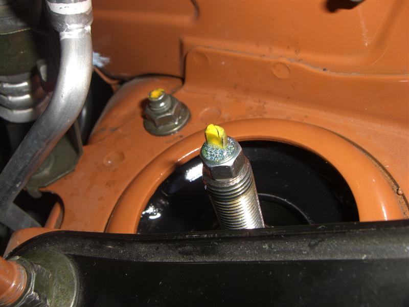

Fast forward a couple of months, and yesterday I got the car ready for the NASA TT for tomorrow at thunderhill. This afternoon I pop the hood to check fluid levels and notice the new shock leaked a lot again, same side. I clean it up and pulled the car out of the garage for a wash. I then noticed a big spill on the garage floor, so I get close to look at it and it's shock oil. The shock is contantly spilling oil/bubbles from the rebound adjustment ****.
I'm not even sure if I should bother showing up at the track tomorrow with a blown shock. I'm pretty frustrated since getting the shock replaced is time consuming and the turnaround time is long unless I pay up front for a new one and then get a refund.
I'm not bashing TCK since I still think they make a good product, but I want people to be aware of this since I'm not the first person to have the same thing occur with these shocks. There is something obviosly wrong with the assembly or QC and it sucks for us, the consumer.
Here are some pics of a close up of where the oil is coming out and the puddle left on the floor.

According to Pete at Tc Kline and Gordon at Koni, the shocks were a one time special run by Koni in Holland. IIRC they are based on the same shock as the OTS yellows, but with the double adjustablity and valved accordingly.
OTS yellows are known to leak from the same rebound adjustment blade spot, (I had one that did). Also sorry to hear he's having a issue.

ULLLOSE's Avatar
ULLLOSE
Posts: 330
From: Orange County
Do you have a pic that shows the top busings? "leaker's" have been a fairly common problem on the RX-8 Koni sport fronts. There seems to be a lot of side-loading on the shaft where it goes through the upper mount, this creates a leak around the adjuster over time.

Spoke to TCK and they'll be sending me a new one. I still have to pay for one and get a refund when they determine that the current one is defective. They won't charge for freight though which is cool, so no money out of pocket besides freight to them. Not bad.
My right one leaks slightly when I adjust it but it's very very little and not worth changing unless it gets worse.
