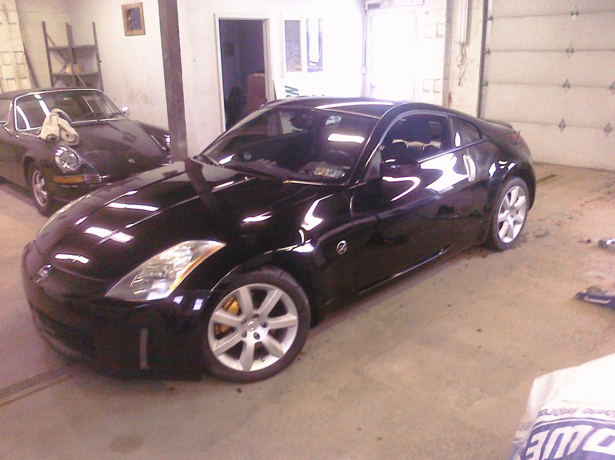

I've got a 2003 Track edition. Ignoring all of the reasons I would not want to do such a thing, will 17" OEM wheels fit? I'm thinking for autocross purposes that 17" tires would be cheaper than 18's, even though my volks are way lighter than these 17's. However, I'm concerned about fitment issues, especially considering the size of the Brembo calipers. Thanks.

Just buy a set of 17x9's and run 275/40-17 on them. Yes factory 17's fit over Oem Brembo's.

Old Dec 28, 2010 | 01:58 PM
ajw101's Avatar
ajw101
Joined: May 2009
Posts: 41
From: PA
confirmation. they do fit.
