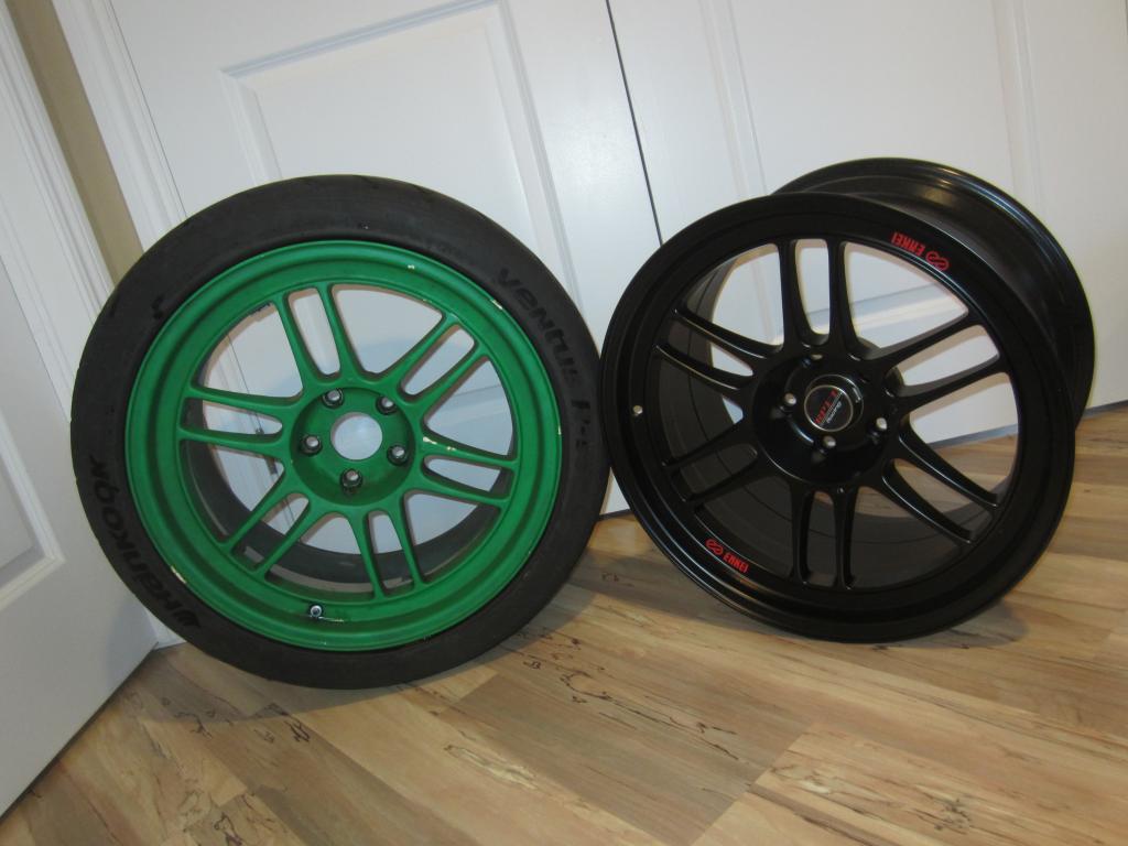

For test and tune 265/35 RS3s on Green 18 x 9.5 +15 rpf1s
For time attack 295/30 C70 TDs on Black 18 x 10.5 +15 rpf1s

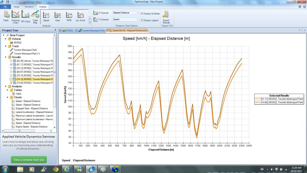

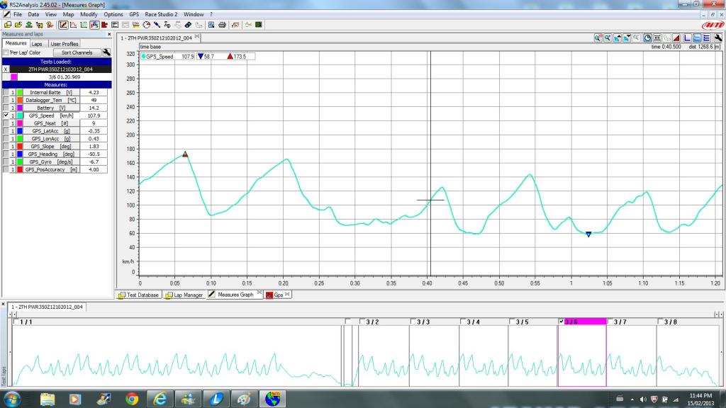

After reading on a friends blog about this program called optimum lap I thought I would use it in conjunction with my data to see how my car should do at TMP. After painstaking recreation of my car's physics and the websites TMP data an "optimum" lap time of 1:21.11 was achieved. Very cool. I set the star specs lateral grip at 1.05G which I think is reasonable as those numbers were seen occaisonally within my GPS data. While some sector speeds are off when put up to scrutiny, I think both my friend and I found this program to be very accurate overall. When I increased the lateral G of a tire to that of Hankook TD's lap times dropped significantly. I'd highly recommend checking this out. http://www.optimumg.com/software/optimumlap/ TMP GPS data has been saved on the website once you have downloaded the program so there is no need for you to have your own map. You can just import it. Simulate. And have fun.
Predicted optimum lap.

One of my best laps from real GPS data. 1:20.969 here.

And stunning predictions with 1.24 G tires. 50 hp more. 2700 rpm more. A little downforce. And 110 lbs weight loss.
