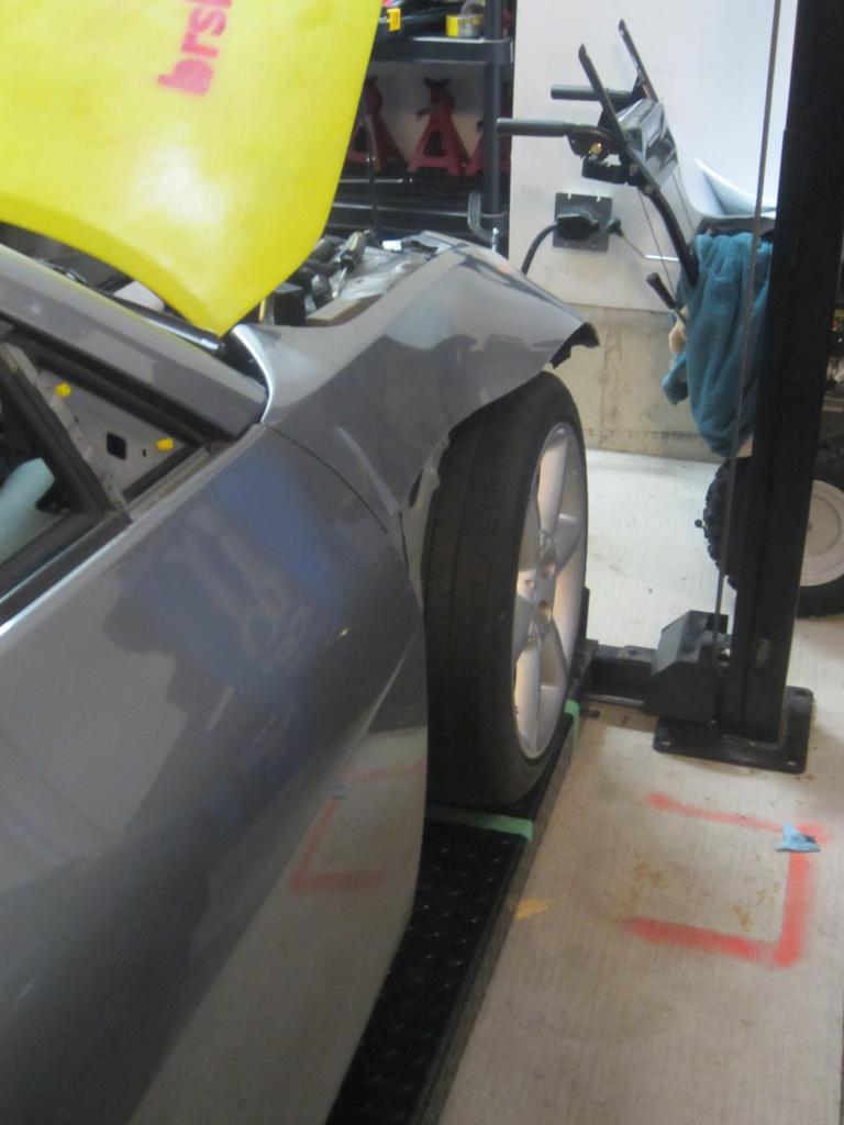

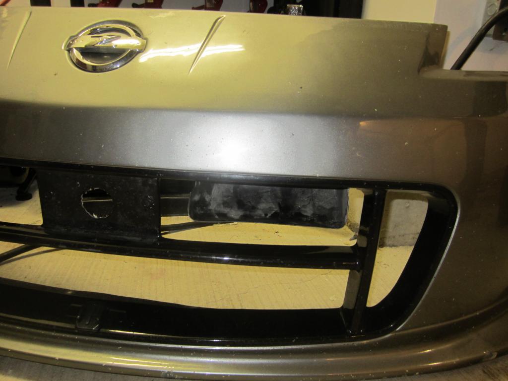

installing the snorkel
I figure with the front bumper taped up to make downforce on the splitter the snorkel is a good idea.

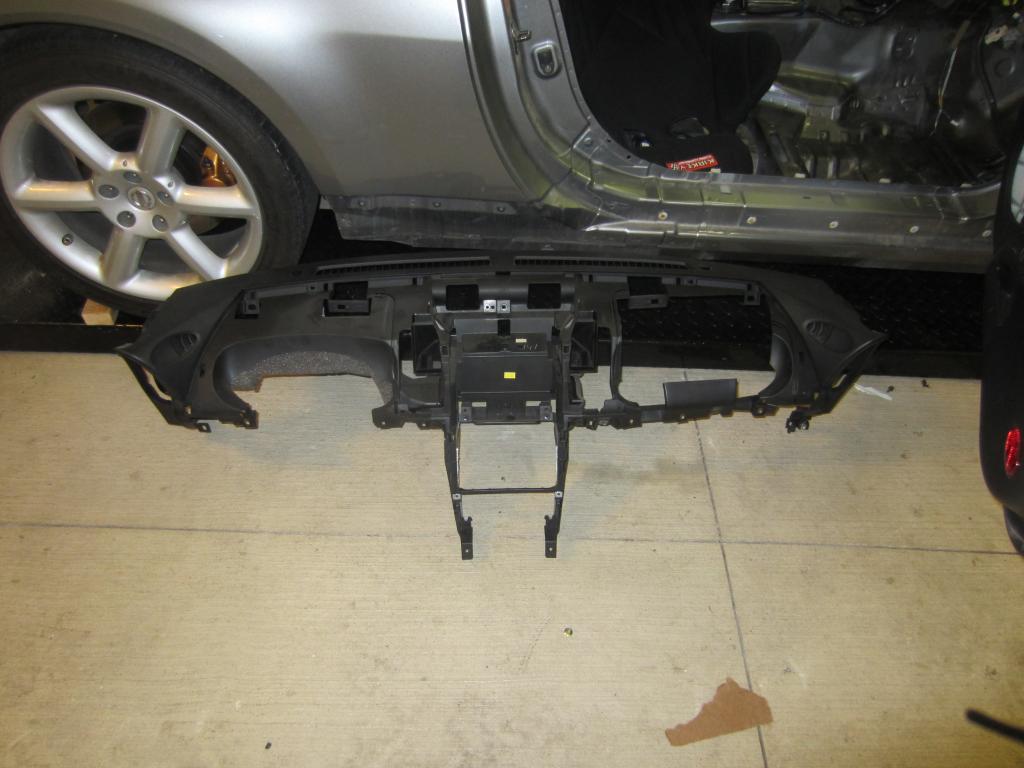

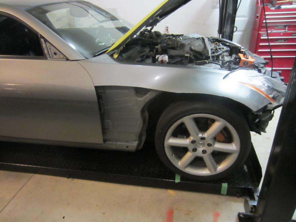

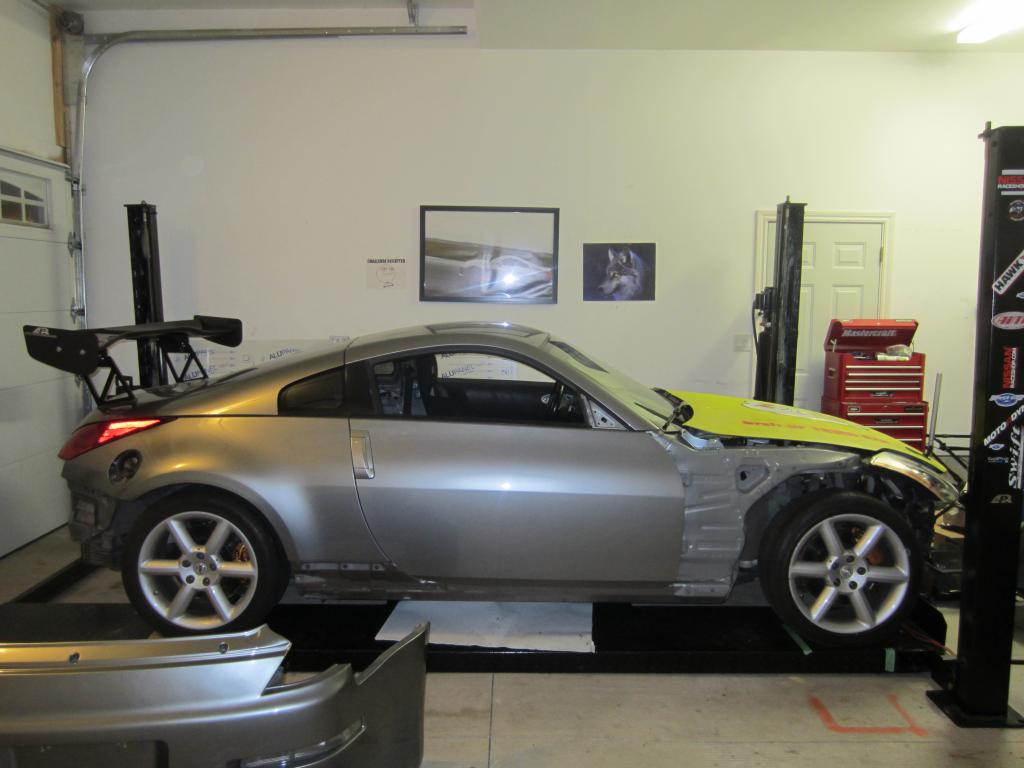

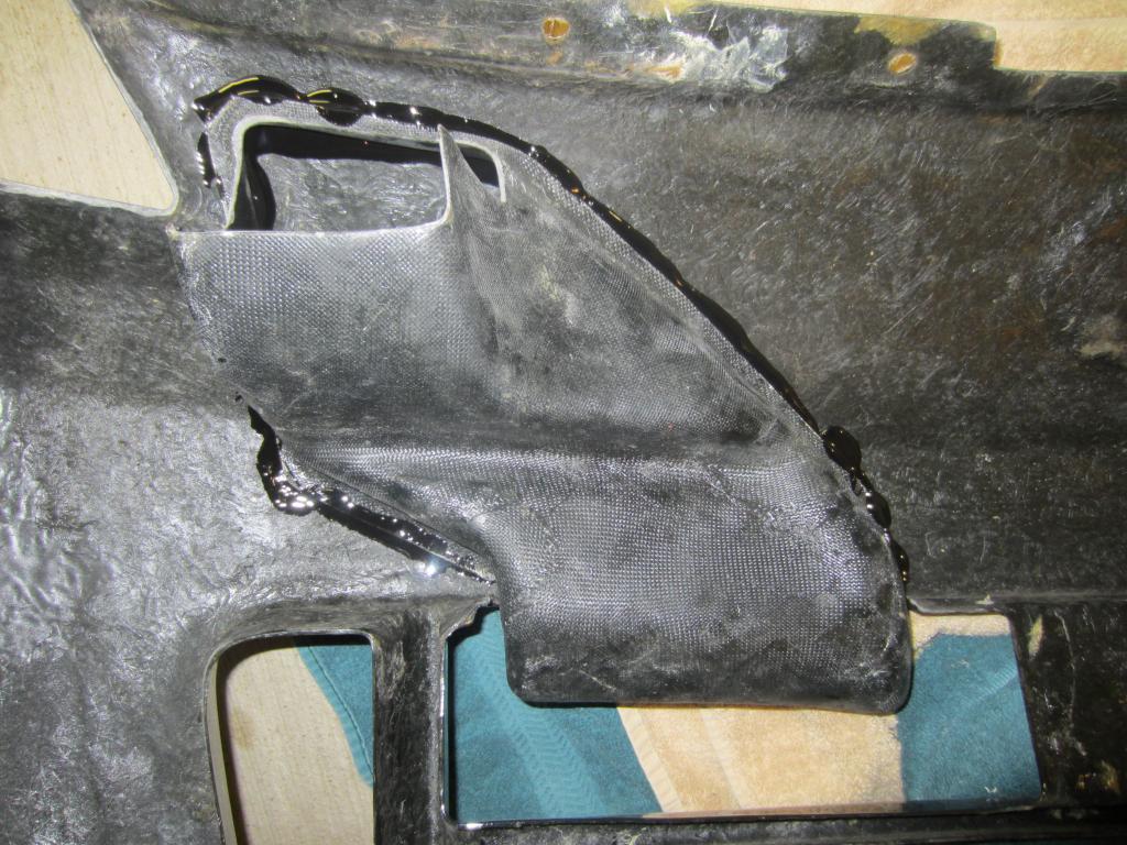

weight reduction is getting stupid. Yes I plan on running without those body panels. The front bumper and splitter will go back on for aero.

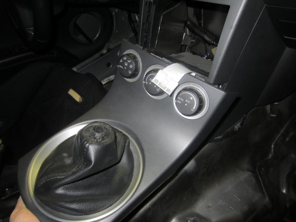

I don't know if this will continue to be an issue or not but with this unplugged the cars climate control system pumps full blast. Will double check later when more is gone.
taking this out was a *****.

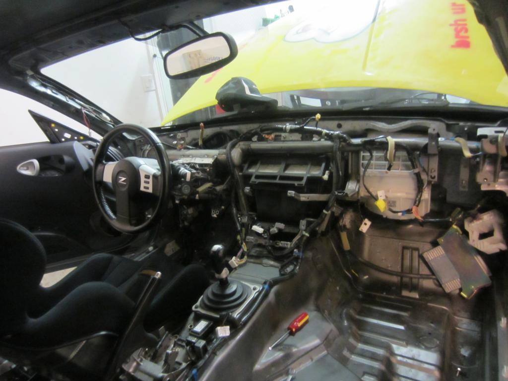

this is progress for now. Still some things to go obviously. The dash will then go back in as a skin only. I guess rules state oem dash and console has to be there. I took a bunch off the doors and the mirrors are gone. No rule says I have to have side mirrors. Might rig up a larger mirror inside. We'll see how it works out. Might put them back on.

When you disconnect the climate controls it defaults to full blast. If you remove the control module it will turn off, but you will also lose your cluster (fuel, RPM, etc). Im sure there is a resistor you could put in its place but I haven't found a pinout diagram for it yet.
Old Dec 9, 2012 | 09:42 AM
  #395
Voboy's Avatar
Voboy
iTrader: (58)
Posts: 2,995
From: Houston, TX
brian (lightning guy) mentioned something about that............. pull the fuse for the fans.
Old Dec 9, 2012 | 01:23 PM
  #396
GT-Rob's Avatar
GT-Rob
Joined: Feb 2010
Posts: 721
From: Guelph
I guess if you take the blower out anyway...
also yes the dash is a pain in the dick to pull out. I removed the steering wheel to do it.

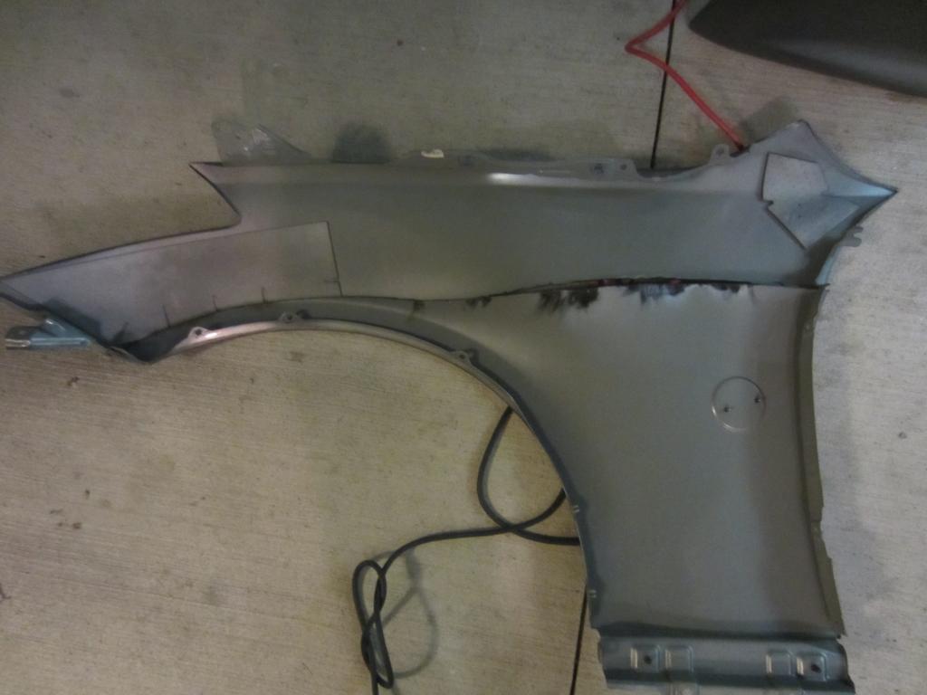

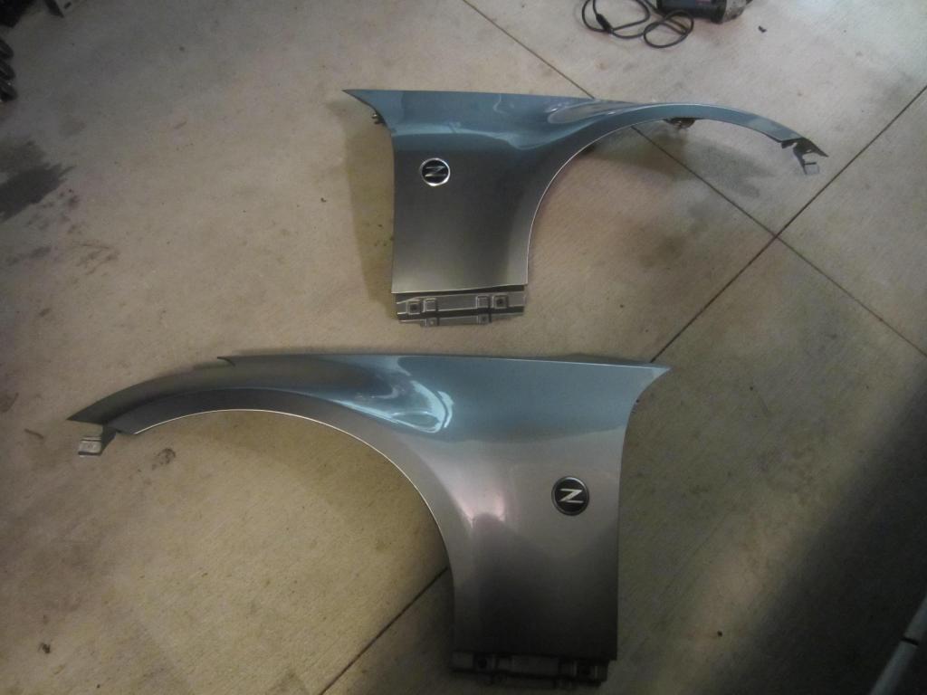

After much discussion on facebook tonights project is Epic Super GT fenders
Step 1: DIY + DGAF
Step 2: Angle Grinder.
There we go.
Weight reduction roughly 11 lbs.
Fitment: OEM.
Increased wheel clearance. 18x 10.5 + 15 w/ 295s will fit with ease. Need to find some 18x 13s now.
Cost: $0
Time to complete: 10 minutes.
Other: Intimidation factor

Originally Posted by 2TH PWR
think there may be any negative effects on aero?
