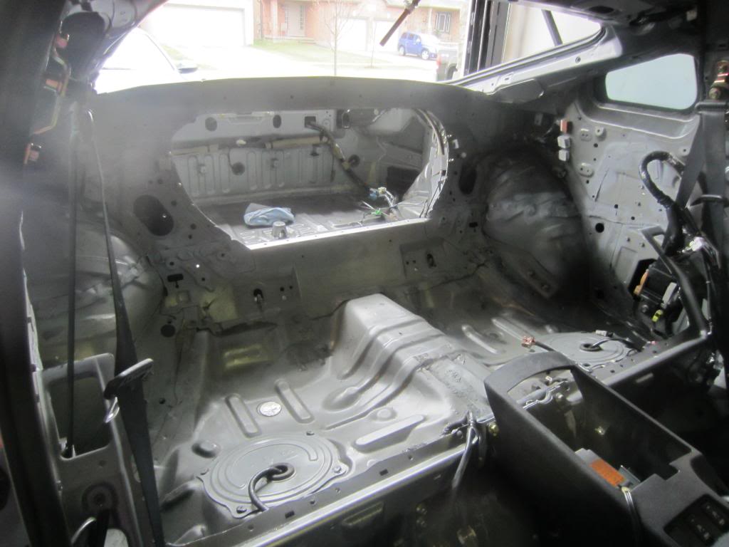

More weight loss today. A few hours with an angle grinder, 5 cutting discs, and a grinding disc and I took out most of the metal housing unit behind the seats.

After.

You can see I chose to leave some metal around the seat belts.
The pile. Weighed it in a Blue Bin on a bath room scale using myself holding the bin as a tare weight just as I have for everything I've taken off. I was able to weigh 27.2 lbs of scrap. I'm not concerned about loss of strength. Those plates with the black metal with the gold coloured bolts seem to provide the bulk of the strengh and rigidity. That brings total weight of things taken off the car so far up to 324.2 lbs.

WOW lookin good man!! So clean in there now

Damn you! Nice to know the weight though, I figured it was about 30lbs. Even if you put an alum bar across it would be 1/4 the weight with just as much or more strength.
