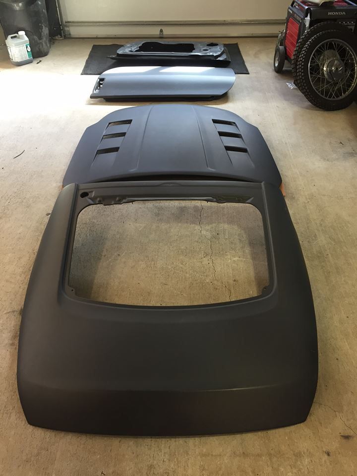

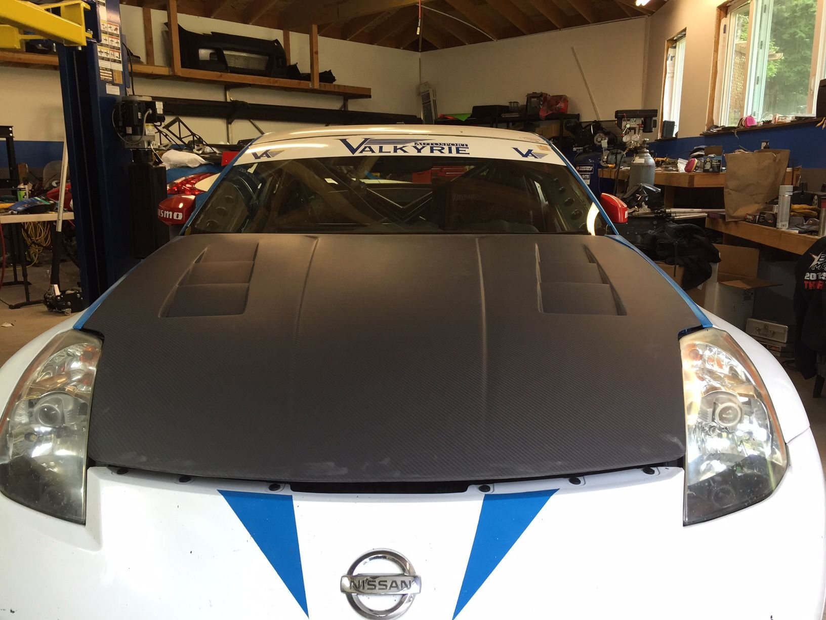

This is how we loose over 100 lbs to try to catch the M3's. Seibon Dry Carbon!

Whoa...too rich for my blood.
