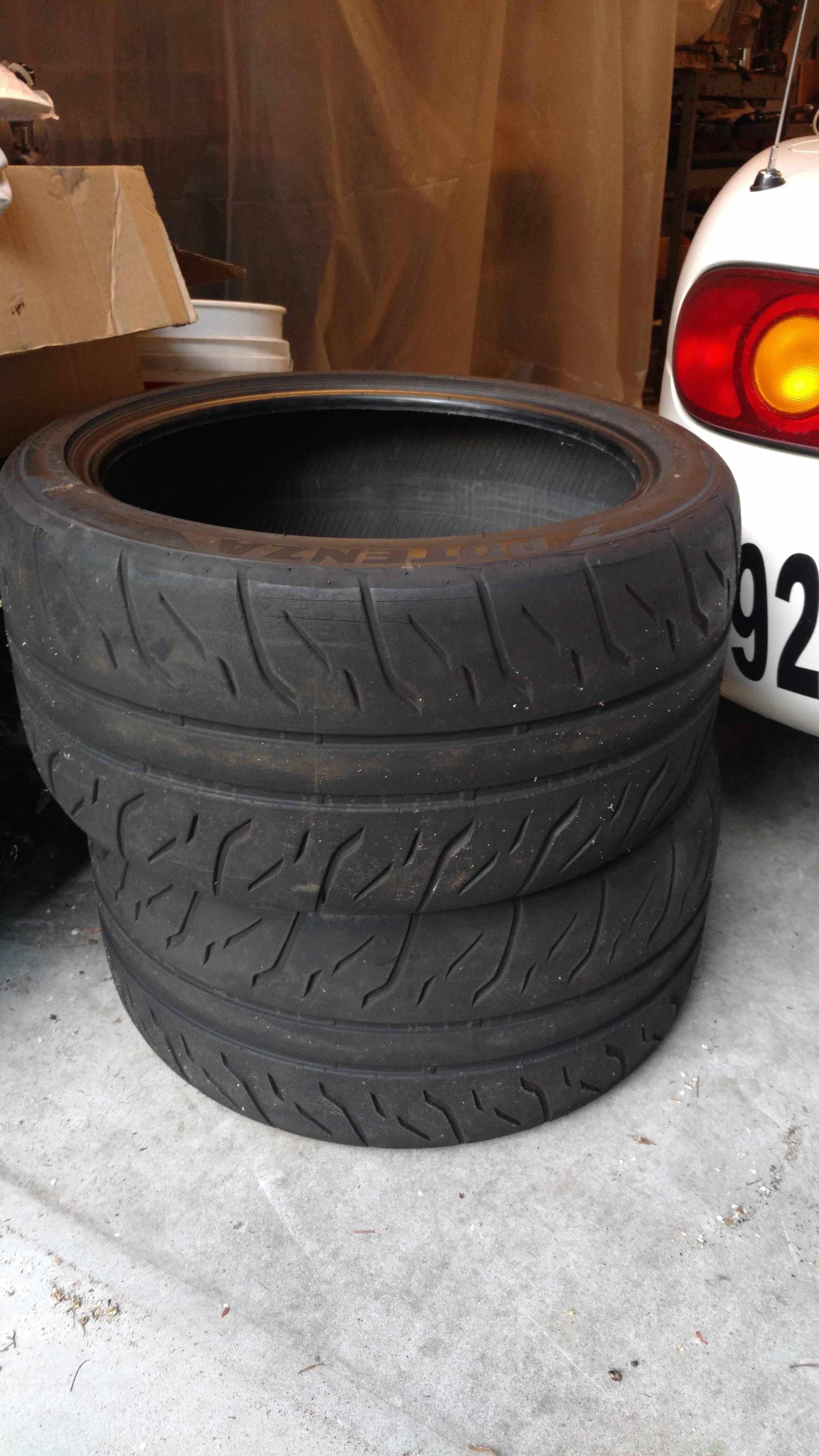

Got some 4-event 275 RE71R take-offs, two new ones are on the way too. If these two end up being rocks(they don't look/feel it) then I'll buy another two.

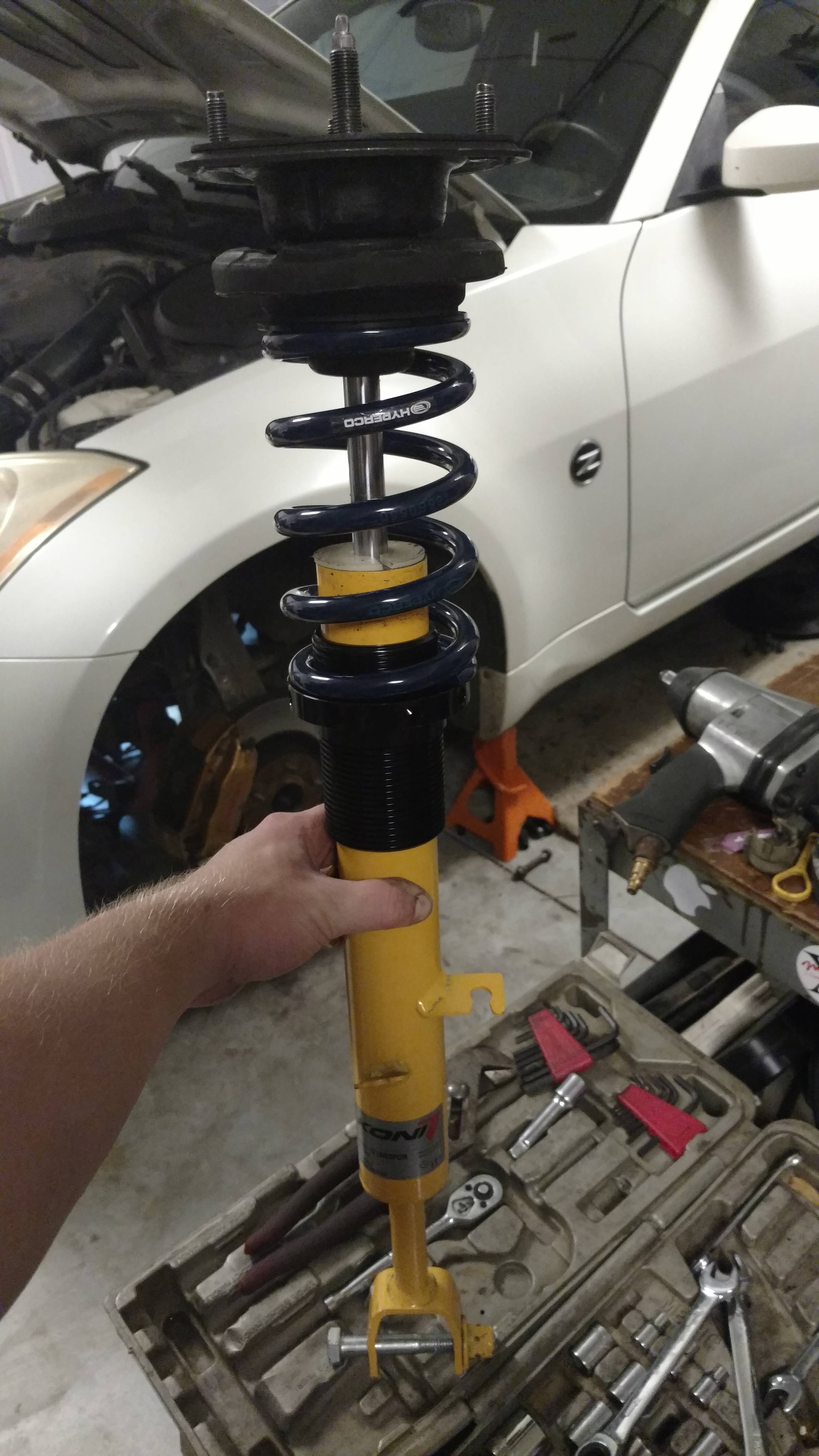

Bought some 5k mi used Konis with some Espelir springs. The springs aren't my first choice, but they're stiffer than my current setup.
So I'm actually really considering buying coilover sleeves & perches for the Konis and running lower rates on them until I get them revalved. Though, I'm not sure what rates I should run or what size springs.
2.5" OD & 7" long front and rear?
Konis yellows are limited to about 600 for OTS valving, so 500f/550r or is that too much rear ratio?

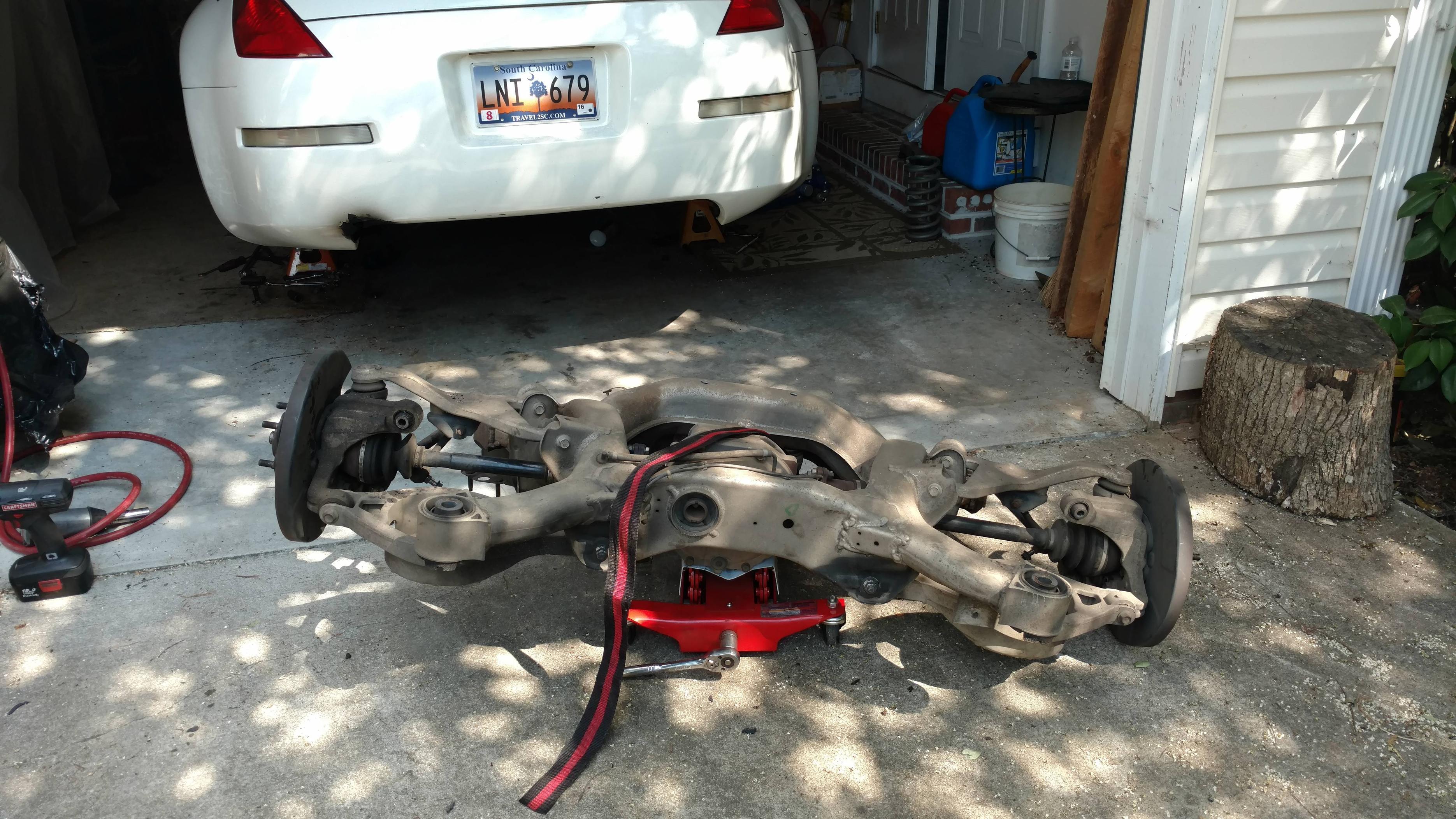

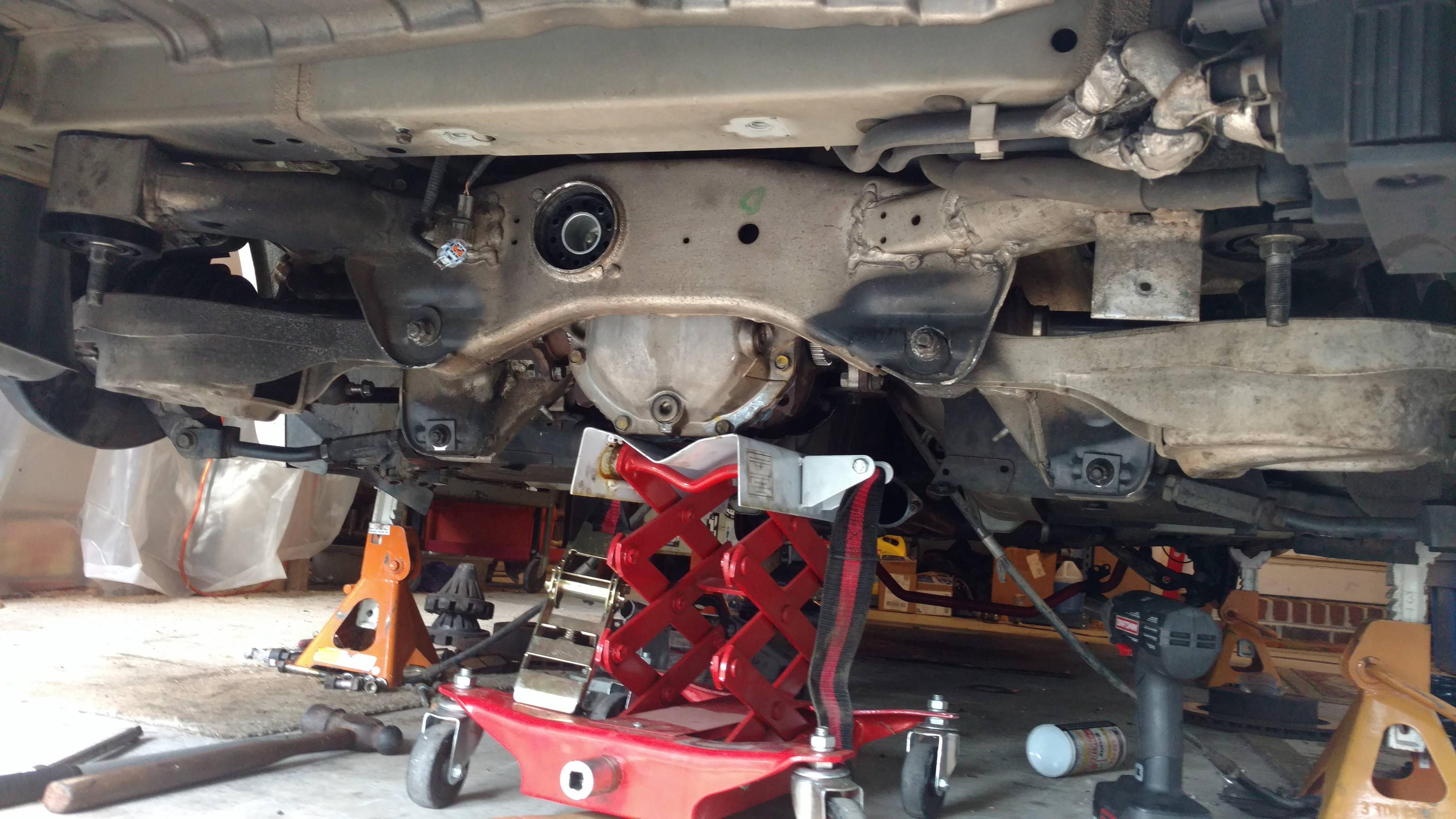

Removing the subframe went about as smooth as it could with the car on jackstands and doing it by myself. Total time of removal for me was about 4hours, but I spent a solid 45min fiddling with the damn e-brake drum setup.
Having a shop install the OSG into the carrier and reinstalling it with the OSG next weekend. Then I'm installing Konis with a ProParts coilover setup during the week while it's up on the stands. Went with 550f/450r based on Mike's and Jeff's recommendations along with the stock Koni valving.

Can you pressure wash that thing while you have it off?

Hah, no joke. It's covered in dirt! I think the PO lived on a dirt road or something.

Going to pick this thing up tomorrow, finish up the shocks/springs and get the RE71rs mounted on Thursday, swap out bushings on subframe/diff on Friday, reinstall subframe/diff on Saturday, have Sunday to button things up if needed, alignment on Monday. Next autox is at zMax next weekend

Yeah, 1000+F/700R is definitely the norm for STU cars. Mine are still OTS valving on the yellows, so with 1000/700 they would of been way past the range and not nearly as effective. I'll send them off to ProParts this winter for a revalve and swap to 1000/700 at that point.

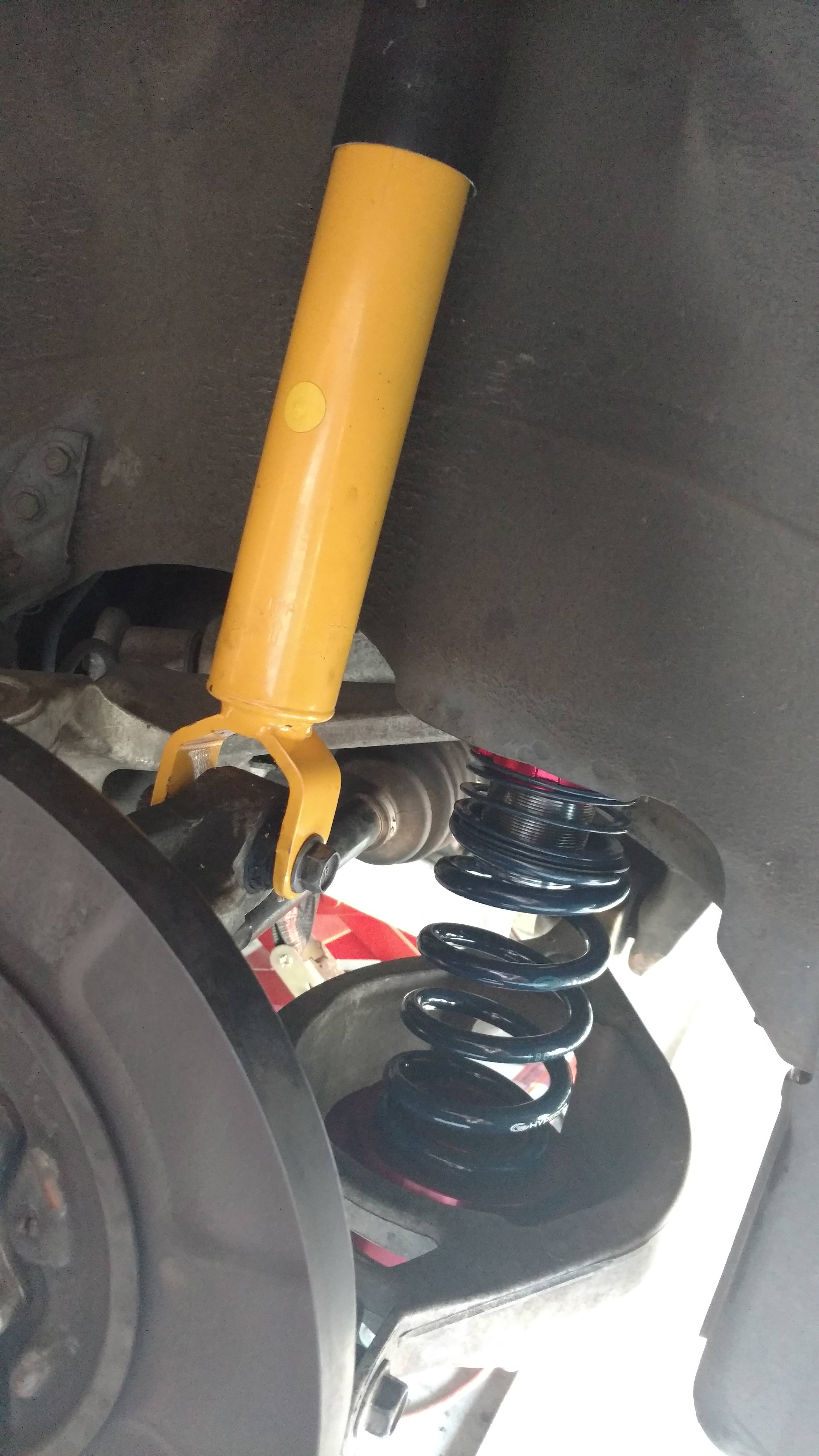

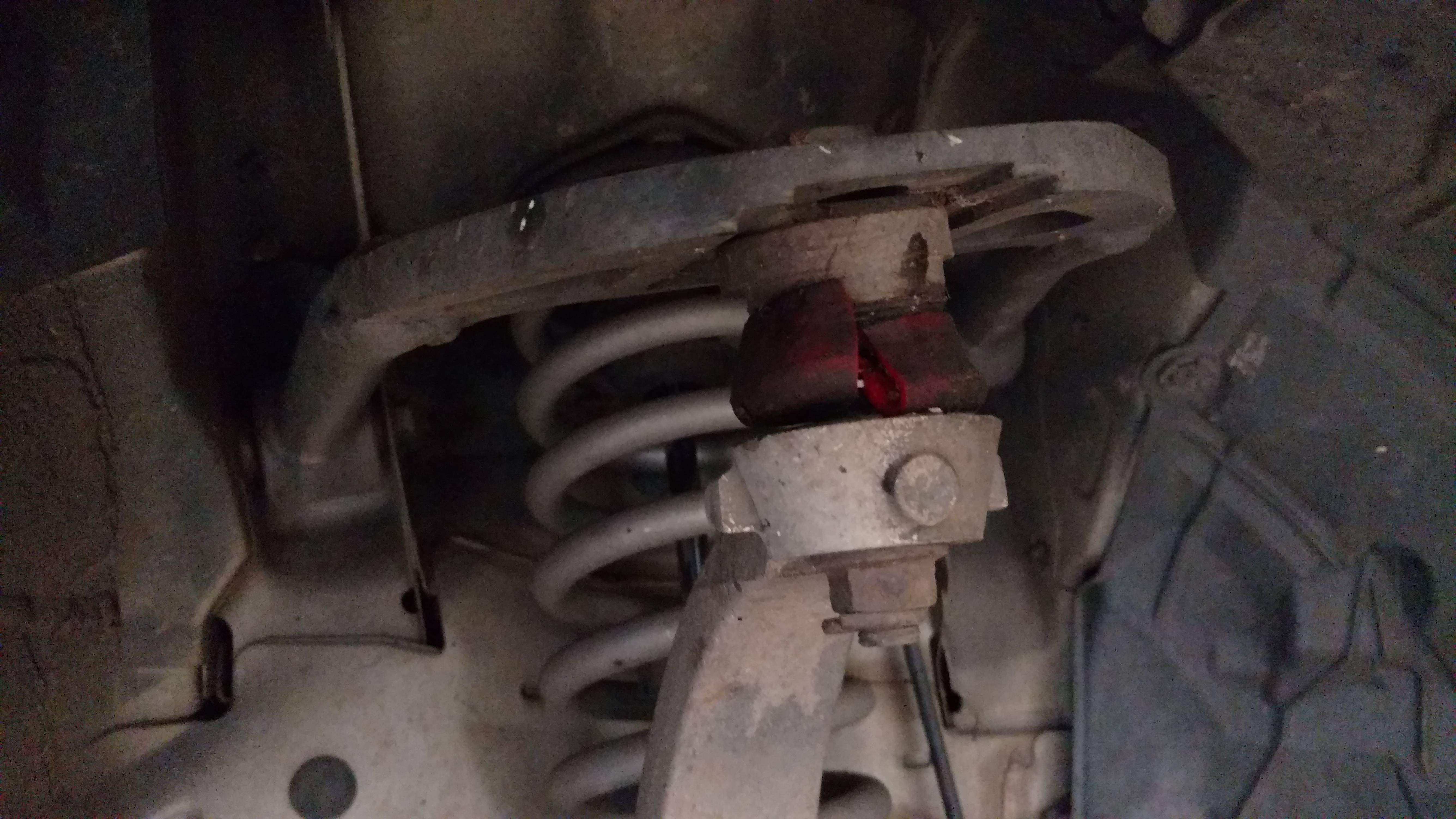

The rear spring setup confuses me. I feel like I need a more solid adapter between the helper spring and regular spring. I suppose it'll be compress 99.999% of the time, so it won't matter.

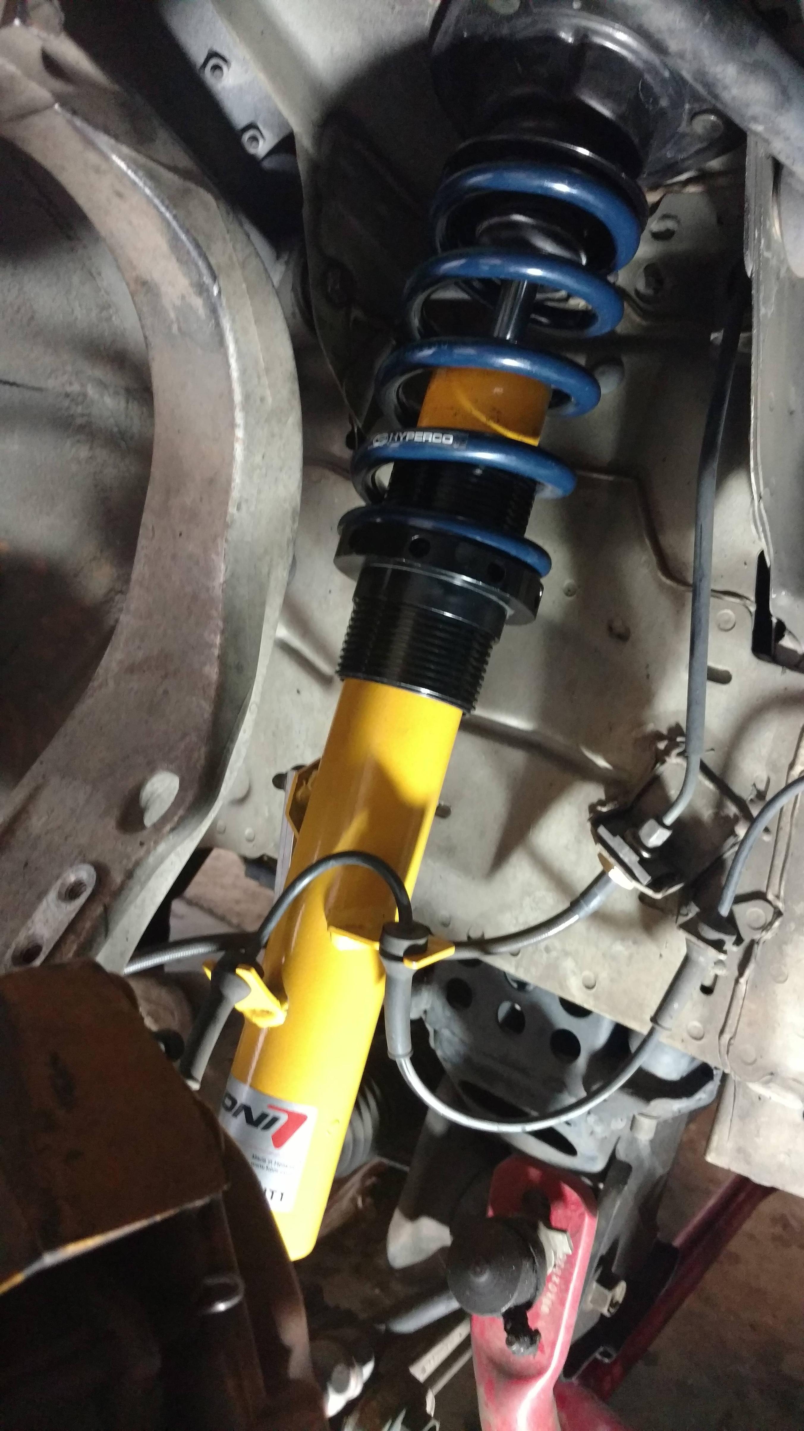

Slammed!
Spent most of yesterday adjusting ride heights. Man, I've been extremely spoiled with the Xidas on my miatas..... threaded shock bodies, torrington bearings, nefty tools to spin the spring seats.
With some advice from Mr. Lane I was able to get the ride heights sorted out. With no scales available I measured from the ground to the fender to get the car "in the ball-park". Started pretty low, 25"-ish front and the rear was ~ 24 1/2". Raised the rear an inch and the front about 1/4". Talked to Mike some more, yup too low for my rates (550f/450r). Raised everything up about 1/4", well I attempted to anyways.
Ended up with:
FL - 25 5/8" / FR - 25 5/8"
RL - 25 5/8" / RR - 25 7/8"
I can't get the rear-left any higher..... I'm nearly out of threads. Most of this is guess work since I don't have it on scales. I'll corn balance it this winter when I move up to 1000/700.
I like how it looks though.
