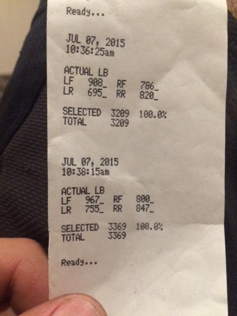

Are you corner weighting your Z with a corresponding weight in the driver's seat? Your cross-weights are quite different than mine.
Also, building a NA VQ race engine is quite expensive and complex. Make that a future project and take your time in researching it. Otherwise, spend your budget on getting an UpRev cable with Osiris and Cipher loaded on it.

800lb cross-weight up front is less than my 2800lb race car....
Not sure I understand... csn you elaborate.

That 786lb RF corner weight is not possible unless there has been an error (on a a hill, etc)...
