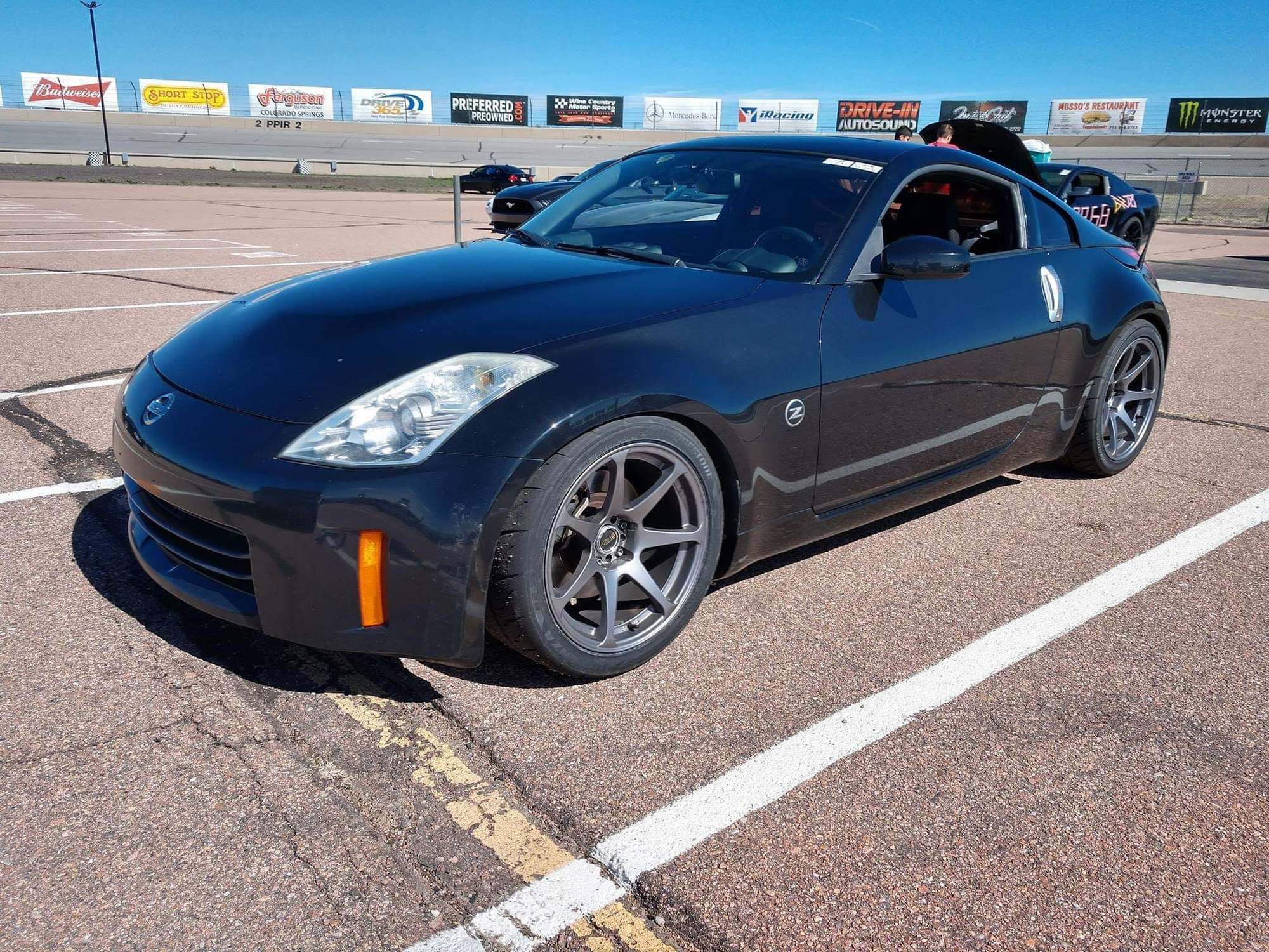

-3.3 camber up front with this drop.
Mb battles (I think)....I ran them, decent looking and cheap

Correct. MB Battles. I am running 18 x 9.5 all around. Approximately 22lbs each which isn't bad.
I get plenty of caster angle with this drop, around 9 deg. I've had these camber arms for around 6 years now and greased them every two years. No noise at all. Although it's not a daily, but I do drive it to and from the track.
