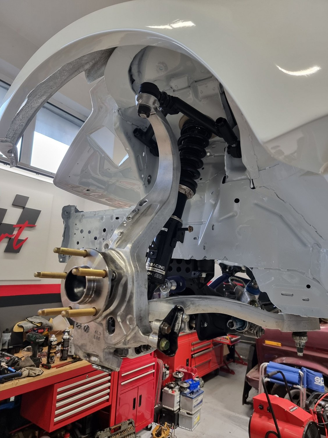

Small update on the build.

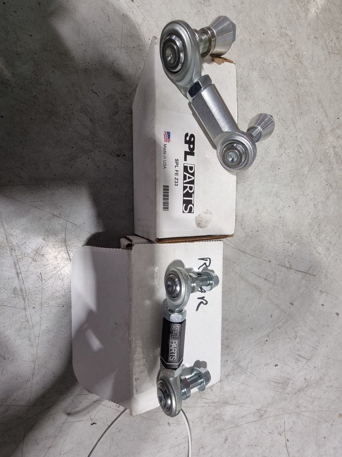

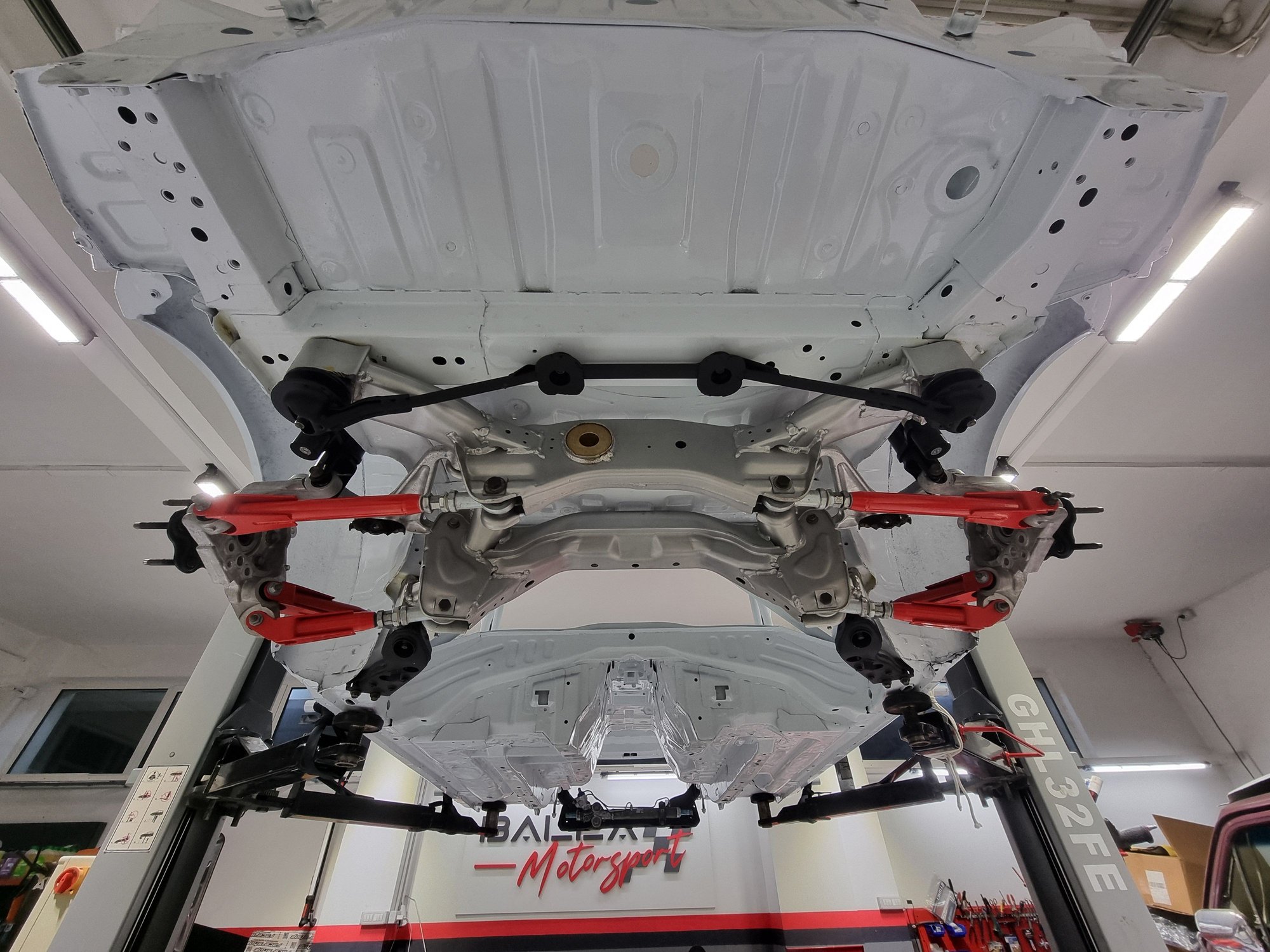

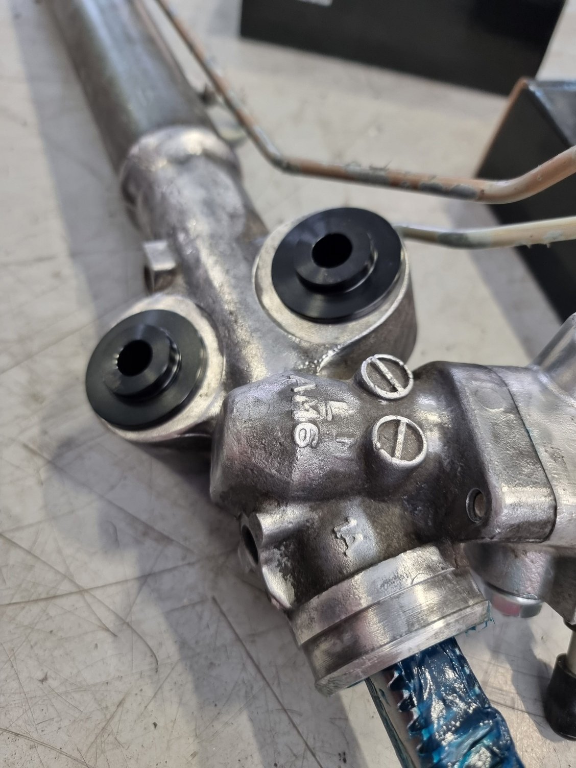

Most of the rear parts are mounted, and not so many parts on the front because some bolts and the rubber boots for the steering rods did not come on time.

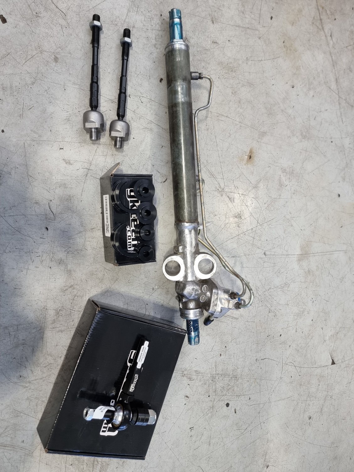

The steering rack was sent to a shop that repairs them and they check everything inside and change all the seals so it will work correctly and have no leaks. Also mounted the GK Tech aluminium bushings for it.
​​​​​Cleaning the old parts that I reuse is time consuming but I can't let them rusty and ugly that's for sure.
Taking a break this weekend but Monday back to work on the Z.

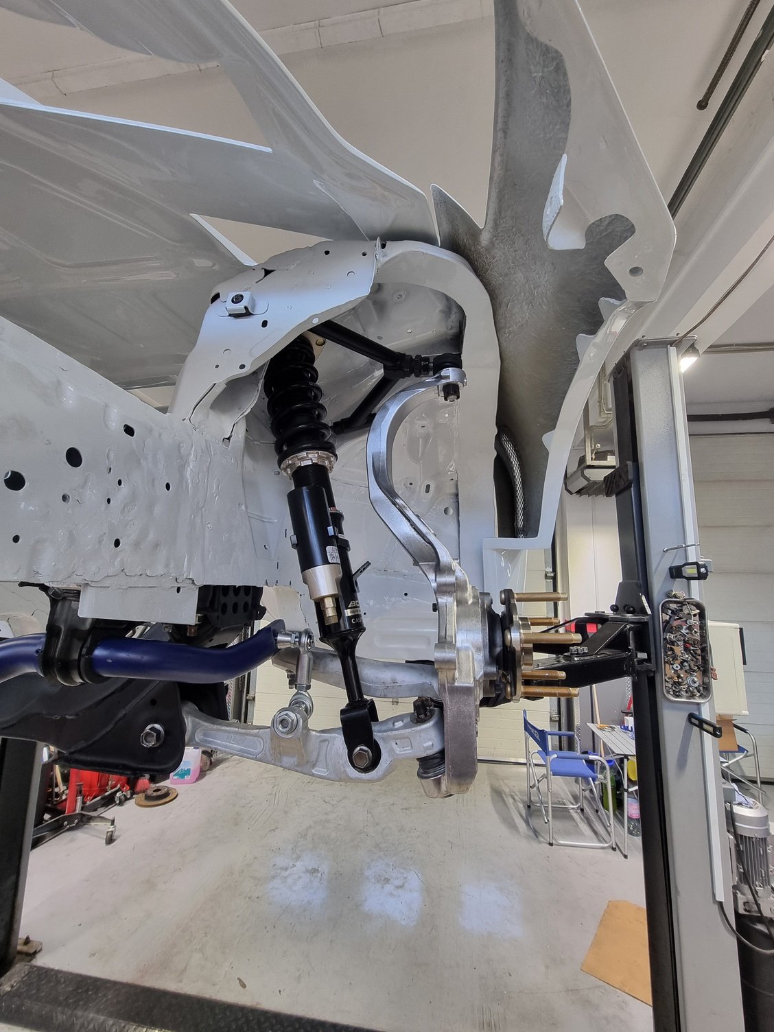

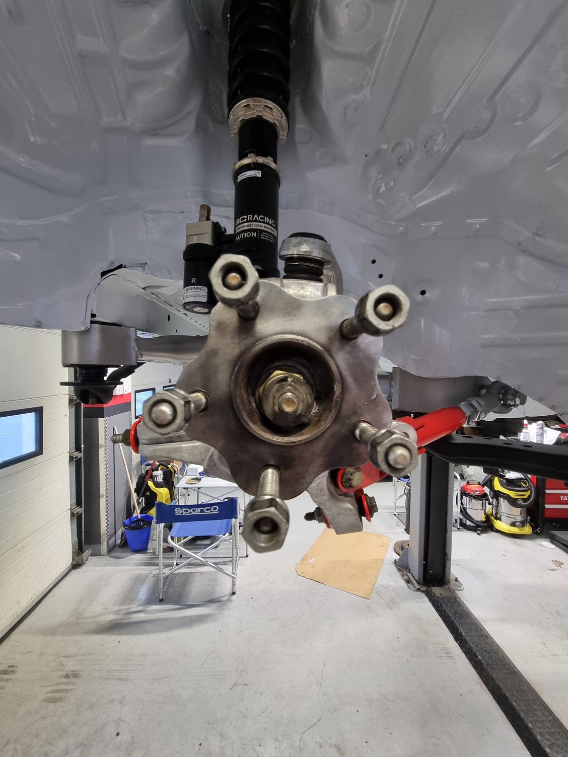

Back to work on the Z.
The front and rear arms and links are 95% done and torque to spec.
I want to point out that for the rear bearings I put a screw and washers to simulate the drive shaft since the rear diff and axles are not finished and I want to put the chassi on the wheels and without tightening the bearings they will get damaged because of the weight. Did not tighten to spec but good and tight.
Tomorrow I want to finish the steering rack so the car can stand on its wheels and steer.

What I checked at GKTech, their front kits are for drifting, and the rear kits except for the arms the rest are also for drift applications.
In my build the car has full pillow ball spherical bearings front and rear and replaced all the arms that I can find so I can make the settings for the suspension.
The only part that did not arrive and I will replace when it gets delivered is the Rear upper camber arms.

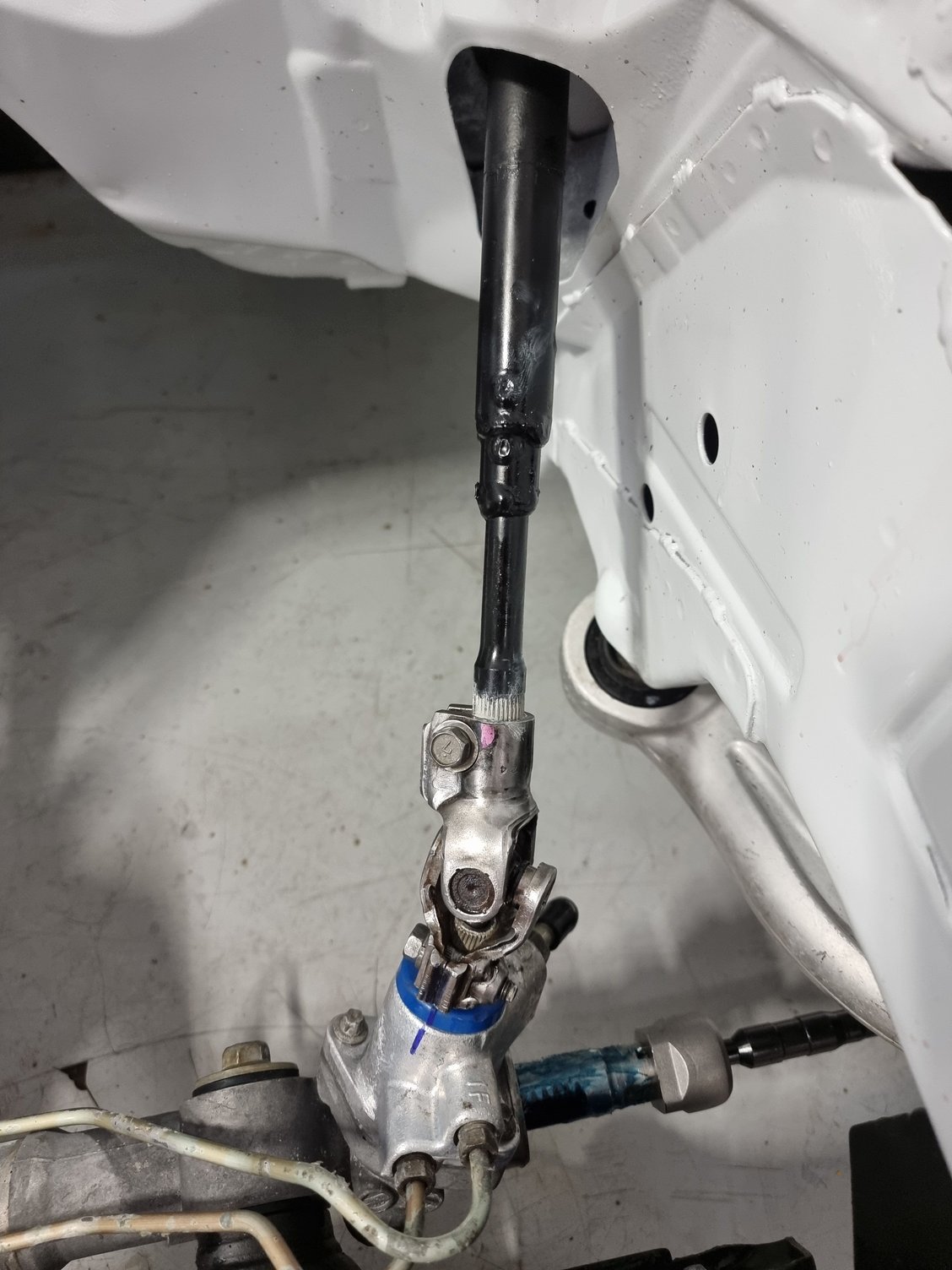

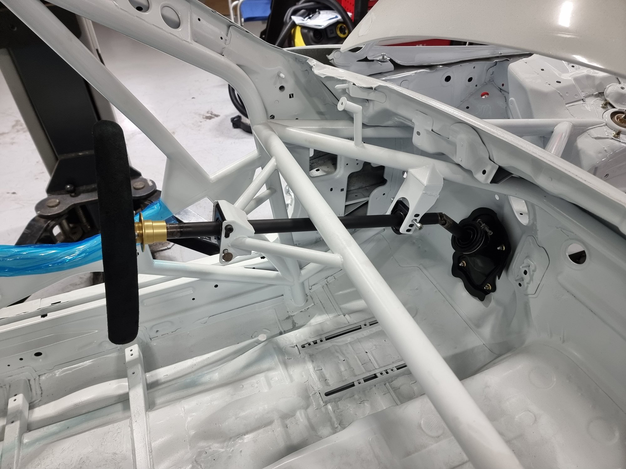

Today I wanted to finish with the steering rack but had to stop until tomorrow because i need to make a custom bushing so I can fit the rood with splines from the stock rack to my steering tube there is a difference in diameters and the only way to mount it center and perfect before welding is to make a custom bushing.
And the stock boot to fit I had to enlarge the hole a little bit and it fits nicely.

Today I finished the steering rack, welded the splinted rod from the stock one and torque the bolts. The weld is not very nice looking but is a deep weld all around and also I drilled 3 holes in the tube to have an extra safety weld. The holes are drilled in the tube rack not in the piece that slides inside.
Also mounted the steering rods and put some wheels so I can move the car around.
Until the other parts and new bolts arrive I will stop here with the chassi and start assembling the engine.

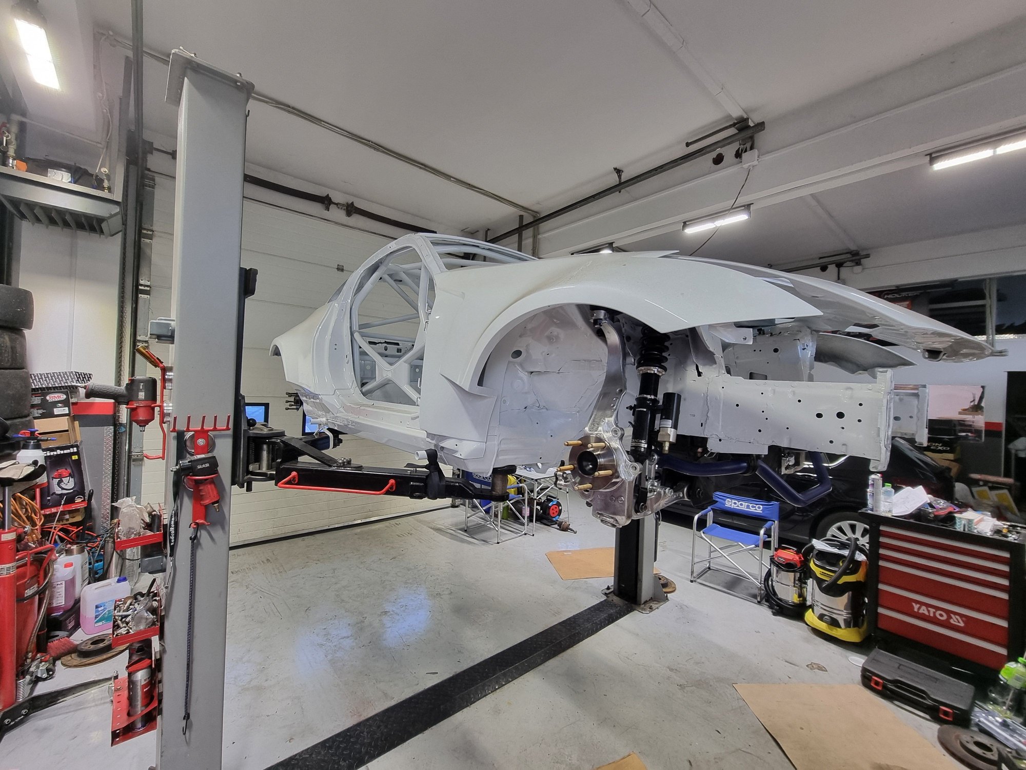

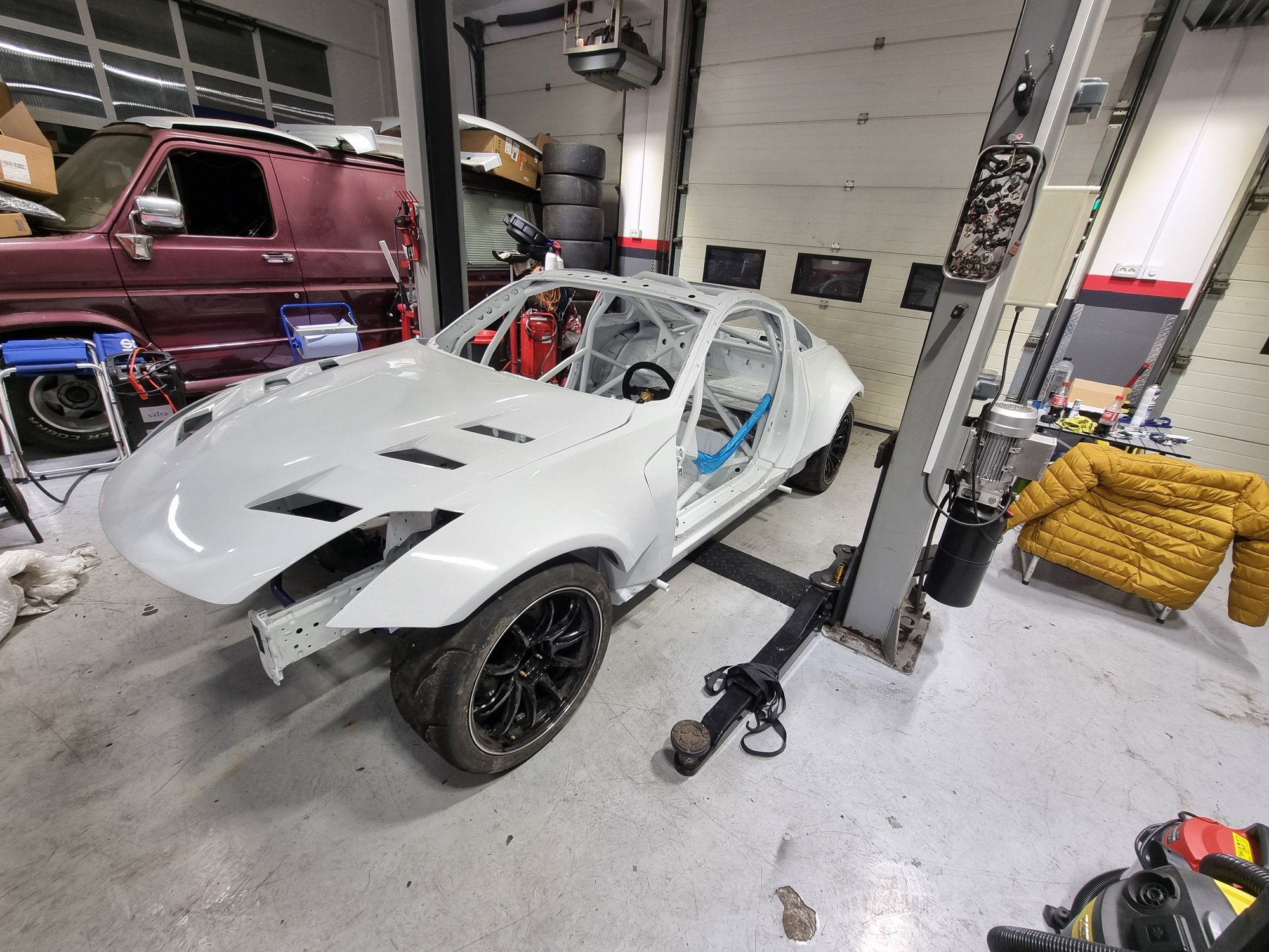

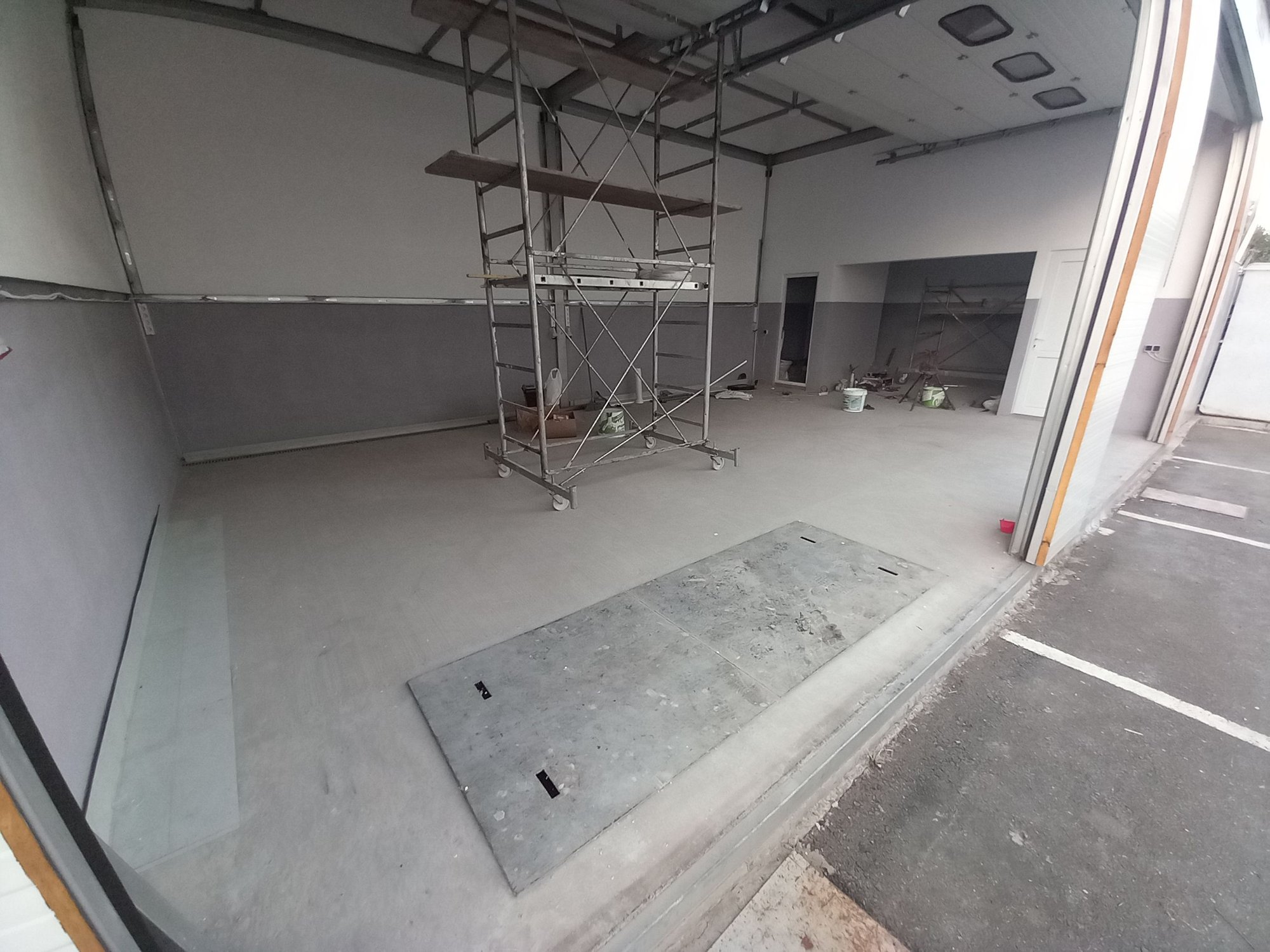

I have not posted because the 350Z was sitting in the shop. This year was very bussy!!! Building another shop because we have no more space, Building and fixing customers cars and of course our own projects and also finding time for Racing with the Dacia Logan.
I want this winter to start working again on the Z because I really want to race the car in 2026
Here are some pictures with the work from 2025

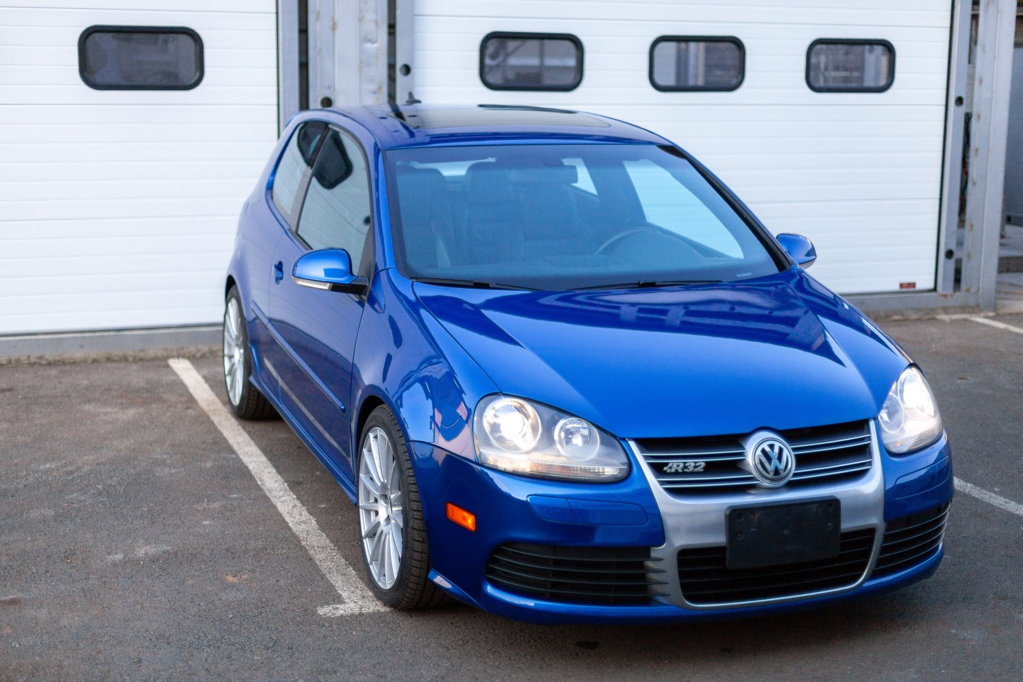

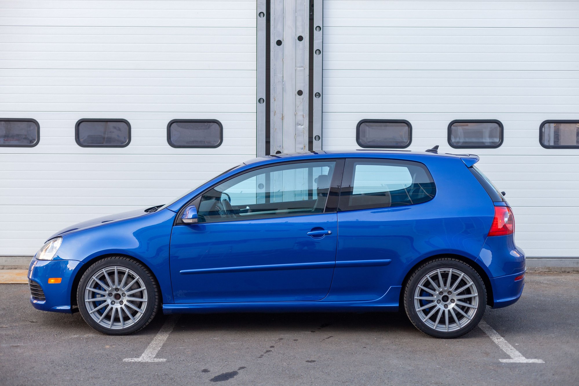

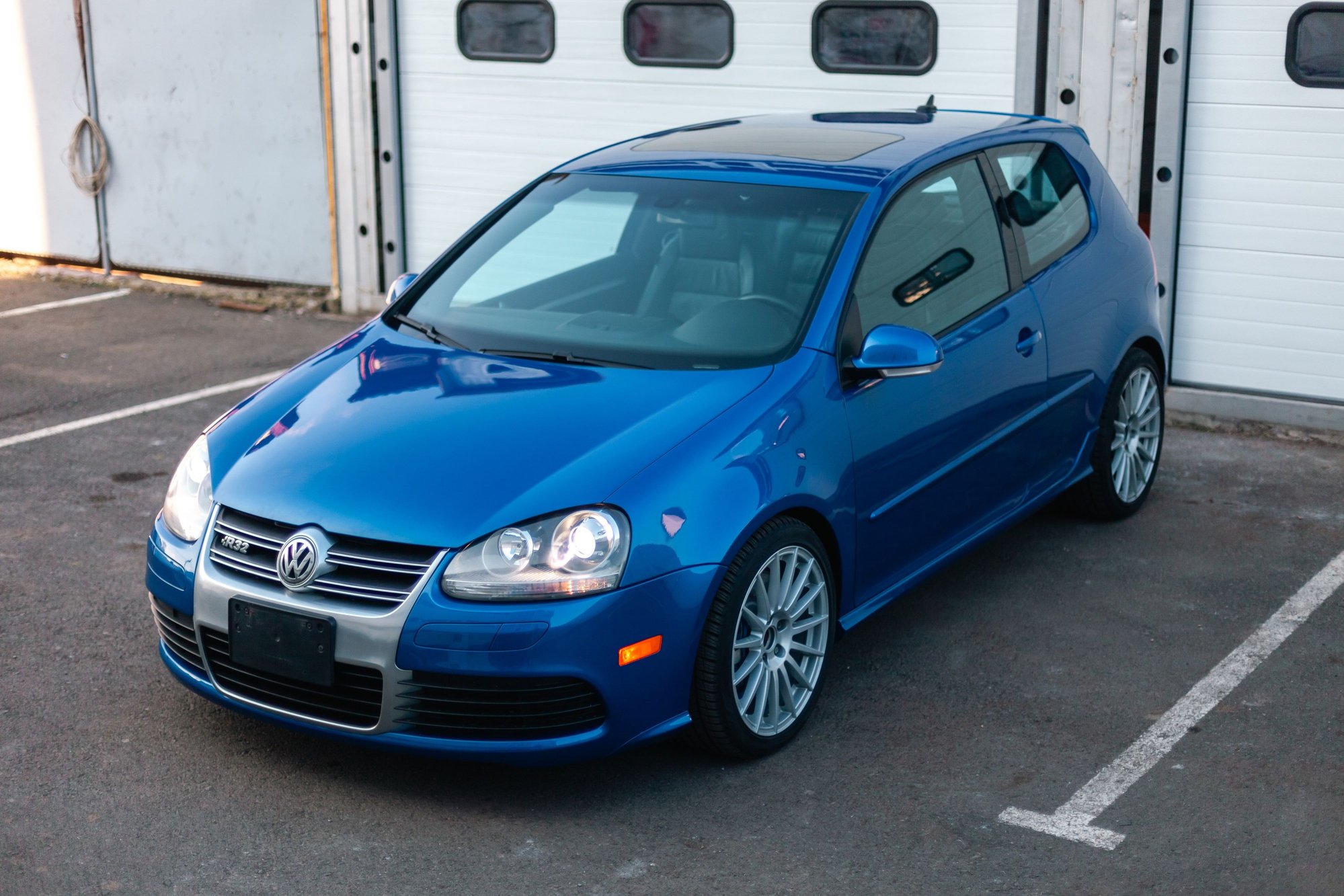

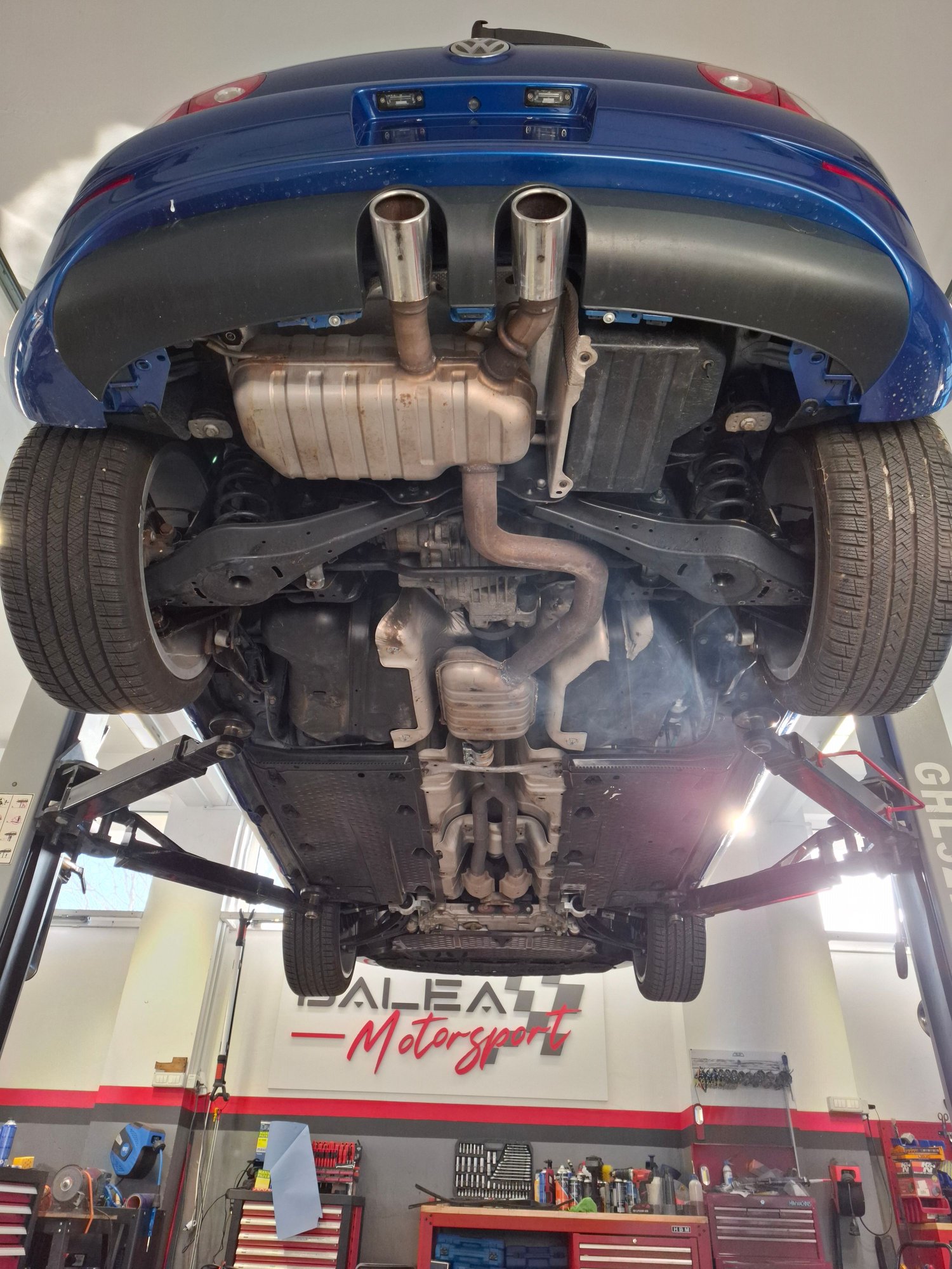

I know is off post but If somebody is interested or has a friend that might be interested.
Because we need money for race parts and other great builds it is time to sell our USA spec VW R32 Limited edition only 5000 units made, It is number 3871.
The car is like NEW, everything has been replaced with original VW parts.
- It has 75745 Miles
- Complete front suspension and steering
- Complete rear suspension
- Complete braking system
- Complete engine, gearbox, rear differential and Haldex revision.
Price 17000Euro or 19800 $
