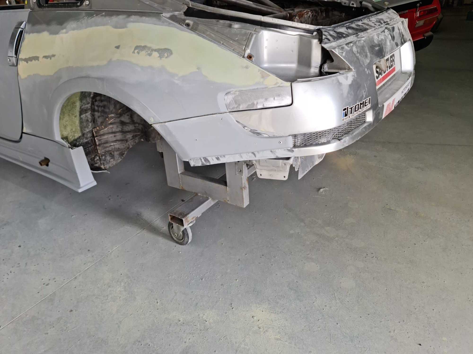

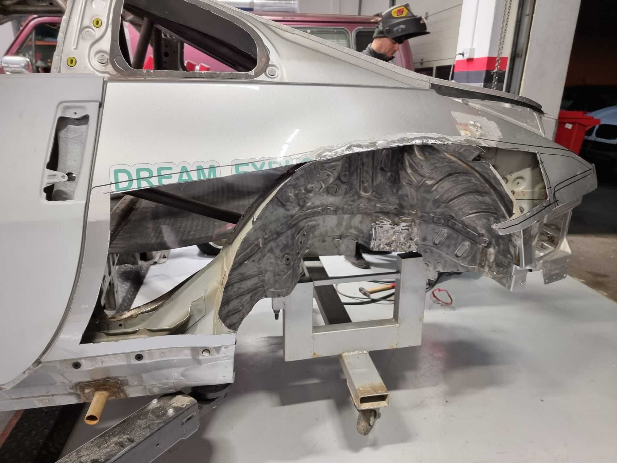

Finishing the body work, made some space for the wheels and room for the coilovers because it was a very tight fit..... and in the process 8.3kg of metal is gone
I wanted to do more cutting on the rear fenders but the fiber glass extensions for the rear are just half on the rear wings and to make other parts it's just not time.....

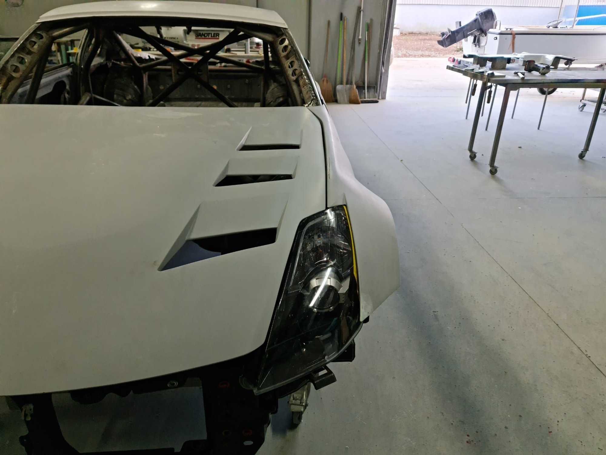

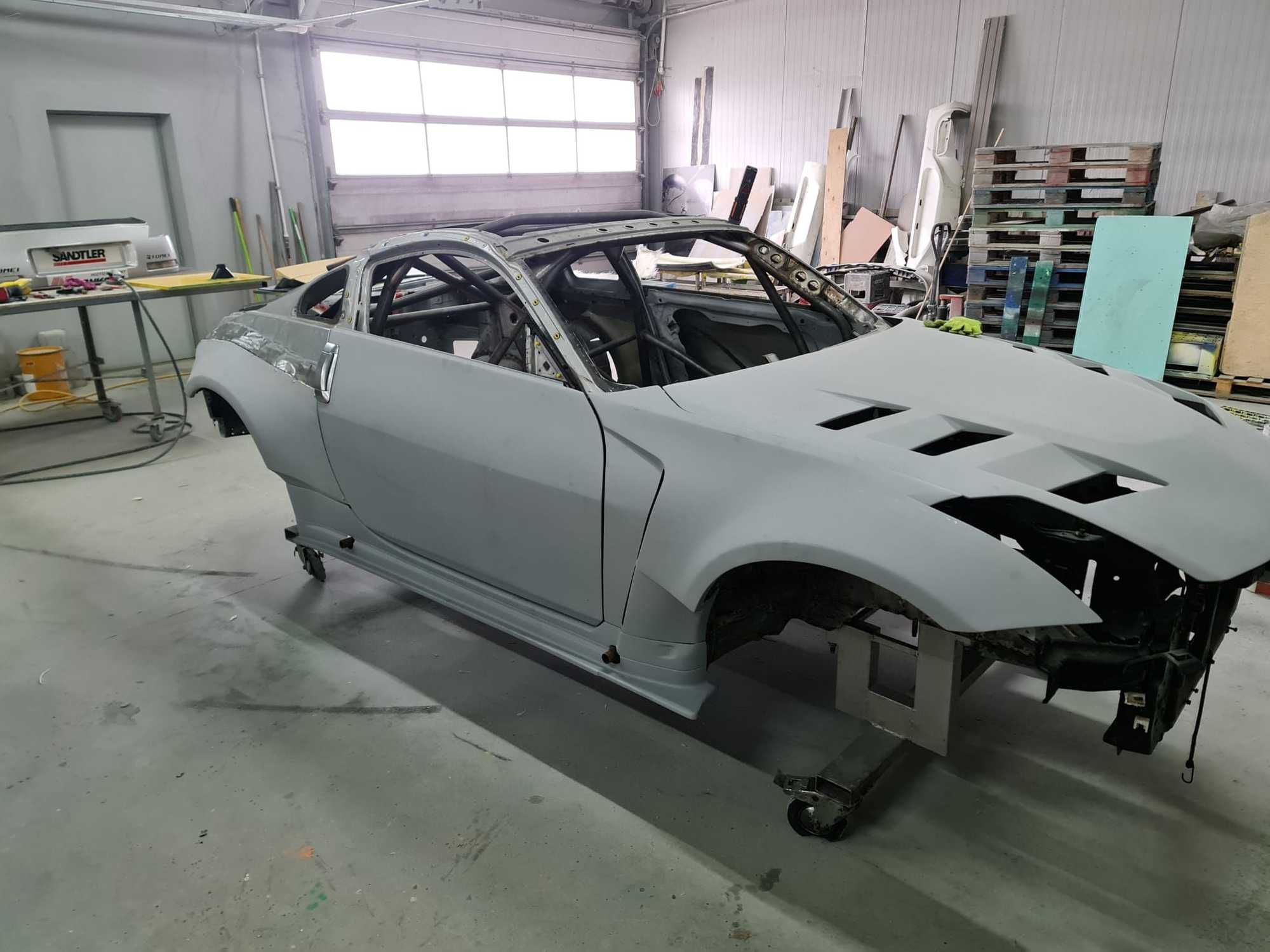

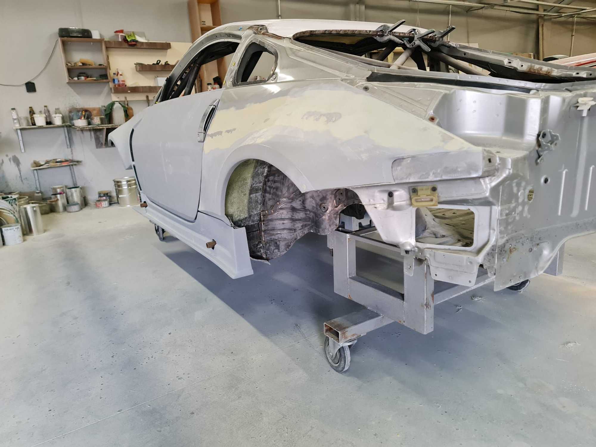

Finally after some days of cutting, grinding, welding...loaded the chassi, the fiberglass parts and went to a man who works with composite parts because the parts don't fit 100% and it just doesn't work like this....I know is a race car but it has to be done right

It's frustrating because this stage is time consuming but has to be done and finished with cutting,welding and grinding because after this the chassi goes straight to paint and if I miss something now.....I will f*** the paint....

Body parts almost done next week should be finished and straight to paint

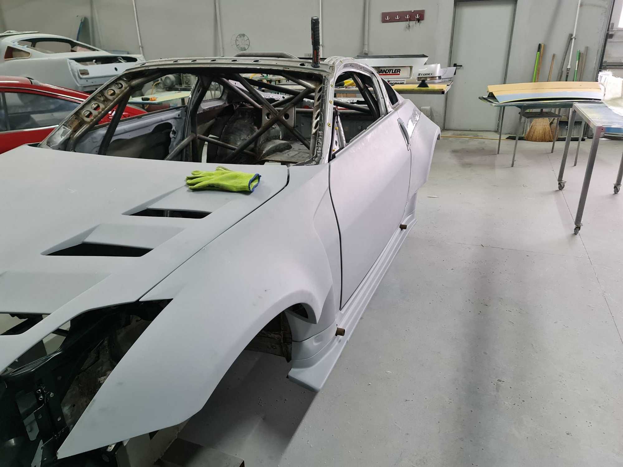

Small modifications needed to the doors but they fit

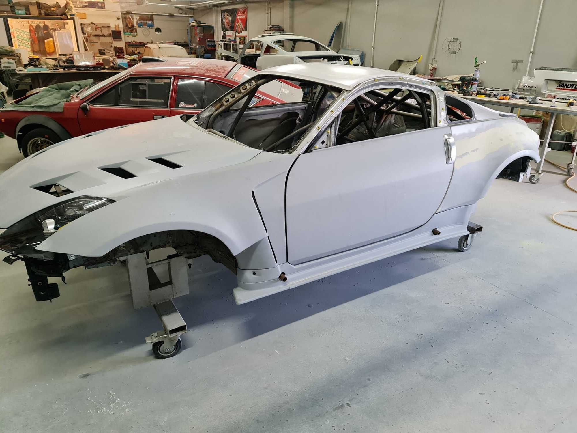

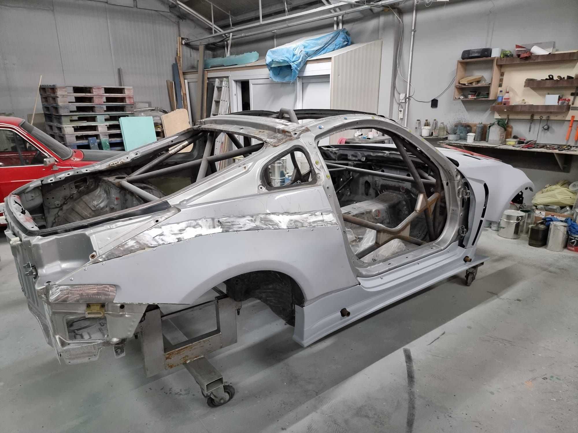

The chassi is also finished ,some modifications were needed but now it fits
The guy was able to use the metal sheet from the roof to make a copy from fiberglass
Now that it is finished I send it to paint

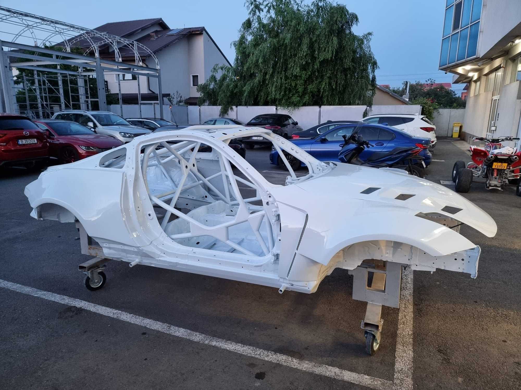

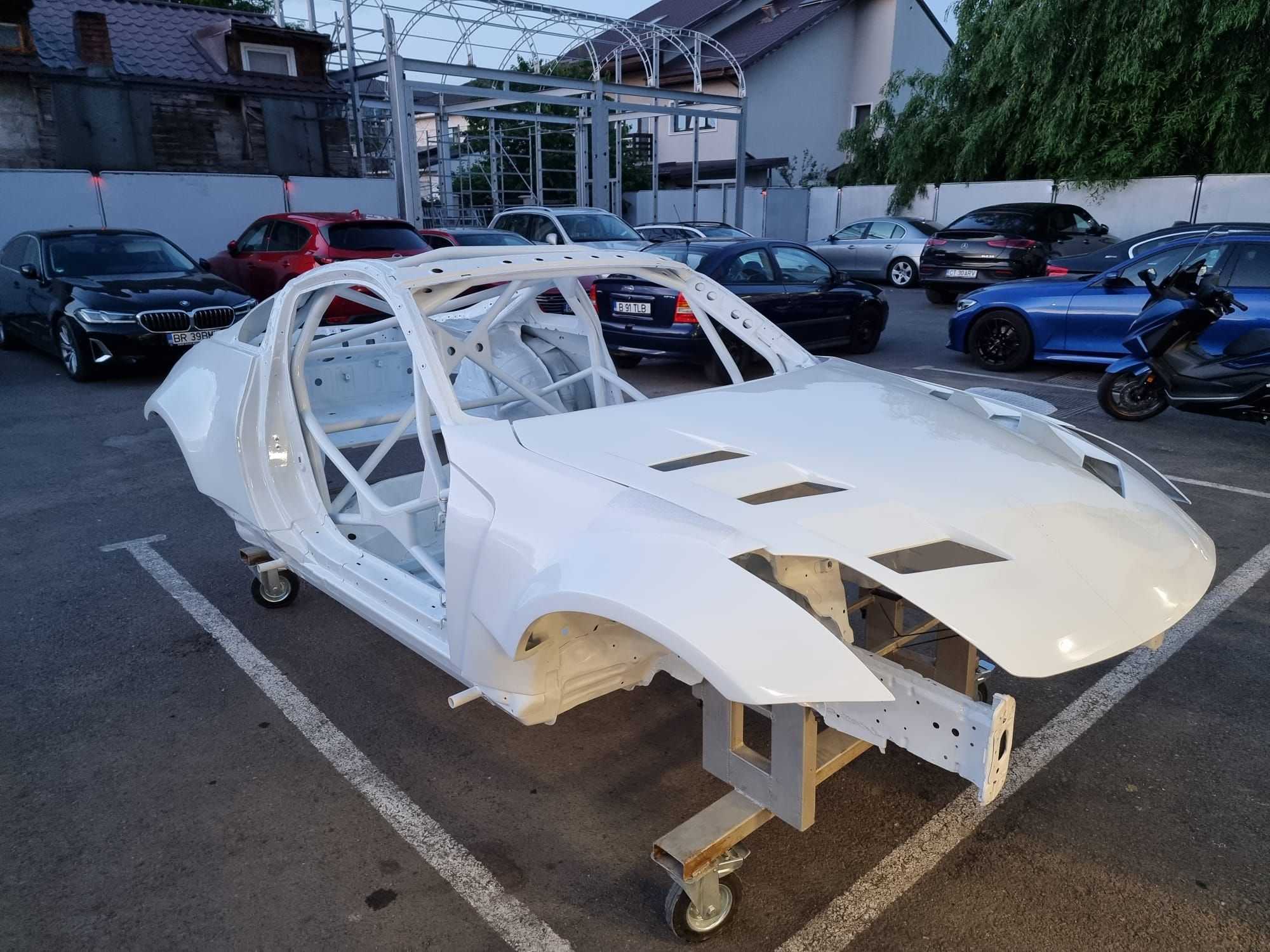

Old Jun 11, 2023 | 12:03 PM
  #160
Balea18's Avatar
Balea18
Joined: Jul 2022
Posts: 98
Likes: 139
From: Romania

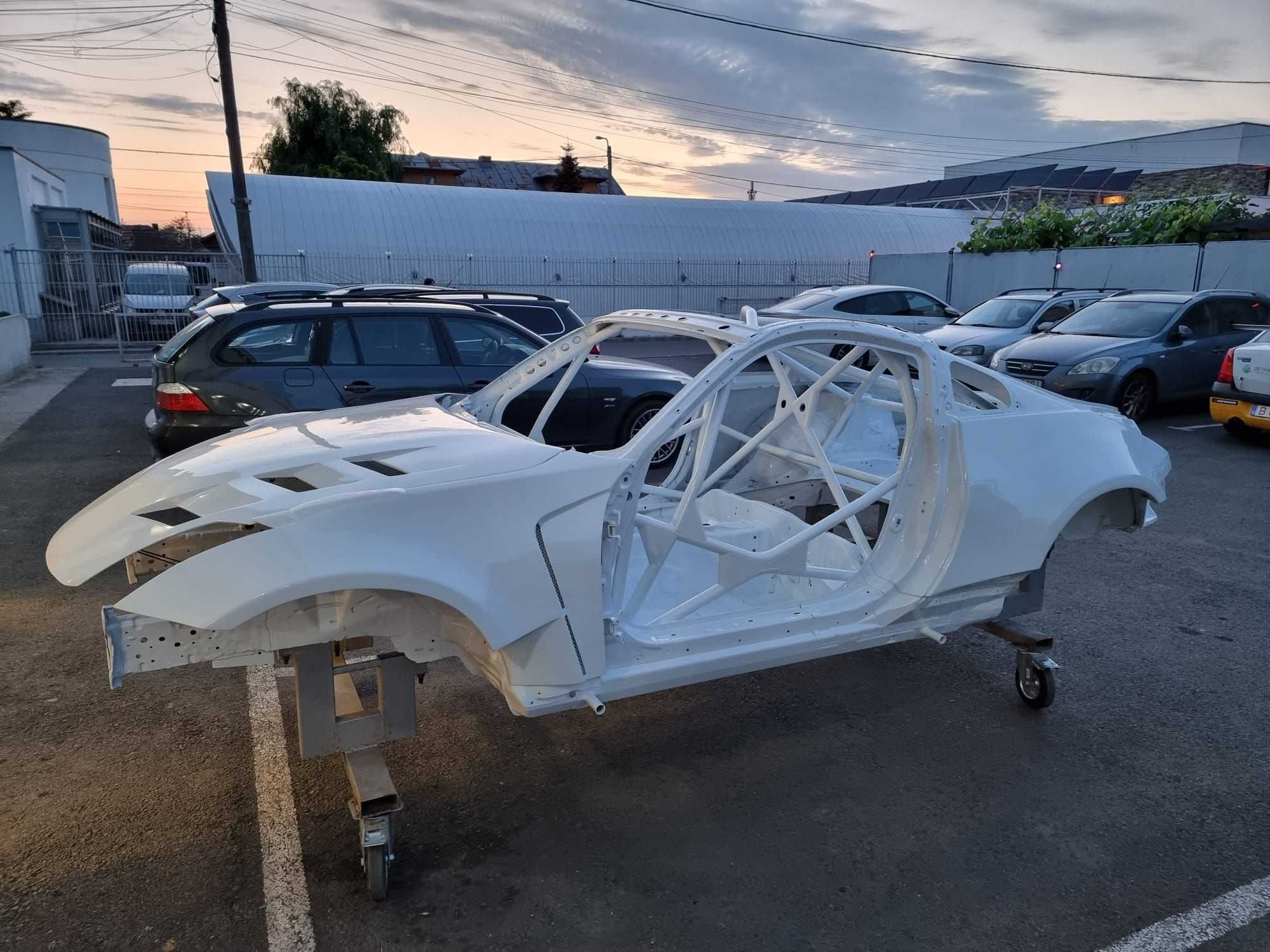

After a long time.....I have a painted chassi to continue this project
