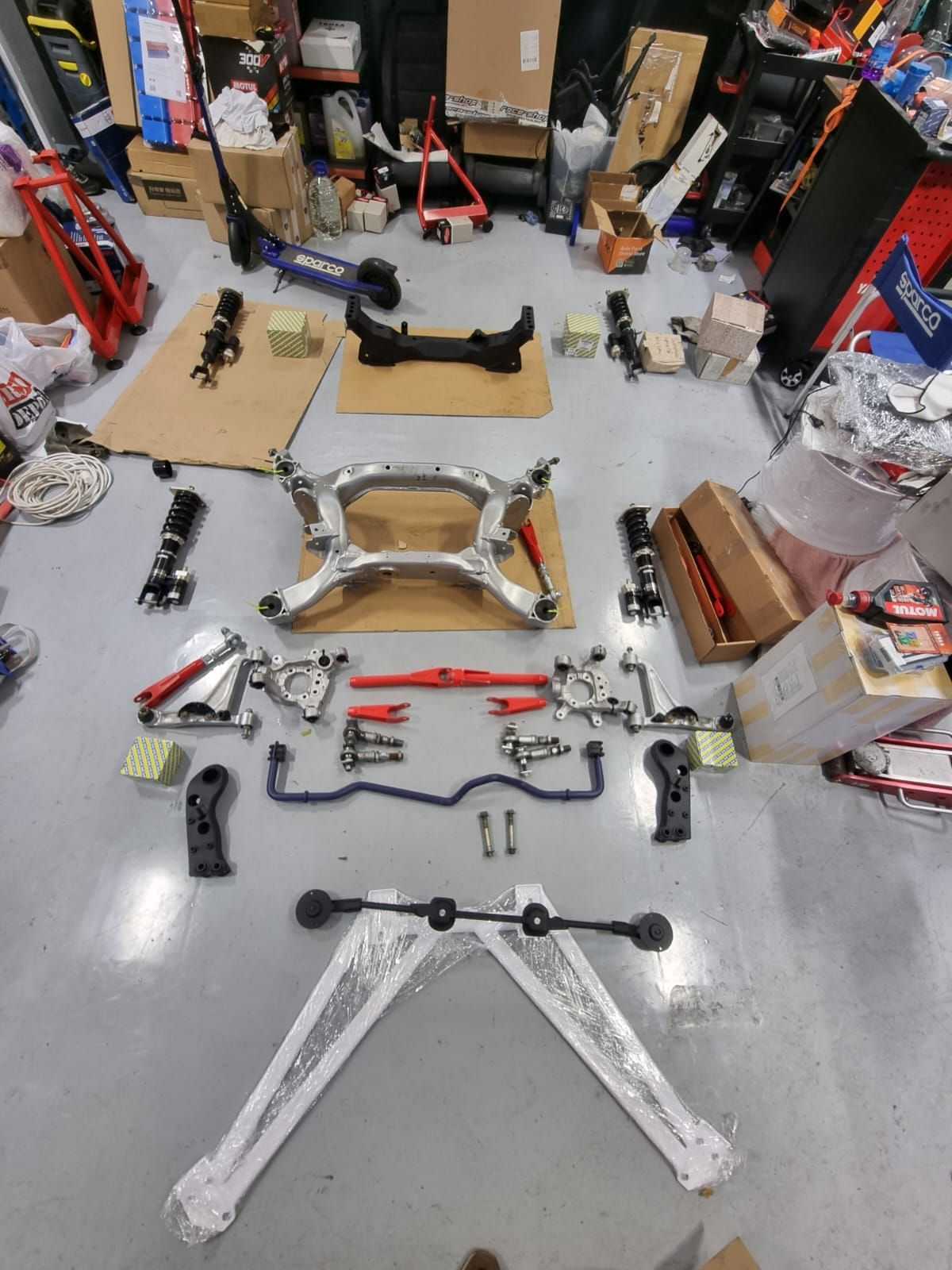

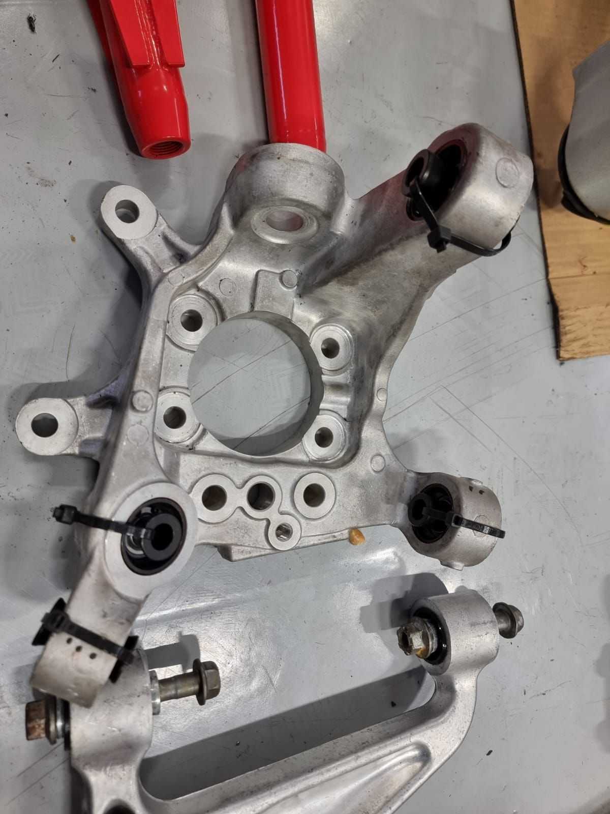

Back to work on the car
Fresh paint on some parts, others needed just a very good clean
New updates soon

Quick, put some spherical bushings on those knuckles before they get away!

Got them in March
90% of the car is going to be with spherical bushings

Those are the ones. Not fun getting the old ones out but worth it.

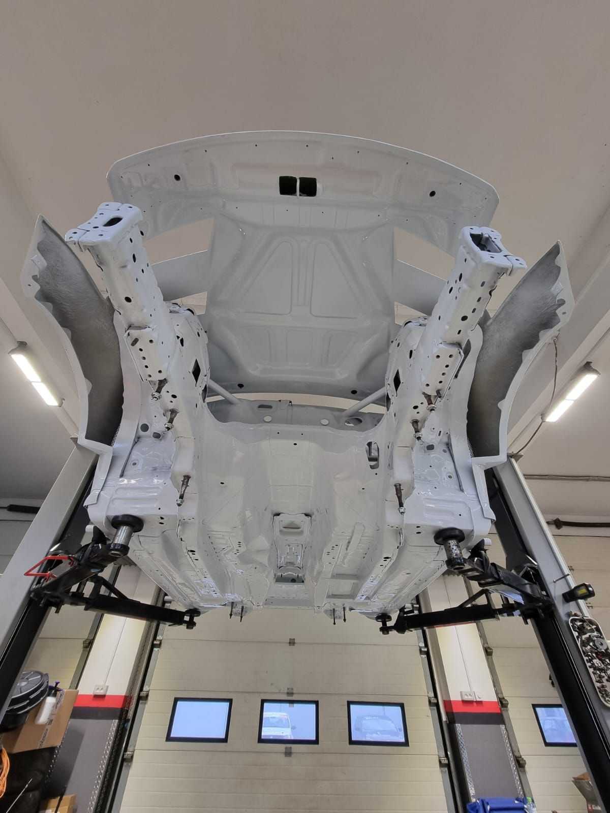

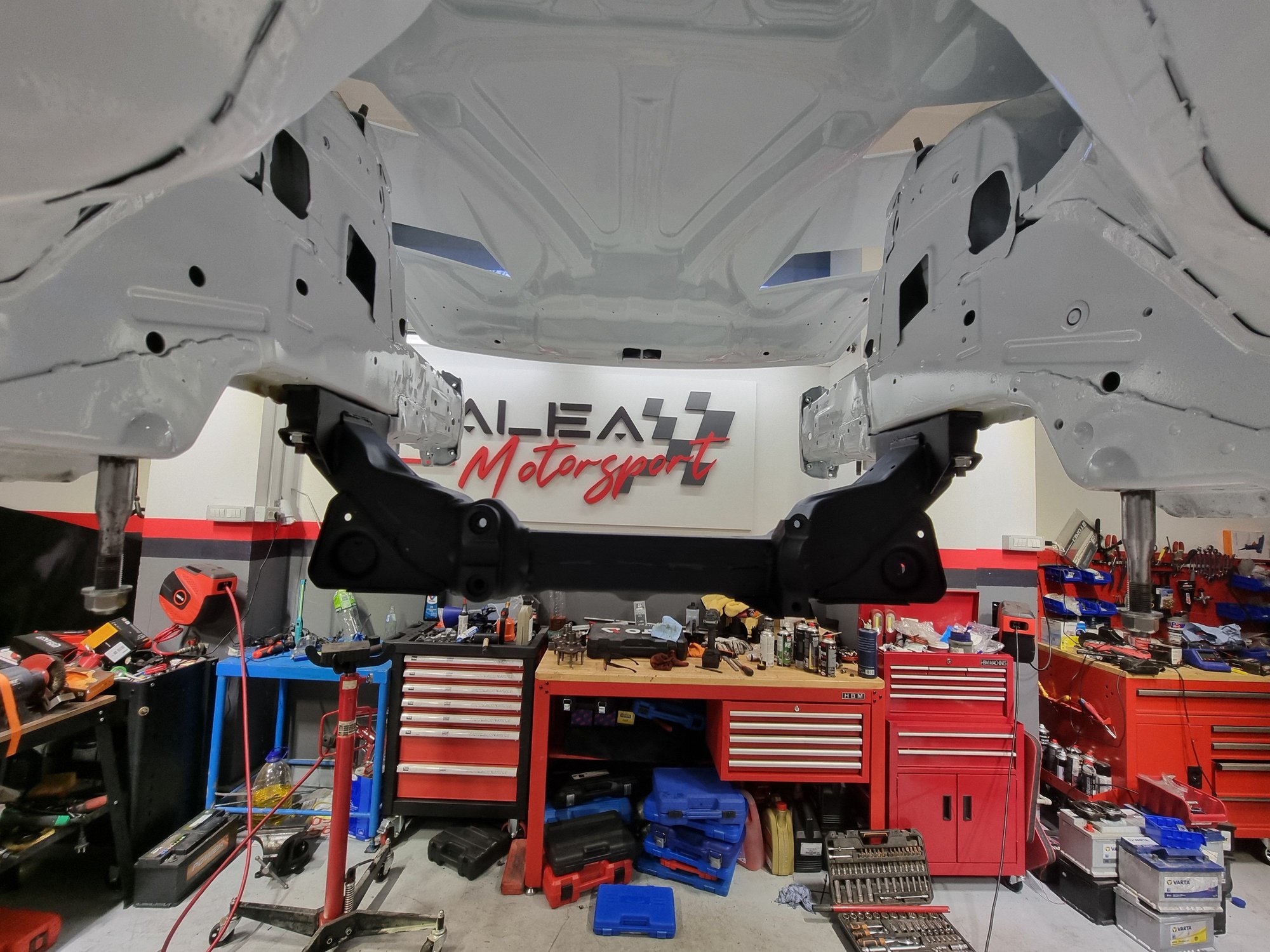

Back to work on the Z
I mounted all the ball joints that I could find to buy, some parts got painted,some parts got cleaned and others brand new .
The target for this week: The chassis has to roll on the wheels.

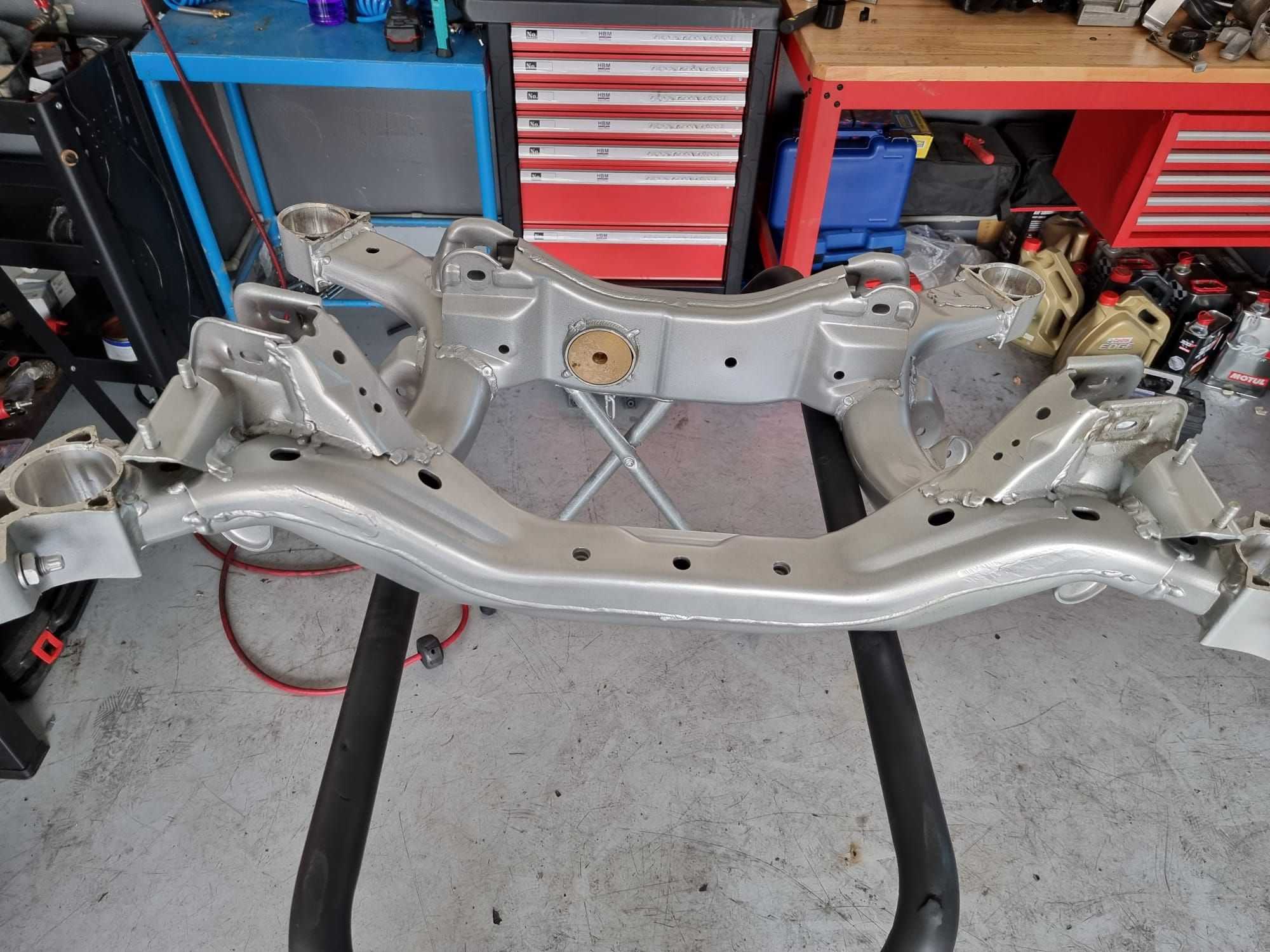

I'm in process of installing solid rear subframe bushings and it's killing me doing it on the car. I'd love to have the subframe out like that and be able to use a press on it instead of puller tools.

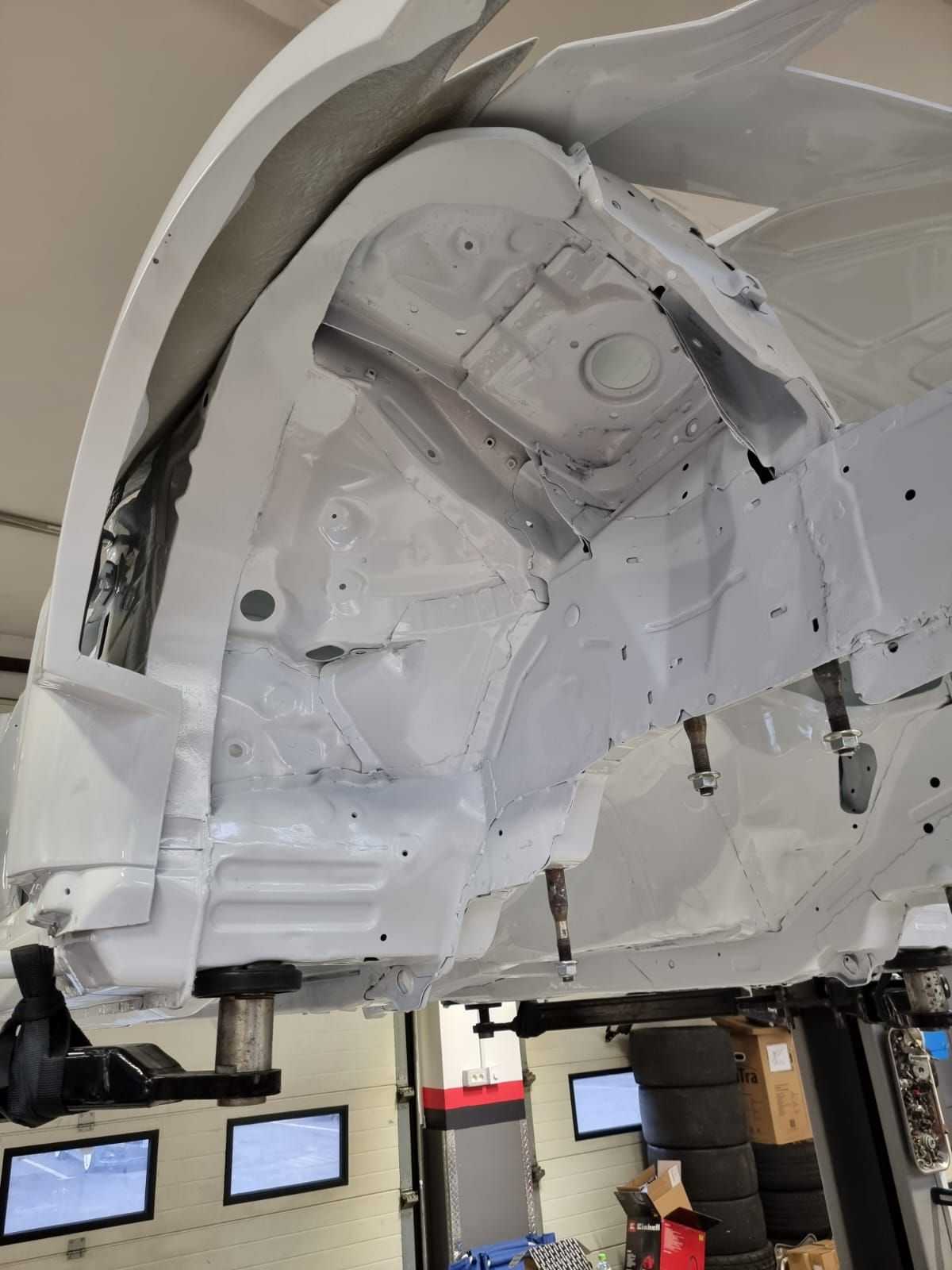

What is the reason for the full floor cutout behind the front seats?
I gave up and dropped my subframe when I did my bushings. Made is a much simpler job. Even on jackstands it was not hard to drop.

That's where all the extra structure that held the speakers and cubbies that is more than made up for with the cage.

I made the cut behind the seats for 2 reasons:
1. For easy access to some bolts on the sub frame and arms
2. For weight ( minus 6kg)
And the opening is going to be closed with carbon fiber.

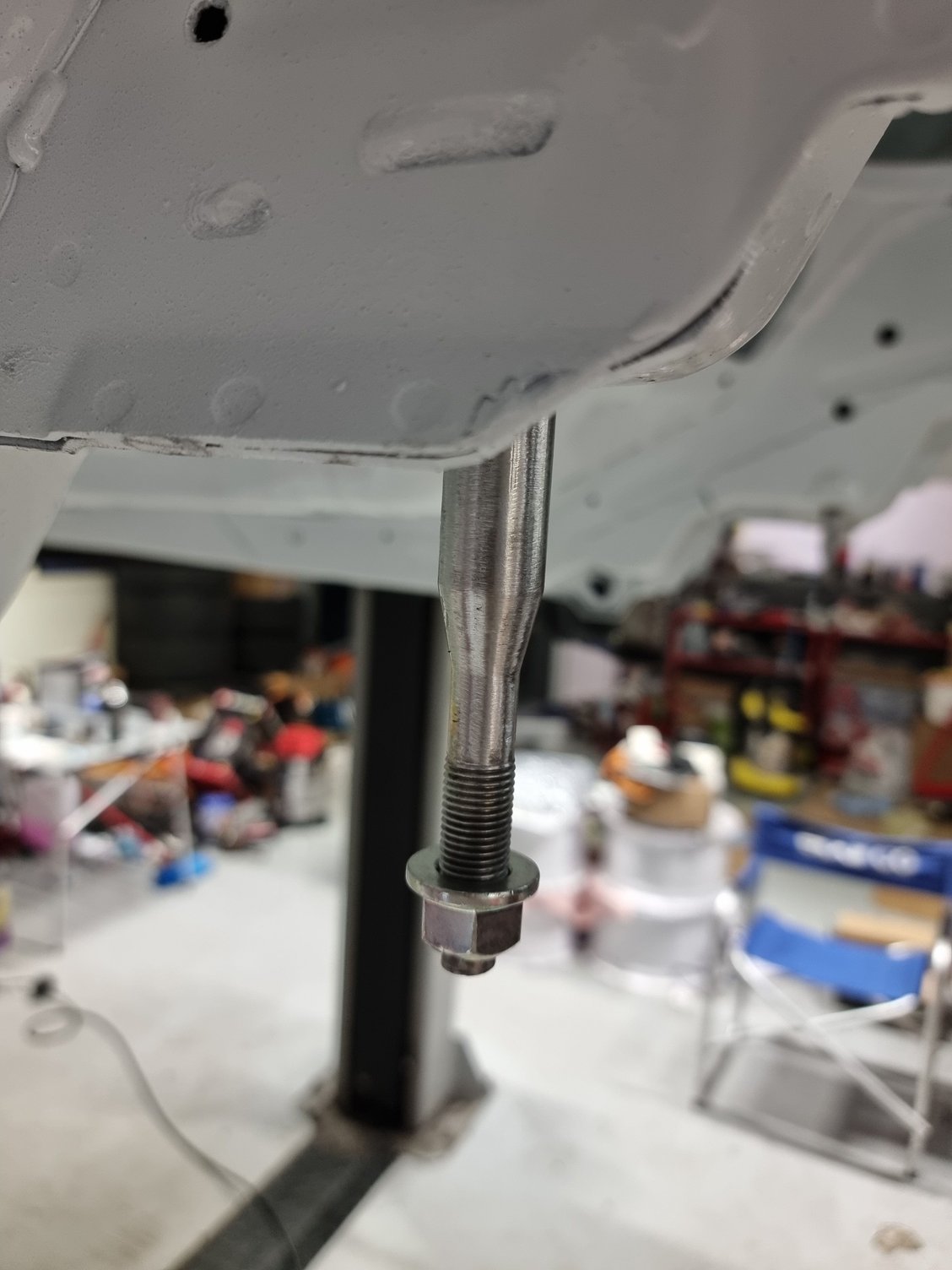

Slowly but surely
Cleaning all the threads and bolts and put anti seize on is taking some time but you do it once )
Tomorrow the rear will be finished and moving to the front
If someone can help me out with the torque for these rear bolts I will be grateful.

4 rear subframe bolts are 87 ft lbs according to the SPL install manual

For the rear Subframe I have, I got the subframe solid bushings from GKTech and came with instructions and Torque specs.
​​I don't have them for the rear arms
