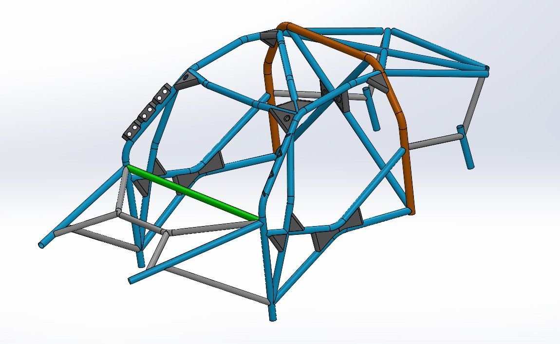

Small Update with the chassi

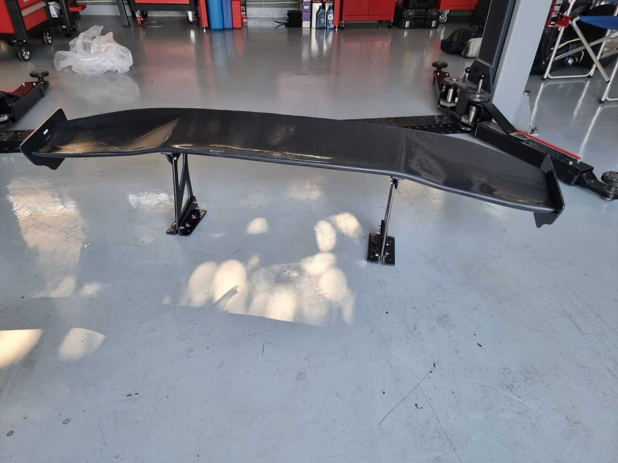

This is the wing it has 175cm -68.8inch

The chassi is 70% done, I hope in one week I can go and take it.
Can't wait to start building this car !!!
